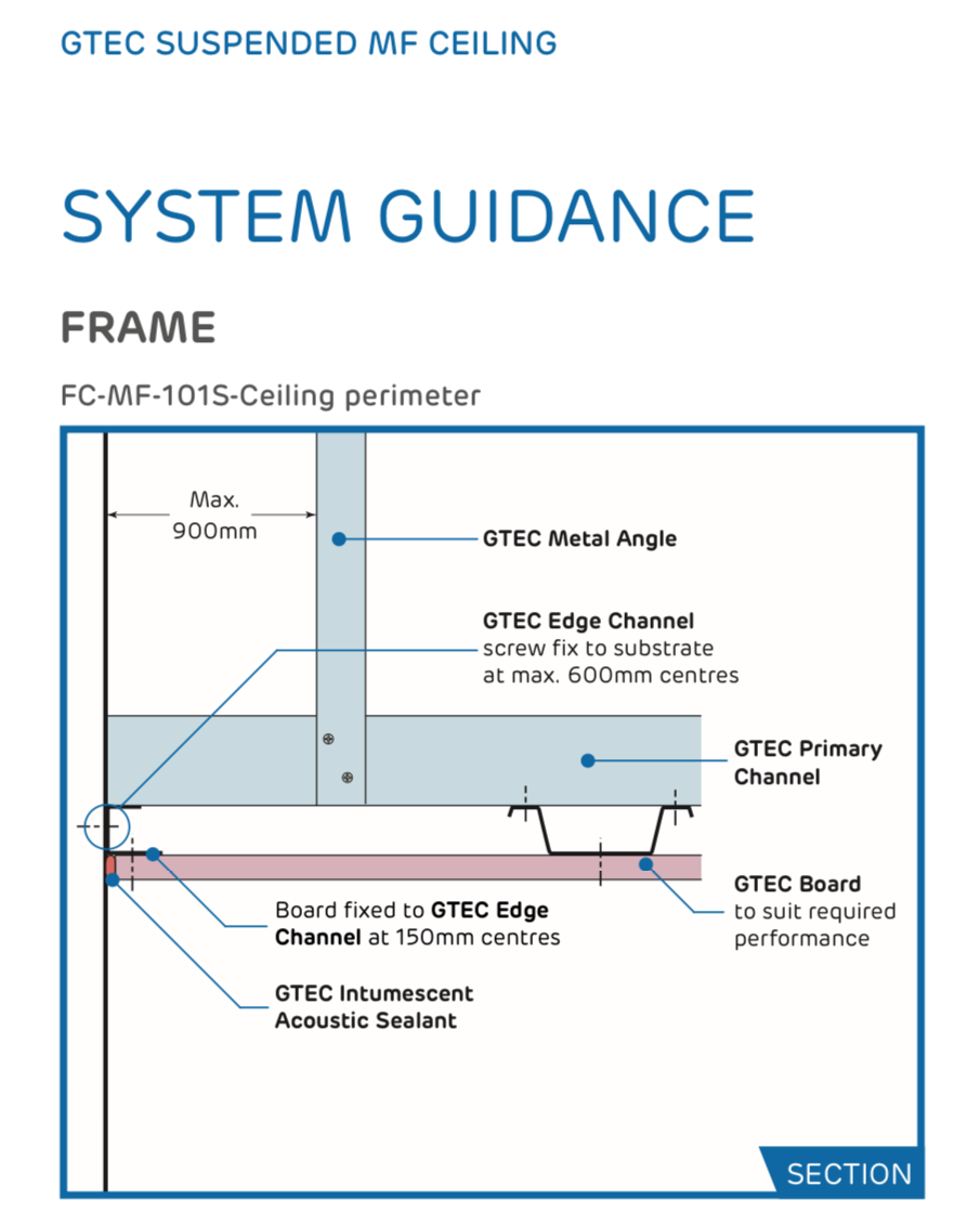

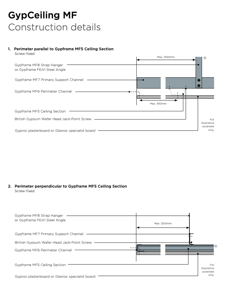

in the whitebook i see these drawings for standard ceilings
which simply show 120mm from each wall for the first hanger. and this video also shows just 1200mm from each wall
but this video says the first fixing must be max 450mm from the wall and then at 1200mm centers.
anyone help clear this up please?

my first hangers were about 300mm ish, as I screwed  to joists which were already spaced, then hangers every 600-800mm, mf7 was again about 600-800mm. Odd spacing every now and then to cater for lighting.  Top hat was then at 400 centres.  Sometimes had to adjust or double up again so lights/mvhr/ac/speakers didnt clash.  A handful of my boards I’ve trimmed down to fit the top hat spacing too.
So 300, and about 600 from the wall.
Having never done or been involved with this kind of kit, does it matter? 🤷‍♂️, as long as there is enough (not too far apart to create sag).I do have a reputation to over engineer stuff.
Though my ceiling system isn’t the same it’s similar . I just chucked one down the centre of the room and then did the required distance from that to the next run . Distance from wall didn’t care ; no sagging etc is all I cared about .

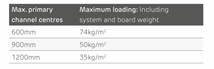

For single board The first hanger can be 800 from the wall if you can get a reasonable fixing in the perimeter track Then you need to make a 1200 grid up with your hangers
D board 600 from the wall and make up an 800 grid

it's a similar story for the distance between each primary in that I don't want to fix too close to the edge of a block and so I'm going to see what distance works best. it'll probably be a bit all over the place but hopefully will be a mixture of either 600mm or 900mm centres if I can make that work and will be more effort having to cut the insulation to size rather than just slotting it in but, like @joe90 says, as long as I don't exceed the maximum centre distance then I can fix as often as I like, right? the more the better for strength it just costs more and takes more time.

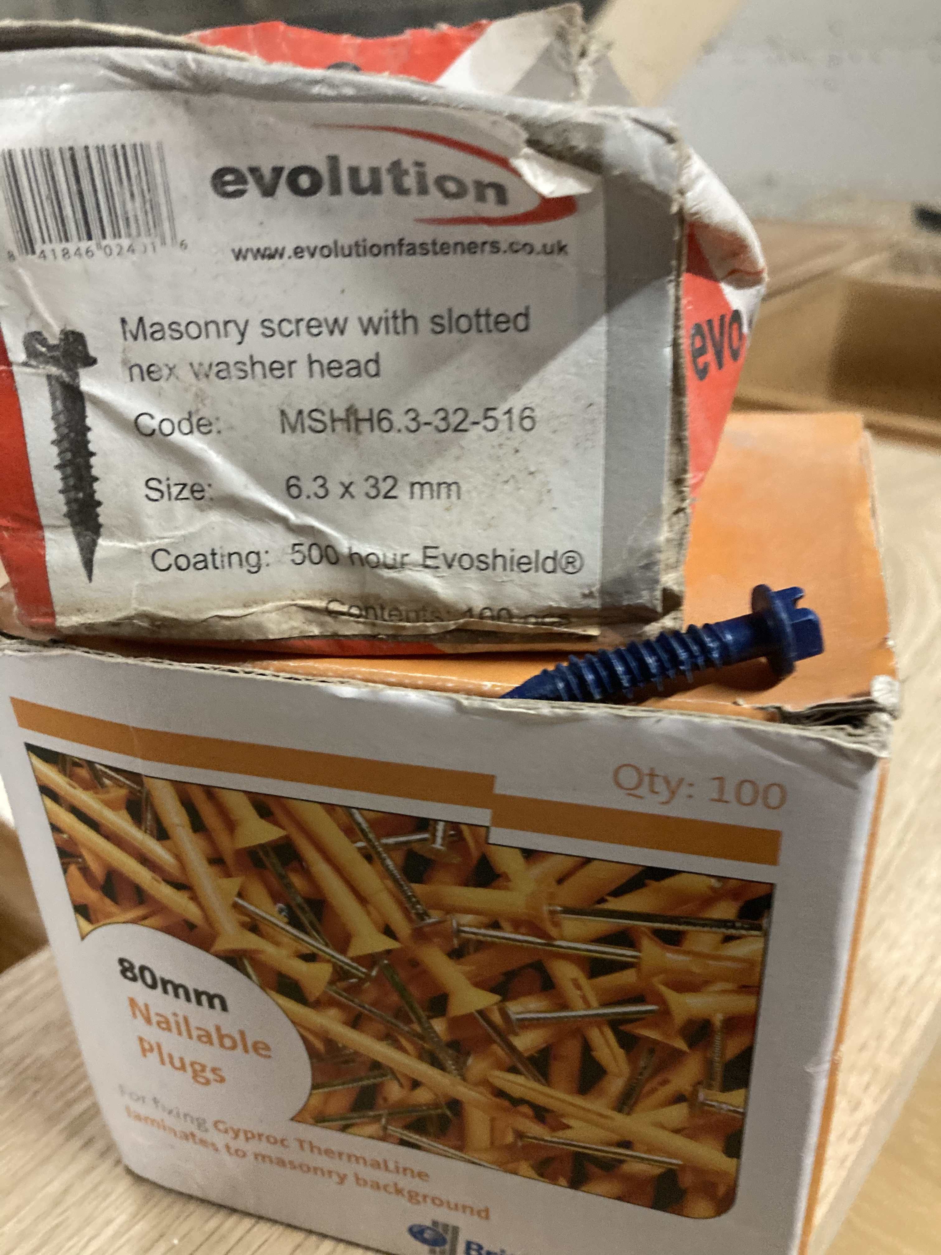

my issue now is I bought these https://www.toolstation.com/dewalt-tapper-pro-blue-hex-head-self-tapping-screws/p86871 as @nod said the blue tex screws are best for fixing the hangers but the box says to use a 4.8mm drill bit! ffs. I have a 5mm drill bit and it's now too late on Christmas Eve to get a 4.8mm bit. if I can't fit the ceiling I'm going to have to spend time with the family over Christmas instead.
Edited by Thorfun
**** it. everything I can find online says for 6.3mm concrete screws to use a 5mm drill bit. I'm sure it'll be fine.

What size drill bit would you use for 6.3mm Tek screws in to concrete blocks? 😊

yes! but what size drill bit do you use for those 6.3 x 32mm blue Tek screws?
the DeWalt ones I bought say 4.8mm drill bit on the box but other makes on the web say 5mm.
It will say on the package and needs to be exactly right.

It really does depend on the surface
Hard concrete can be fine with a 6 But softer surfaces can be 5.5 or even 5
The trick is when you are screwing them in They shouldn’t blast in in one or slow the dril They should just go in steady
I am the same with red rawlplugs 5.5 in softer stuff and 6 in hard stuff. Try 5.5 fir one and see how it goes, if too tight then  use 6mm .
