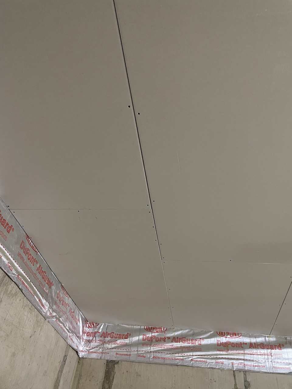

made a start on this. there are, inevitably, gaps between the plasterboards. is there any point filling these with acoustic sealant when the second layer of boards below are going to be staggered? if so do I just squeeze on a bead and press it in with a filler knife? or is there something special that needs to be done.
I’d say no which means everyone else will say yes .
I think you would be the first. I wouldn't.
I was right ffs !
Seriously now, as @Pocster would expect. I asked a Fire Professor how vulnerable the gaps were in single skin boarding, and he said that fire does not get through there, even if unfilled. *
Sound is different, obviously,  but usually less dangerous.
You could even argue that the resulting tiny gap acts as a sound absorbing resonating tube.  Just sheet over it.
At the perimeter though, fill any  gap, as you have both sheets with gaps coinciding.
*There were other reasons, now I think more, but this will justify it if you are questioned.
