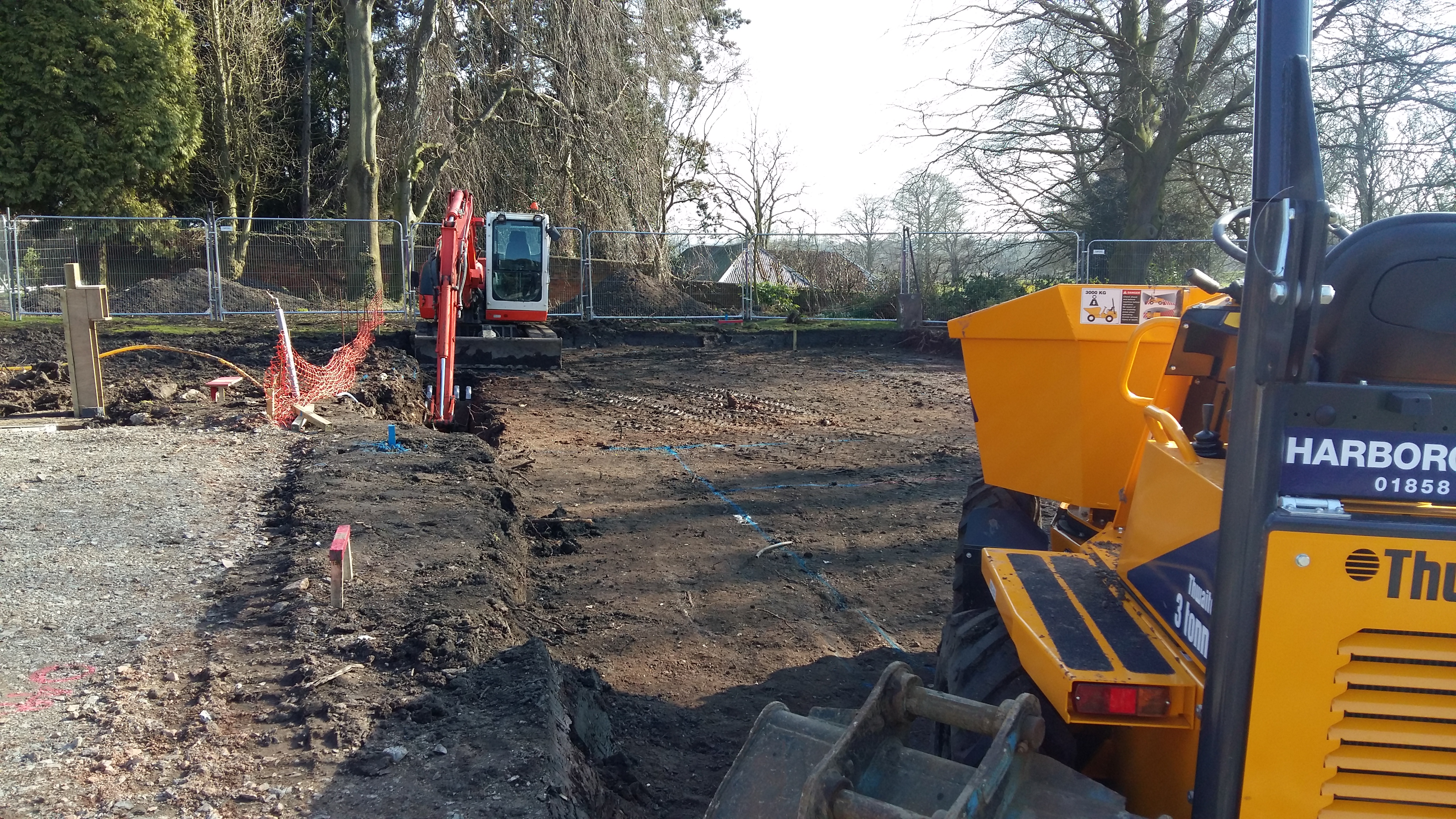

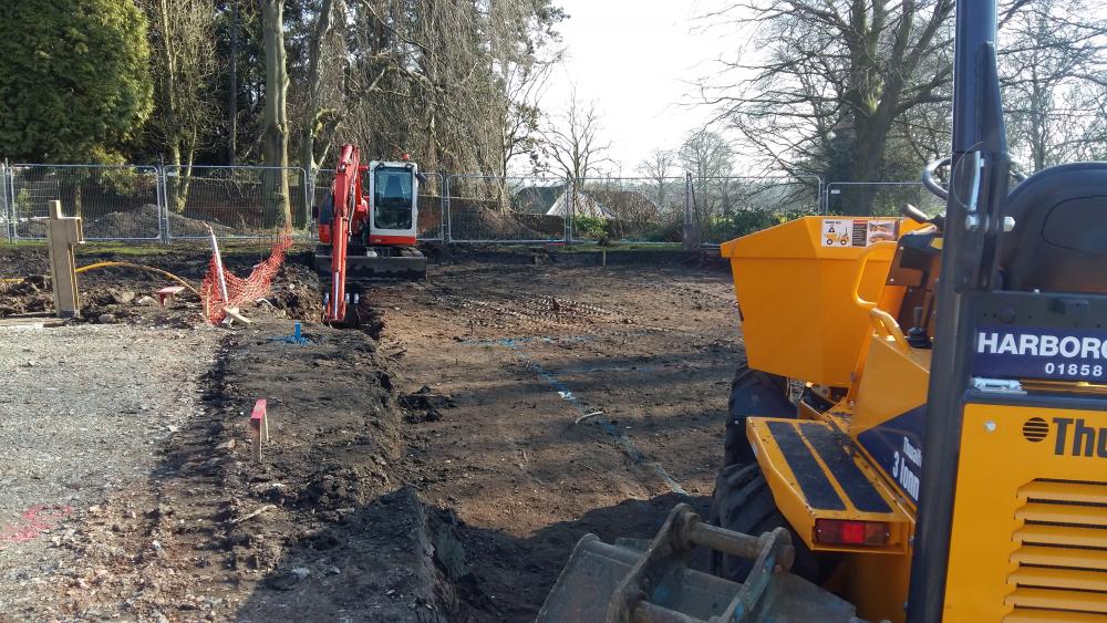

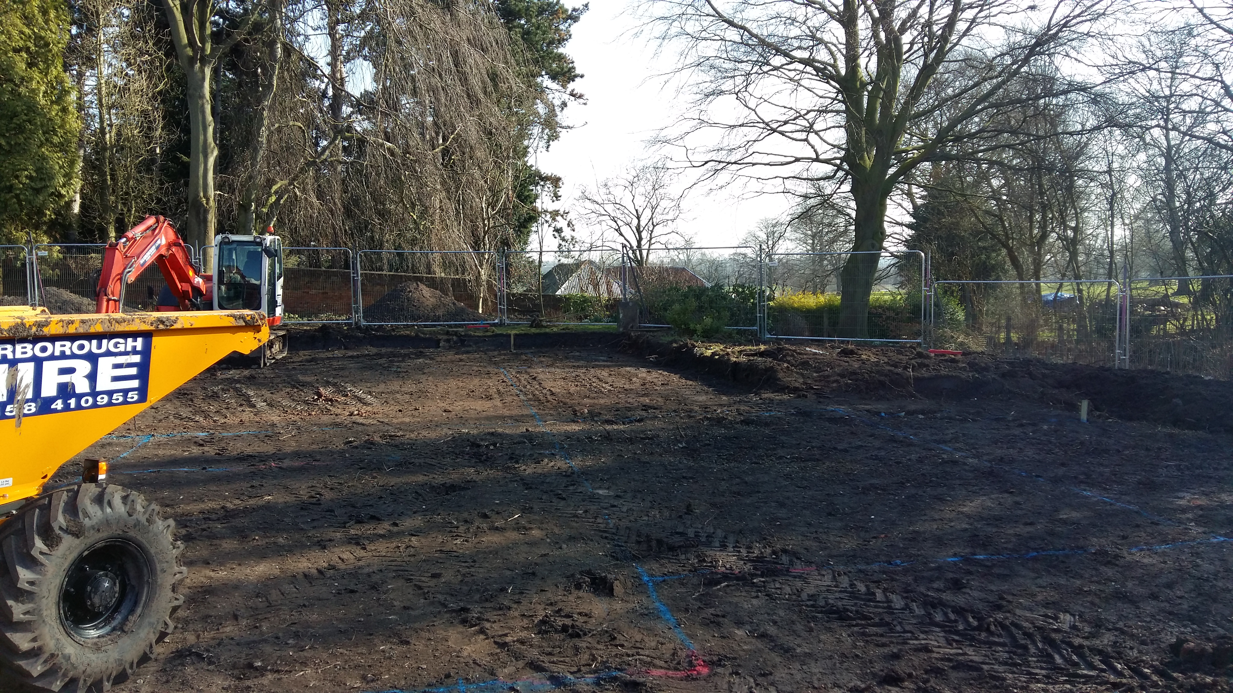

Jude1234 Posted February 25, 2018 Author Posted February 25, 2018 Progress update. We now own the land and the builders have started to dig the ground for foundations. Very excited that it is all starting now, it all seems very real now
Russell griffiths Posted February 26, 2018 Posted February 26, 2018 Hi looks nice and flat, have you not had to put a tree protection zone near those beech trees, be careful of any root damage it could reflect in future crown die back, builders do tend to think trees have a root system like a carrot.
jack Posted February 26, 2018 Posted February 26, 2018 Welcome. Sounds like a nice plot! One thing: if you're going for MVHR (a good thing - I'd never go back to living without it), you need to be thinking now about airtightness. Little details addressed at this stage will pay large dividends on how easy it will be to reach a reasonable airtightness level. For example, if you're going brick and block, look into parge coating (search "parge" on the forum). Consider how airtightness will be handled at interfaces between different building elements, such as around windows, and where walls meet roof. Lots of info around the forum, but if you have any specific questions, fire them off in the relevant forum and someone will hopefully be able to help.
Jude1234 Posted February 26, 2018 Author Posted February 26, 2018 21 hours ago, Oz07 said: Site looks dry. Well drained soil? It is clay soil and was a bit muddy in places. But it slopes downwards after the metal fence so water runs down that way
Jude1234 Posted February 26, 2018 Author Posted February 26, 2018 9 hours ago, Russell griffiths said: Hi looks nice and flat, have you not had to put a tree protection zone near those beech trees, be careful of any root damage it could reflect in future crown die back, builders do tend to think trees have a root system like a carrot. All of the big trees have TPOs which is why the metal fence is put up. It was a condition of the planning permission.

Russell griffiths Posted February 26, 2018 Posted February 26, 2018 1 hour ago, Jude1234 said: All of the big trees have TPOs which is why the metal fence is put up. It was a condition of the planning permission. In that case be very careful with the fence location, in the pics it looks a bit close, you should have some wording listing the tree protection zone and the distance out from the trunk, be careful builders will move things to make life easy for themselves and you could get a nasty fine. Just a friendly warning.
