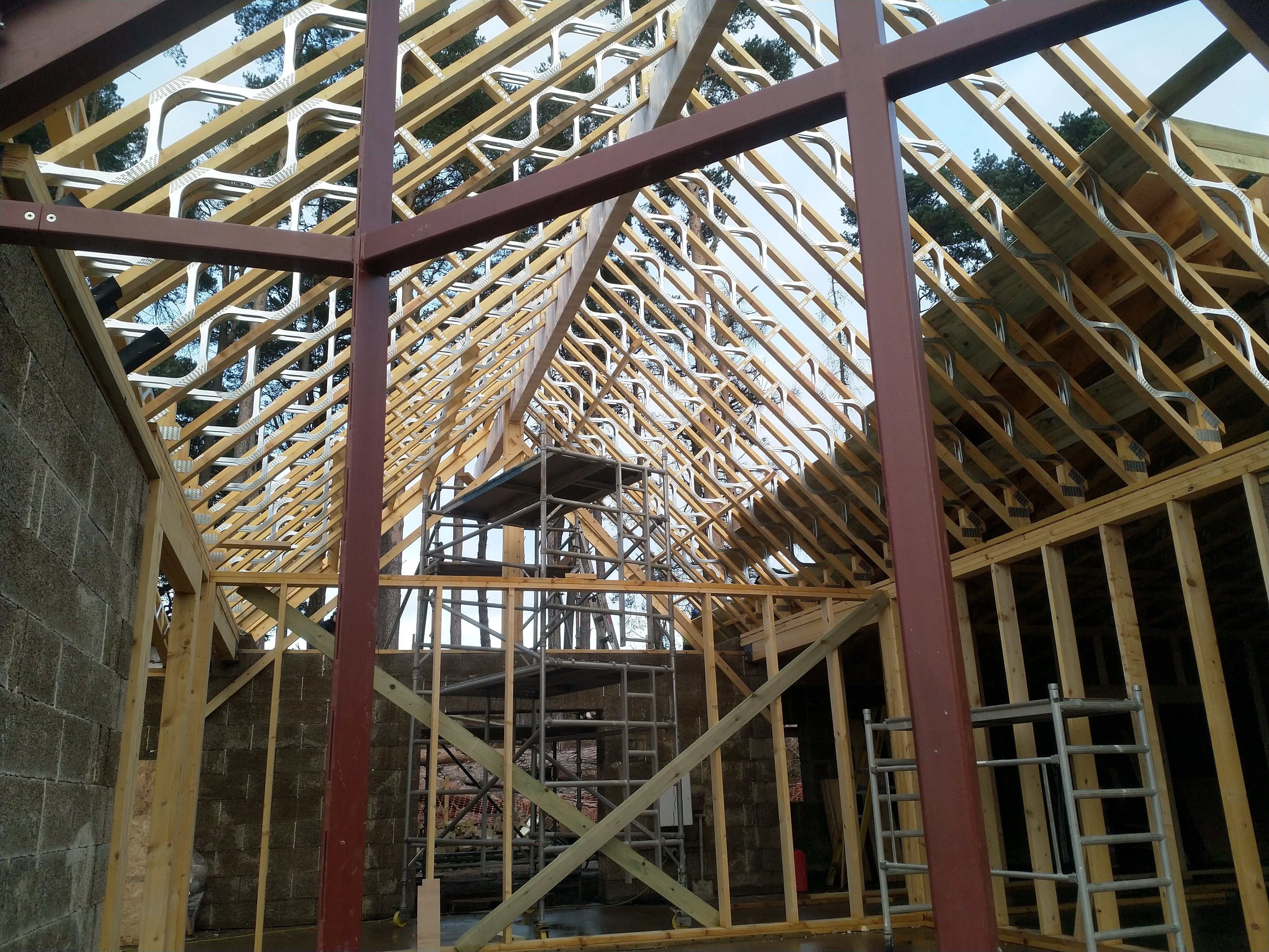

thaldine Posted December 2, 2024 Share Posted December 2, 2024 I'm planning to have an internal span of 6.7m across a living space in a 1.5 storey build with a ridge height of 6m and eaves of 2.9m with a profiled metal roof. Am I right in thinking this should be possible to achieve with the I-joist frame alone without a steel wind frame ? Thanks in advance. Link to comment Share on other sites More sharing options...
JohnMo Posted December 2, 2024 Share Posted December 2, 2024 A sketch may help, to visualise more clearly. Link to comment Share on other sites More sharing options...
Russell griffiths Posted December 2, 2024 Share Posted December 2, 2024 You can do whatever you want, but it will always have a knock on somewhere. we wanted timber and no shell for a large span, but the timbers started to need to be 450 deep. without steel would your I joist start to come out at some ridiculous size like this. you might also need to decrease the spacing between them. all of the above adds to the cost. do you have a drawing. in the end we went with a steel mid span and it halved the size of the i joists. mine was just a roof, not a whole frame. Link to comment Share on other sites More sharing options...
Conor Posted December 2, 2024 Share Posted December 2, 2024 Steel will likely end up being the easiest and most cost effective solution. That's why it's used so much. Do you have an SE that can looks tit for you? Link to comment Share on other sites More sharing options...

saveasteading Posted December 2, 2024 Share Posted December 2, 2024 37 minutes ago, G and J said: steel is inexpensive That beam is going to cost about £800 and require lifting gear and pads. Maybe you can find a preused beam....just maybe. You can use very deep joists at close centres with the added advantages of ease of fixing and easier service routes. But do you have the headroom? The cost may well be similar or worse. It is very essy to find the joist size, but then it needs costing. Link to comment Share on other sites More sharing options...
thaldine Posted December 2, 2024 Author Share Posted December 2, 2024 I can't lay my hands on a fully alike depiction but somewhat like this with 350mm deep I joists at 400mm centres. Link to comment Share on other sites More sharing options...
Russell griffiths Posted December 2, 2024 Share Posted December 2, 2024 There’s two blokes on here who have done that configuration with I joists. @Gone Westand @Patrick patrick isn’t on here much as he’s building up his empire. Link to comment Share on other sites More sharing options...
JohnMo Posted December 2, 2024 Share Posted December 2, 2024 We have a steel frame at the front of the house buts mostly to hold the glazing, and a big roof overhang - original design was all wood, but was way to chunky. There is no other steel in the house. Our living room is just over 6m wide and about 6m tall. Big glulam beam, posi rafters at 600mm centres. Part way through construction Link to comment Share on other sites More sharing options...
Gone West Posted December 2, 2024 Share Posted December 2, 2024 (edited) 43 minutes ago, thaldine said: I can't lay my hands on a fully alike depiction but somewhat like this with 350mm deep I joists at 400mm centres. Yes, we built our house in a similar way but we didn't use a ridge beam. Our house was built in 2010 and was the second construction of that type that the TF company built. The first was an art gallery which was much larger than our house. https://lowenergybuildings.org.uk/search.php?s=greendale https://lowenergybuildings.org.uk/projectPDF.php?id=255 Edited December 2, 2024 by Gone West Added link Link to comment Share on other sites More sharing options...
Iceverge Posted December 3, 2024 Share Posted December 3, 2024 Correct me if I'm wrong here. You have a vaulted living space that will be 6.7m wide so each rafter will span 3.35m and will be supported at the top by a ridge beam and 2.9m walls at the end. The ridge beam could be Gluelam, it depends how long it will be. The gable end wall will need to be strong Probably requiring a post to take the load to the foundation. I can't see why this couldn't be timber too. Depending on the amount of glass you plan to have. Link to comment Share on other sites More sharing options...
