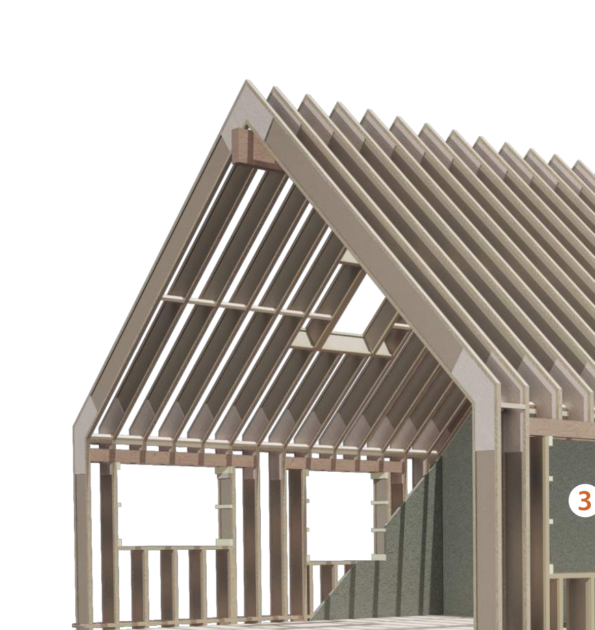

  4. I can't lay my hands on a fully alike depiction but somewhat like this with 350mm deep I joists at 400mm centres.
  5. I'm planning to have an internal span of 6.7m across a living space in a 1.5 storey build with a ridge height of 6m and eaves of 2.9m with a profiled metal roof. Am I right in thinking this should be possible to achieve with the I-joist frame alone without a steel wind frame ? Thanks in advance.
