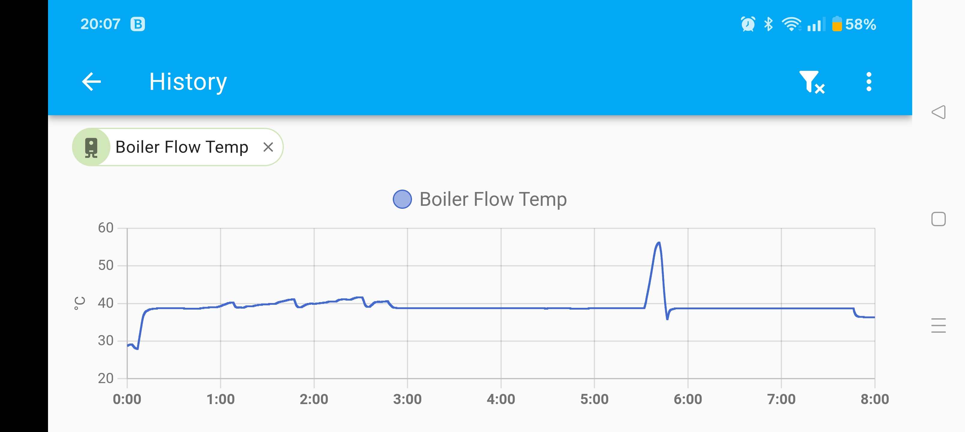

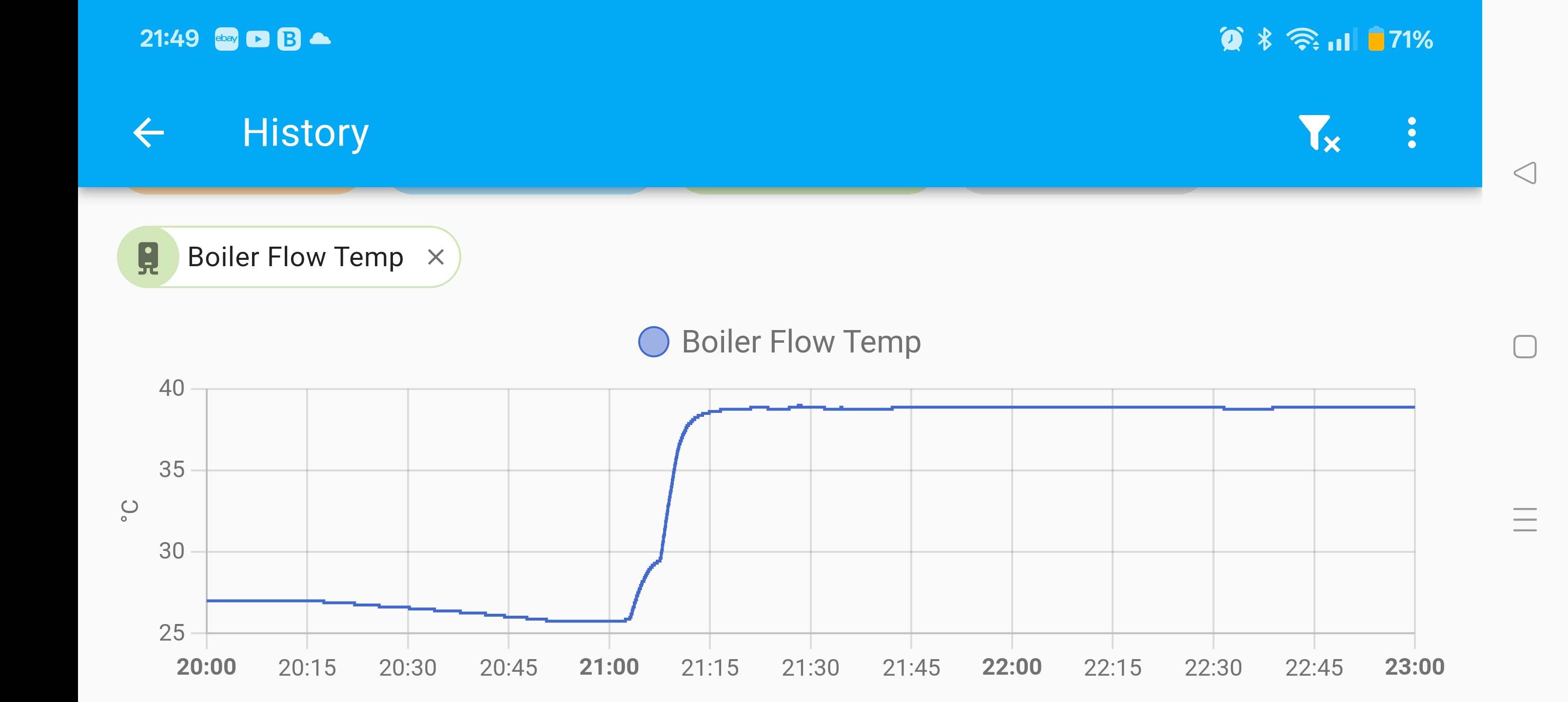

It was originally specified based on low temperature heat transfer. It's pretty huge Secespol LA34 40 plate. Used an online PHE sizing tool. It's getting an approach temp of a couple of degrees, with boiler UFH and similar when doing DHW heating.
Few trends below, first is boiler flow temp and cycle temp - using phe and heat pump cylinder. dT does decrease as cylinder gets hotter. But boiler seems happy enough.
Second is a typical run on a cold day, the bouncing about between 1 am and 3 am on second trend was heat pump also running. The spike is DHW heating.
