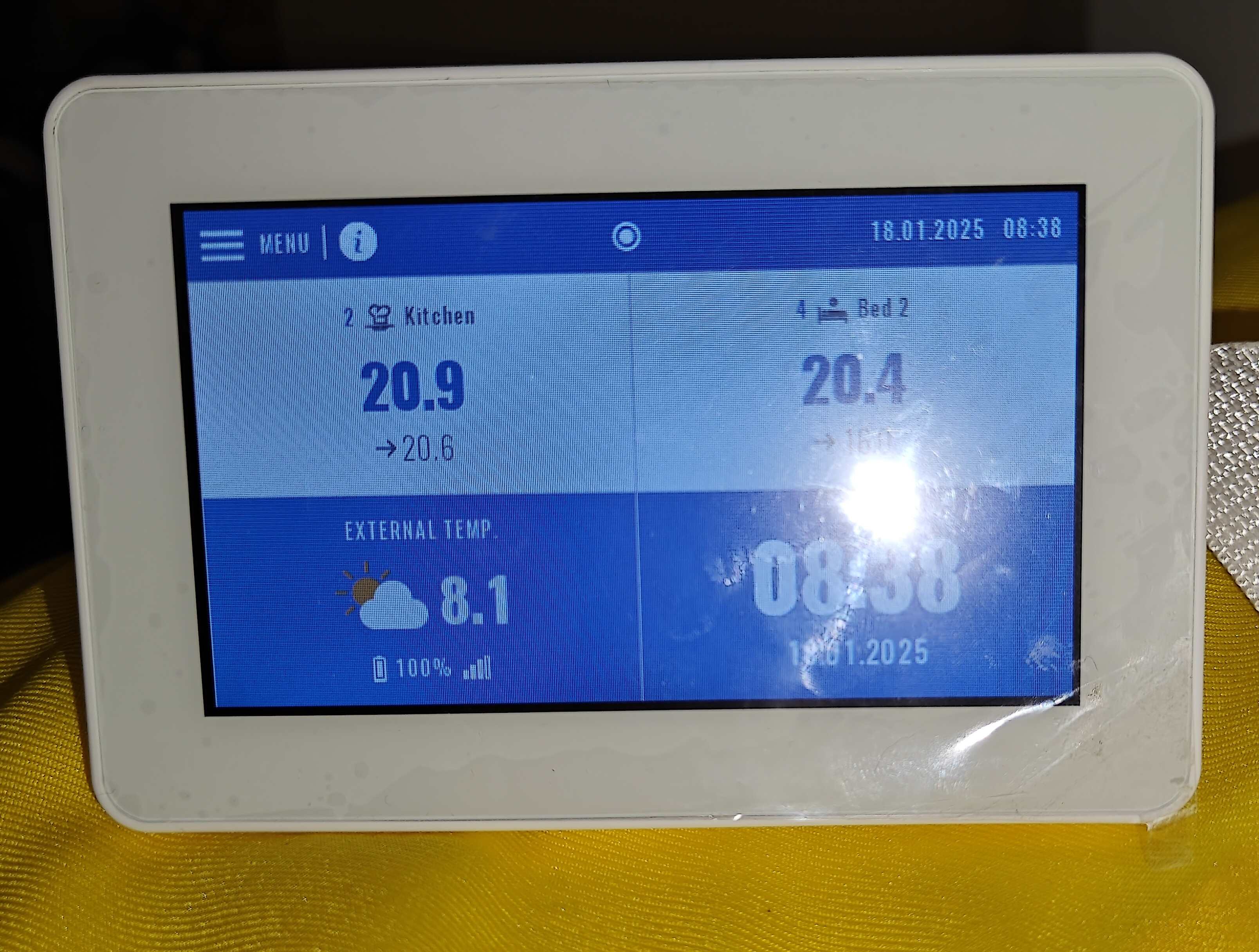

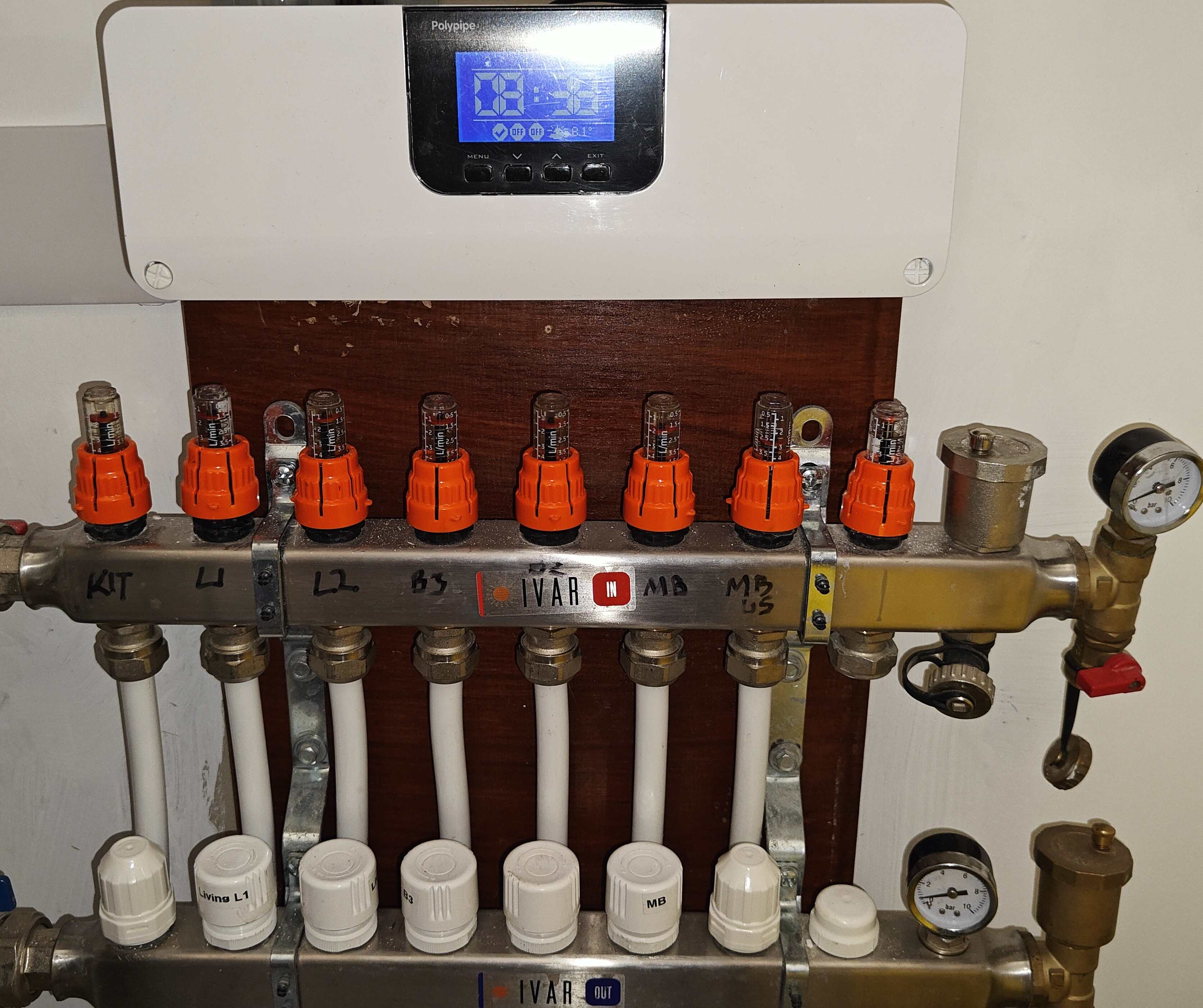

So based on a topic by @Beelbeebub I have been playing with my system and in the most part trying to get a system not connected in any part to the internet. This is now in place. No internet connectivity to anything that controls, but do some internet monitoring.

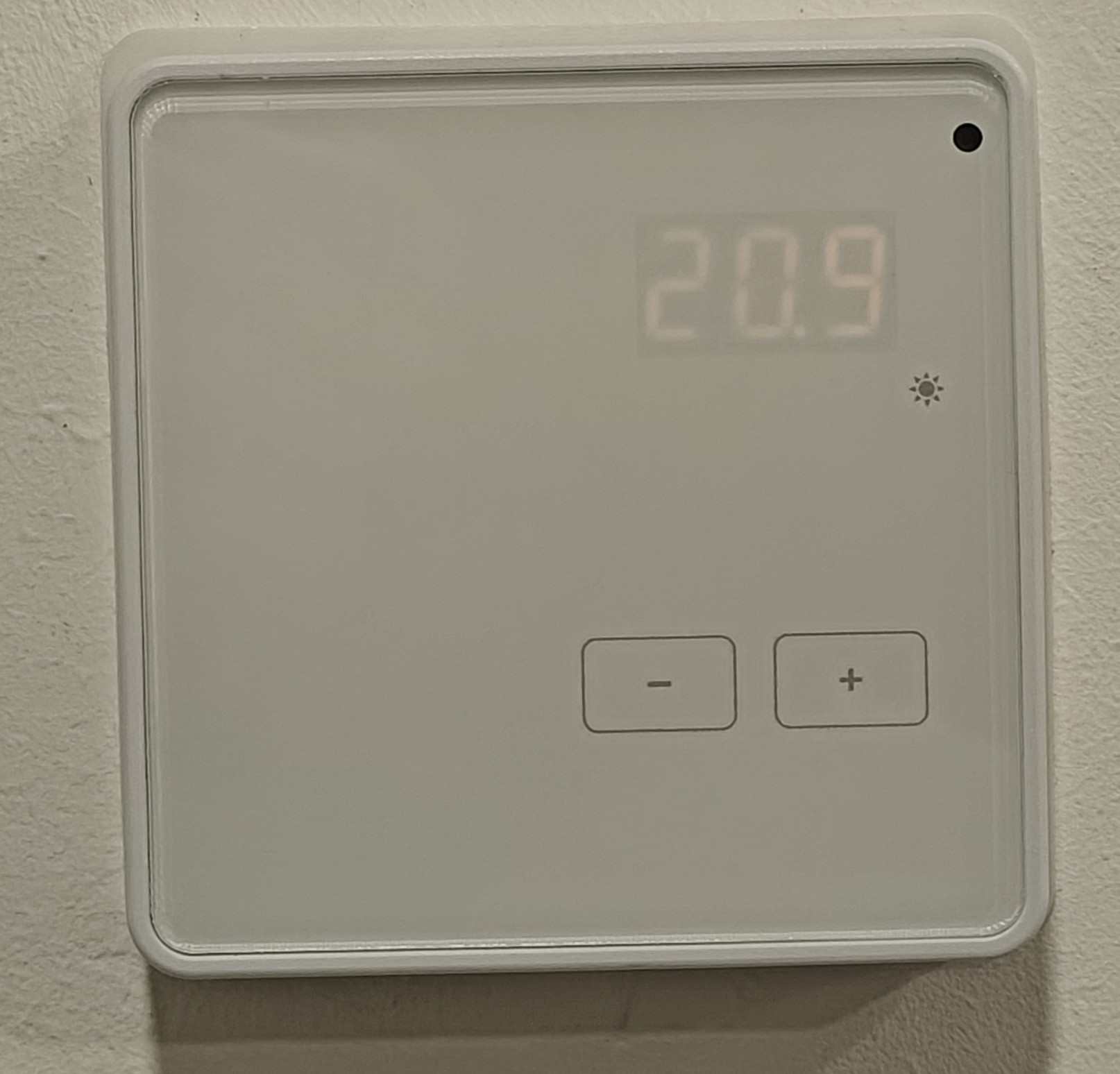

Have used a wiring centre, with lots of good features. It has a wireless outdoor sensor, can do Opentherm WC for boiler control, also has volt free NO and NC contacts, maybe able to use these to allow heat pump to run or stop it running - needs some thought. You can set an outside temperature threshold for the boiler to come on, so if average temp above X degs boiler is not started.
It has wired/wireless room sensors (not thermostats), the wiring centre can then be set with schedules and individual room hysterisis and target temperature. It can do cooling control based on humidity thresholds etc.
The controller I purchased is branded Polypipe, but also marketed by several others including Roth, but think made by Tech Controllers. The one I am using is being sold on eBay and was never formally released on sale. Bit to complex for the UK market, I suspect.
I have no actuators in the system, so it's all a single zone. Each room will have a sensor, but only two will be utilised for boiler control kone in hall and other in kitchen). So either can call for heat, both off to stop heat.
Running WC mode via Opentherm, and have an outside temperature threshold for the boiler to heating based on 5 degs averaged over 24 hours (this setting will need fine tuning). Heat pump settings or controls are not changed. Have found the heat pump runs only as needed.
Room sensors were £11, plus a Roth sensor with humidity £49
Wiring centre £149
Purchased a remote display/controller also (not needed) £49

Room sensor
Remote monitor - only two room connected at the moment.IMG202501180839512.thumb.jpg.e0faae0bdc1244fb05a4972f7949ae3a.jpg

You mentioned you don't have any actuators, does it have the facility for zones? Can it handle hot water production
Yes this unit does 8 zones, 4 loop actuators per zone, directly and also allocate loads of additional ones from other zones if you want. It can also communicate to loads of slave controllers, think it can do 48 zones.
Yes has hot water timer and uses zone 8 for this, has a 230v output. May do this at some point.

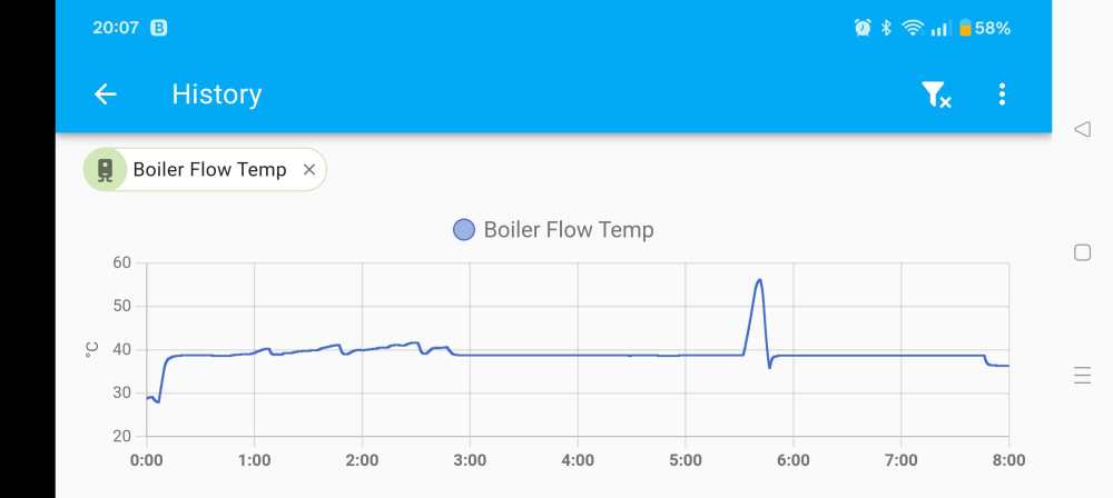

Seems to work well
5 degs and below for at least 6 hrs, is needed to allow the boiler to run. All other times ASHP runs.  ASHP set up via Home Assistant to take excess PV when battery is above a set charge and generating enough PV to get a decent run time. Past few weeks nearly all heat pump running has been on excess PV - so zero cost, boiler had no need to start because house was warm enough.
No excess solar yesterday and down to 1 deg overnight. Heat pump ran for about 2 hours and the at first defrost, the boiler picked up the drop in flow temperature and started up, it did the rest of the heating overnight.

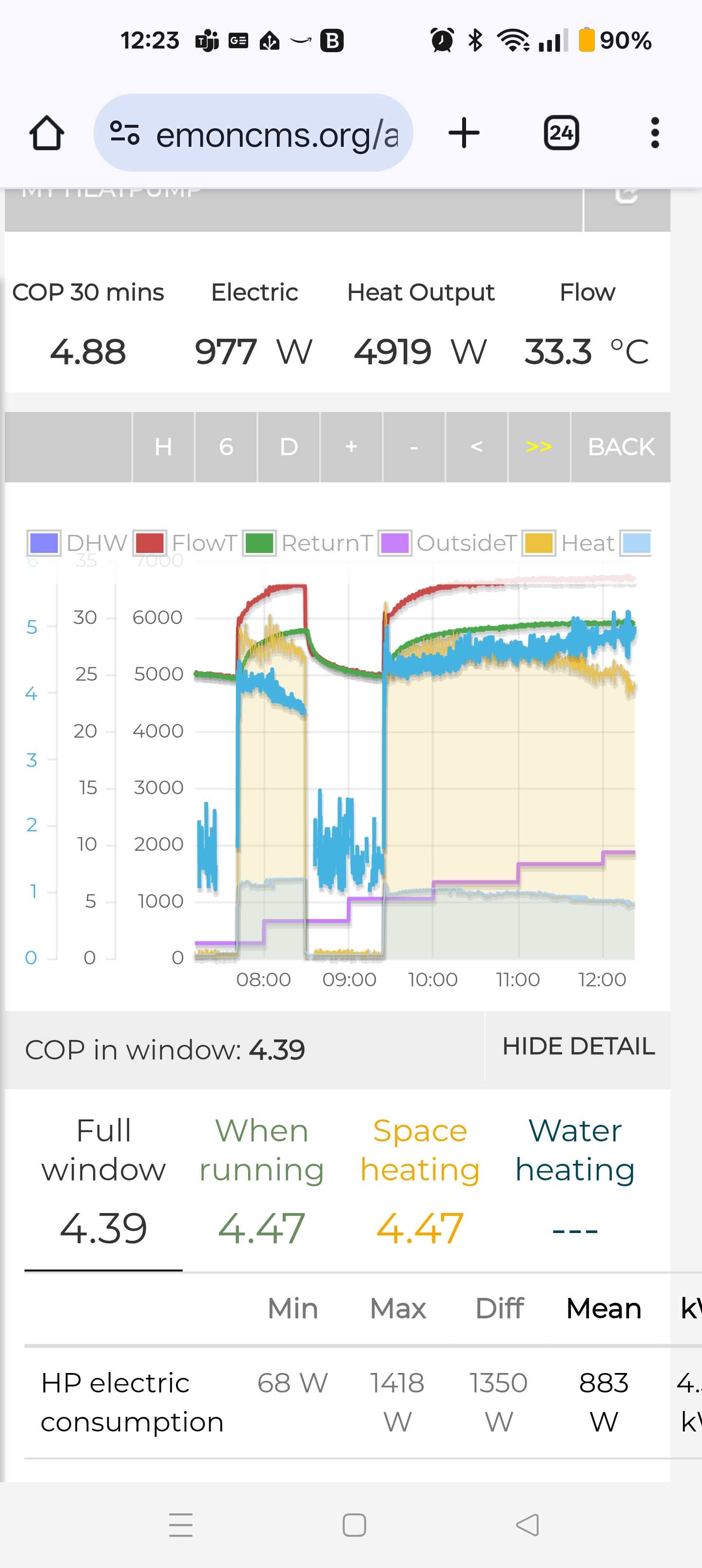

5 degs was the lowest temp I could set the controller to to enable heating.  But we aren't that far from the coast and can get defrosting at about 5 degs.
When we get defrosting CoP drops to about 3.  We pay 13p overnight, so about 4.3p per kWh (0030 to 0730), gas is 5p and not quite 100% efficient, so pretty much like for like pricing. But once a sustained below zero the heat pump runs in the expensive period (0730 to 0030) at 30p, so getting towards twice the price for electric, compared to gas for the same kWh delivered.
So overall a little cheaper, but not much - if I had to pay for hybrid system not really worth it.
Today has solar excess so floor is being buffered from heat pump. So unlikely any additional heat will be needed overnight.
Screenshot_2025-03-24-12-23-28-39_40deb401b9ffe8e1df2f1cc5ba480b12.thumb.jpg.63e67c54cecff468e31a01d50cec9007.jpg
Average heating cop is 4.47, but as day temp increases, the CoP also goes up even with rising flow temp.
