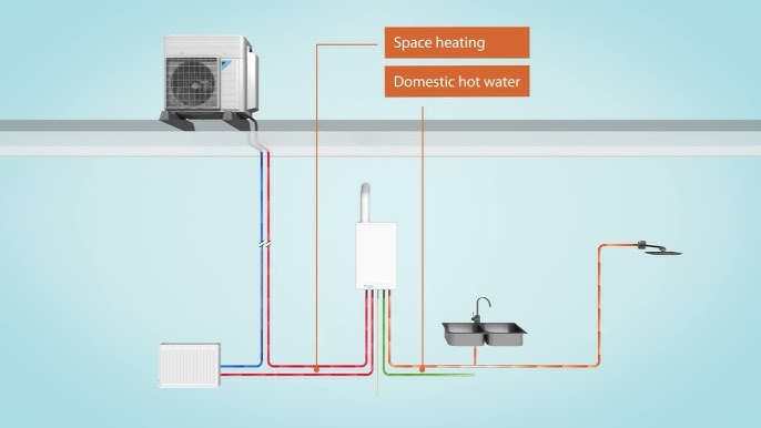

JohnMo Posted November 25, 2024 Author Posted November 25, 2024 Heat pumps like Daikin, Panasonic have inbuilt algorithms where you add tariff, CO2 intensity details and it controls the heat pump and boiler as needed. You need the CO2 output as the default setting and make it difficult to change. The average consumer would have zero interest in changing from the default settings anyway. Looking at Daikin schematic the heat pump is just added to the heating circuit return line, so you don't even need a tee or check valve
ProDave Posted November 25, 2024 Posted November 25, 2024 52 minutes ago, JohnMo said: Looking at Daikin schematic the heat pump is just added to the heating circuit return line, so you don't even need a tee or check valve I struggle with the concept of this hybrid arrangement. The basic reason for wanting a hybrid appears to be you have small high temperature radiators and a heat pump can't heat the water hot enough for them. So you add a heat pump to a system with a boiler. I can see in the shoulder months you might be able to run it heat pump only and have lower temperature in the radiators that would work at a time of low heat demand, and add the boiler to the mix when it gets colder. I could see that working with a changeover either / or situation. But that scheme above with the heat pump pre heating the return to the boiler, assumes the return temperature is low enough for the heat pump to add any meaningful heat to it. Most boiler fuelled central heating I see the radiators are run too hot to touch, and I very much doubt the return temperature to the boiler is less than 50 degrees. I just can't see this working in a completely automated fashion to add anything of value to the customer. I doubt the heat pump will ever produce heat cheaper than the boiler. Why would a customer want something expensive and complicated that saves no or little money? It really sounds like a "box ticking" exercise to get more heat pumps in use, but in a way that is almost guaranteed to get them a bad reputation. 1
