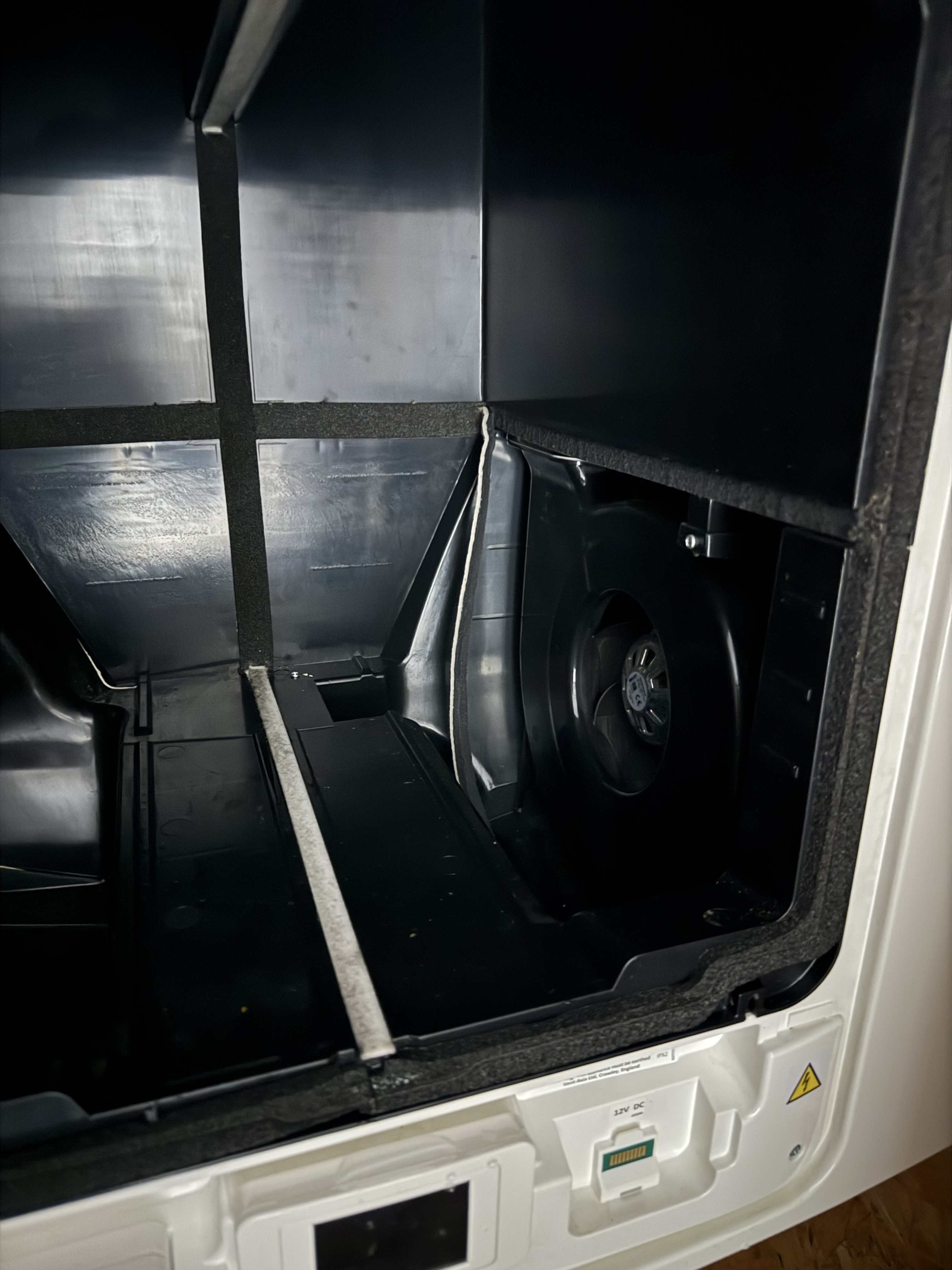

So you know both sides collect condensate, and both have a hole in the bottom.  So find another fitting then tee both condensate outlets to your drain.  Think of it as a product upgrade.
Well !
vent axis instructions insist on ONE drain .
Apparently according to them - 2 drains can conflict and cause vacuum on the other .
So drain on left side as instructions dictate . Water on right - as there is no drain .
I want to know why vent axia don’t mention this ….
I simply can’t be the only person ever to experience this .

Condensation is as you say on the exhaust pipes ( to atmosphere ) . So as expected .

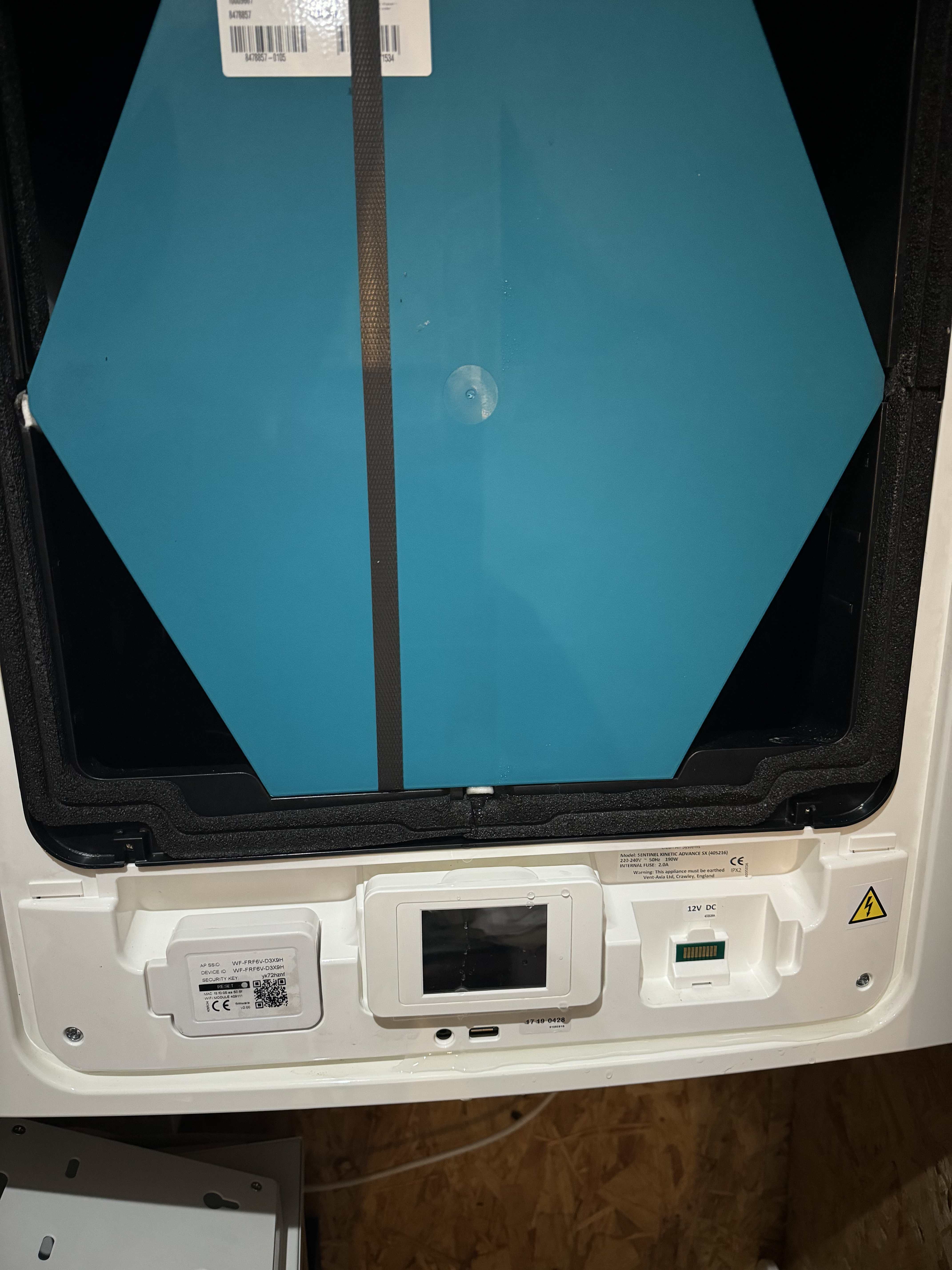

I’ve never removed the heat exchanger unit now so *assume* it’s in the right way round ! . How can I tell ? I think it would fit in either way which sounds like bad design imho .
Heat exchanger is a snug fit so no chance of sitting incorrectly.

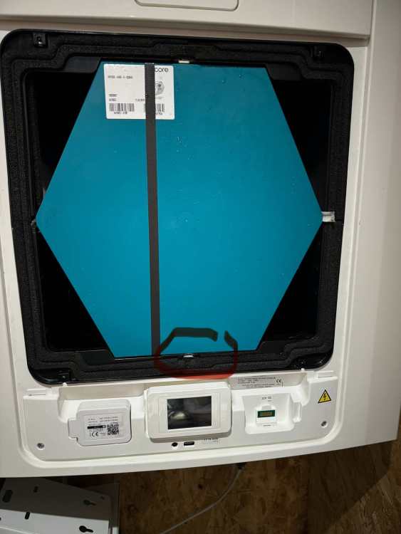

So it’s dripping again from the front . Opened both valve caps empty of water . So the heat exchanger I assume .
Do I clean it ? Just rinse water through it ??

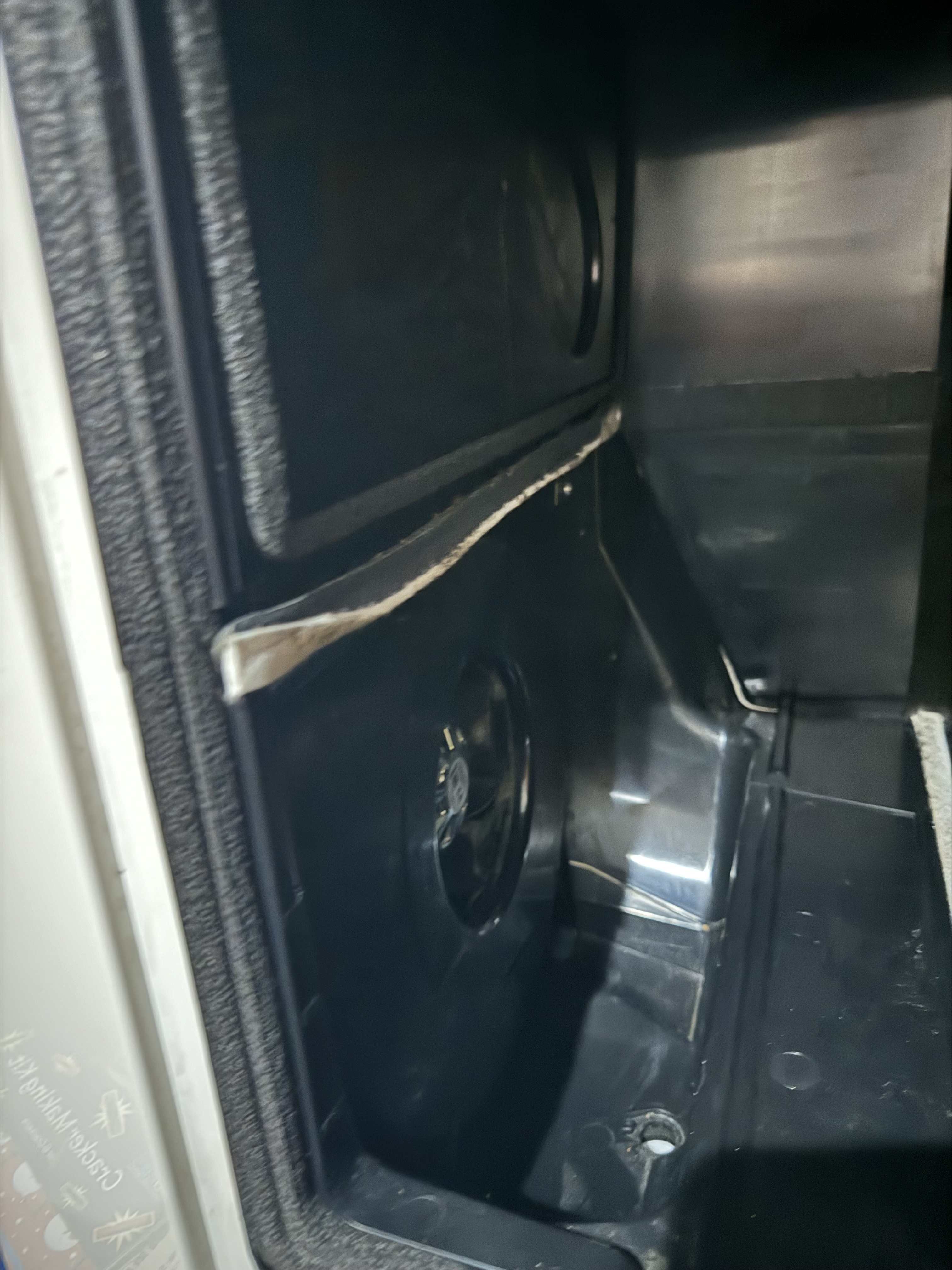

Notice felt guide on one side bent . Other side fell off . Ct1 that side back on ?
Is this enough to cause water to run forwards ?
Stuck a small spirit level inside it as best I could . Assume really I want it to be slightly tilted back so water runs away from the front and to the left where my drain is . Seems to be the opposite in both axis !!
I managed to pack it off the wall at the base . So it tips a bit more backwards .
At this point in time as it’s run flawlessly for 4 yrs - I can only assume it’s moved slightly causing water to pool forwards and to the right ( bit with no drain ) .
Or maybe dirt/ dust in the heat exchanger changing water flow direction ??? . How best clean that ? . Just sit in the bath and run hot water and detergent through it ??
All back together now . Want too see that water out the front has been solved . Then it’s in the lap of the gods if it flows left ( hurrah ) or right ( boo )

I’ll let it run for tonight and see . When I did take the heat exchanger out it did have a surprisingly large amount of water in it .

No water out of front . But some still pooling in right side where there’s no drain . Think I’ll have to do the double drain bodge
38 minutes ago, Blooda said:
Depends where you are draining to, if you are draining to foul drain, then a waterless valve [commonly known by the trade name of the leading brand HepvO, or more colloquially known as a <Censored> Trap] is to be used.  This is because a U Trap can dry out and let smells up into your MVHR, and by nature of design distribute those smells throughout the house.
The current Hepvo goes straight into a discharge pipe and outside ( not into drain ) . Think I’ll just install another water less trap on the other outlet and connect them together .
