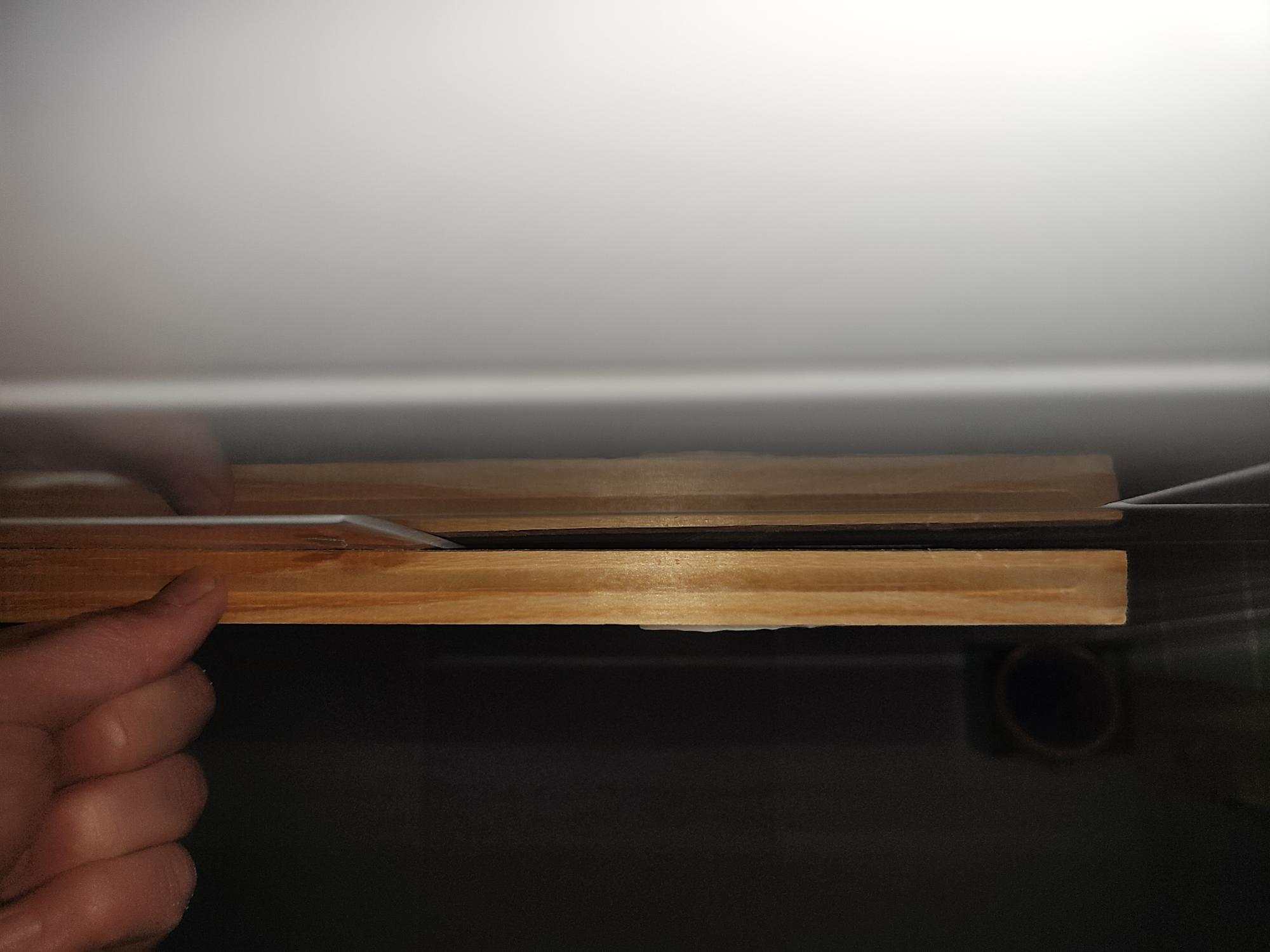

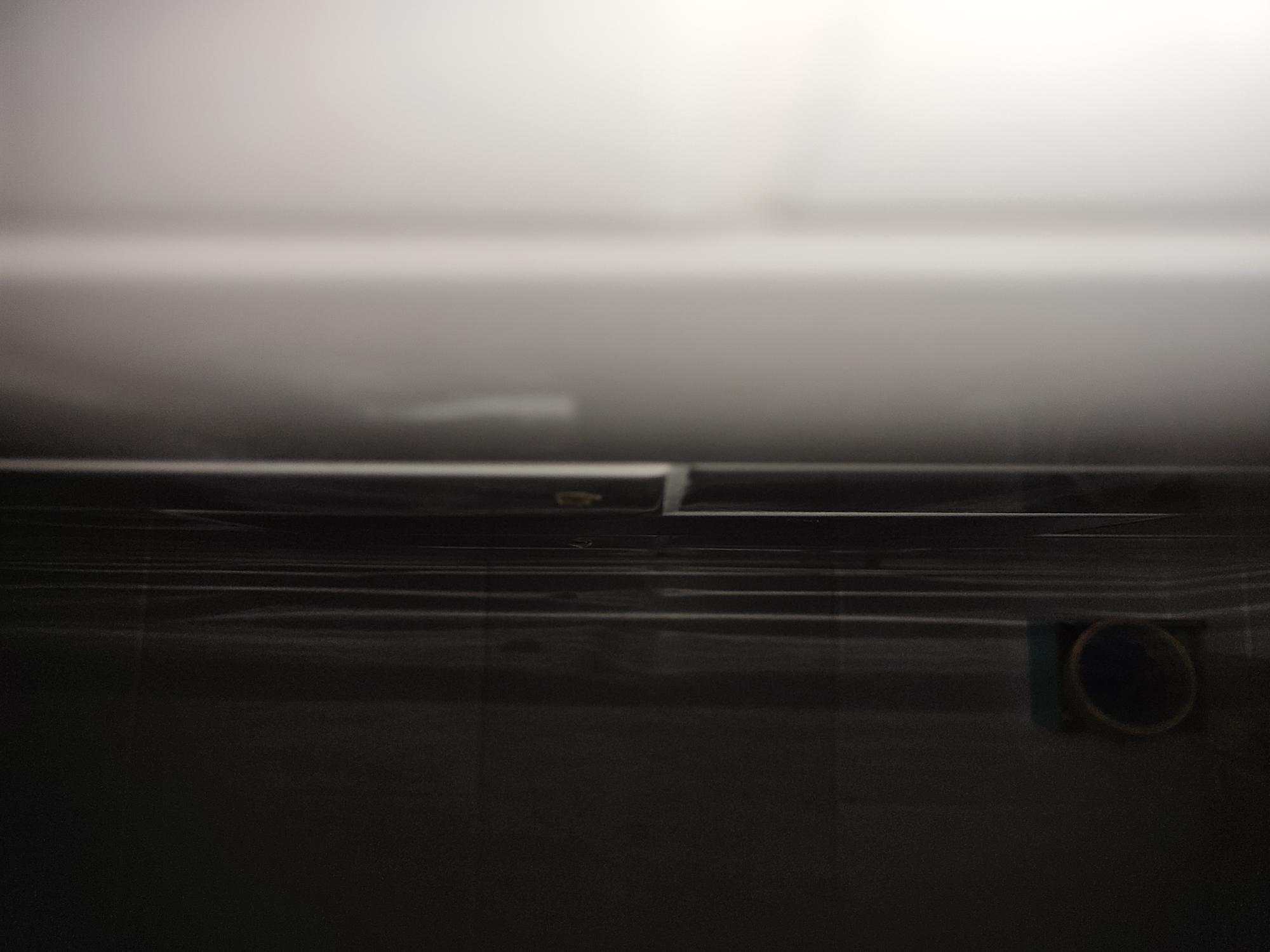

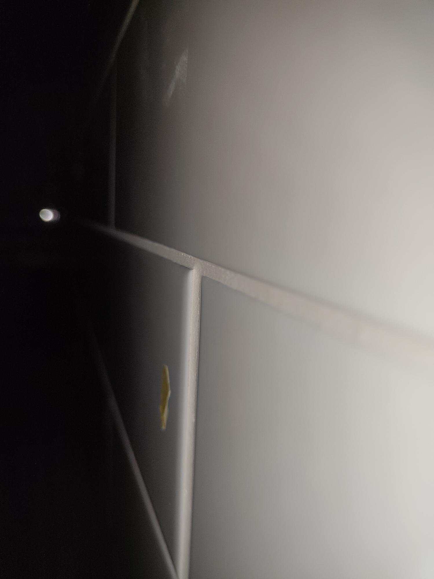

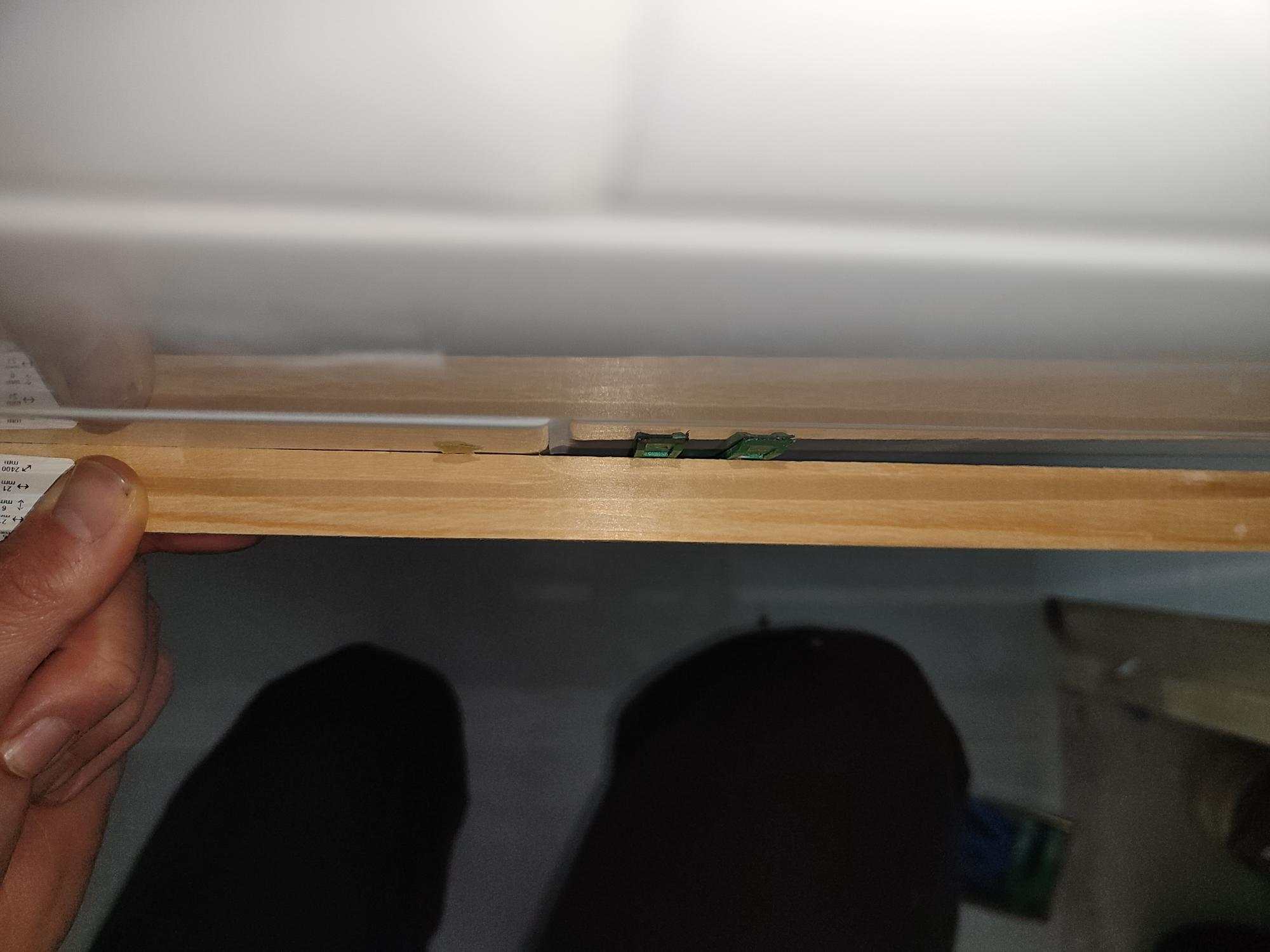

MortarThePoint Posted November 6, 2024 Posted November 6, 2024 (edited) Has our first room tiled and noticed that some tiles out sticking out or sunken slightly. Below is one of the worst examples where it fits a 2mm packer.any fit a 1mm packer though. The tiles themselves seem to be very flat, so are laid unlevel. The tiles are 300mm x 100mm. What's an acceptable tolerance here? Am I fussy or is this not good enough? Edited November 6, 2024 by MortarThePoint
MortarThePoint Posted November 6, 2024 Author Posted November 6, 2024 @Nickfromwales and @nod you know what quality to expect. Do I need to have a word with the tiler or am expecting too much? To be clear, the issue was spotted by eye in a number of places before trying a short straight edge on it.
nod Posted November 6, 2024 Posted November 6, 2024 If the edges match the tiler will probably blame the walls You can always find Something with tiles Some tilers are using leveling systems on wall tiles Which can give a nice edge but cause hollows I’m not keen on levelers on walls 1
MortarThePoint Posted November 6, 2024 Author Posted November 6, 2024 Just now, nod said: If the edges match the tiler will probably blame the walls You can always find Something with tiles Some tilers are using leveling systems on wall tiles Which can give a nice edge but cause hollows I’m not keen on levelers on walls The edges don't align and the walls were very flat (rendered). I don't like the levelling system so much, but this feels too far from tolerance as I can pick it up with an inexperienced eye.
nod Posted November 6, 2024 Posted November 6, 2024 1 minute ago, MortarThePoint said: The edges don't align and the walls were very flat (rendered). I don't like the levelling system so much, but this feels too far from tolerance as I can pick it up with an inexperienced eye. Hard to tell from the picture Point it out and ask him to take the bad ones out
MortarThePoint Posted November 6, 2024 Author Posted November 6, 2024 Just now, nod said: Hard to tell from the picture Point it out and ask him to take the bad ones out How big a deal is that. Will he get the hump or is it standard work?
MortarThePoint Posted November 6, 2024 Author Posted November 6, 2024 12 minutes ago, Russell griffiths said: Take a better picture to show us. It's hard to get in a photo. Tiles are 300*100. In the second photo below (with short straight edge) the right tile is reflecting the straight edge and the fact the reflection doesn't touch the actual straight edge makes it more obvious.

MortarThePoint Posted November 7, 2024 Author Posted November 7, 2024 Well that conversation could have gone better. I said he didn't need to replace them to which he said he wouldn't be happy knowing they are there, but he'll finish up where he has already started and step out on the rest of the job. A shame as I think he's a good tiler and normally seems like a nice bloke too. No raised voices on either side and I approached it as being a tad apologetic to raise the issue. I've a big area (72m2) of hard to lay tiles that I need to have confidence in and if I can't talk quality with the tiler it's an issue. 1
Nickfromwales Posted November 7, 2024 Posted November 7, 2024 5 hours ago, MortarThePoint said: Well that conversation could have gone better. I said he didn't need to replace them to which he said he wouldn't be happy knowing they are there, but he'll finish up where he has already started and step out on the rest of the job. A shame as I think he's a good tiler and normally seems like a nice bloke too. No raised voices on either side and I approached it as being a tad apologetic to raise the issue. I've a big area (72m2) of hard to lay tiles that I need to have confidence in and if I can't talk quality with the tiler it's an issue. Yup. Nice isn’t good enough, needs to have quality or what’s the point. Make sure you have spares of the batch of tiles above, then ask your new tiler to cherry pick the few bad ones and re-set new tiles in to reduce the issue. Does just seem a bit of complacency had set in from the pics, as just the odd one vs a whole shite lay….. shame as you say but needs doing properly, simples.

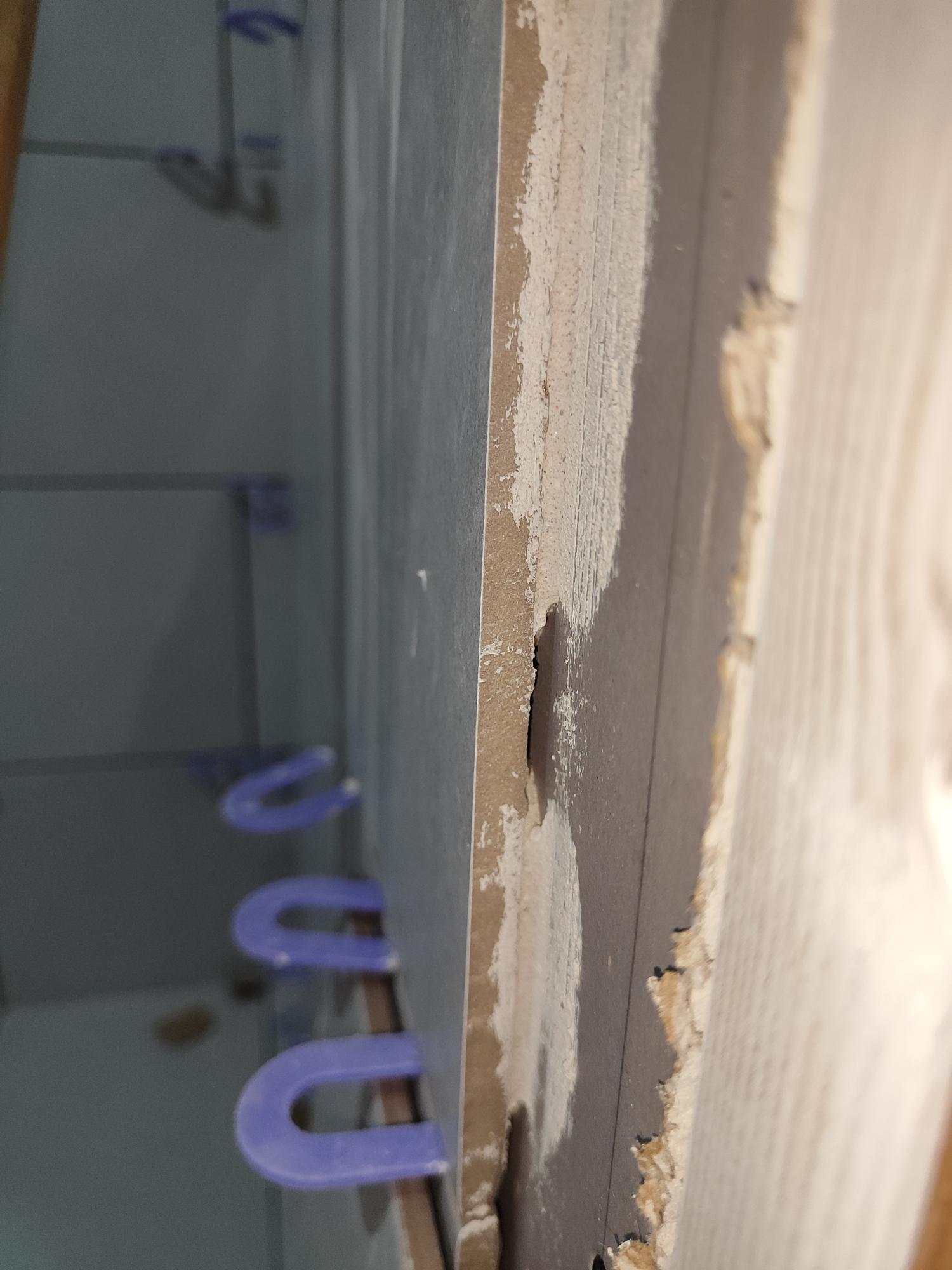

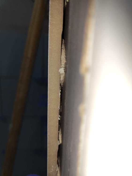

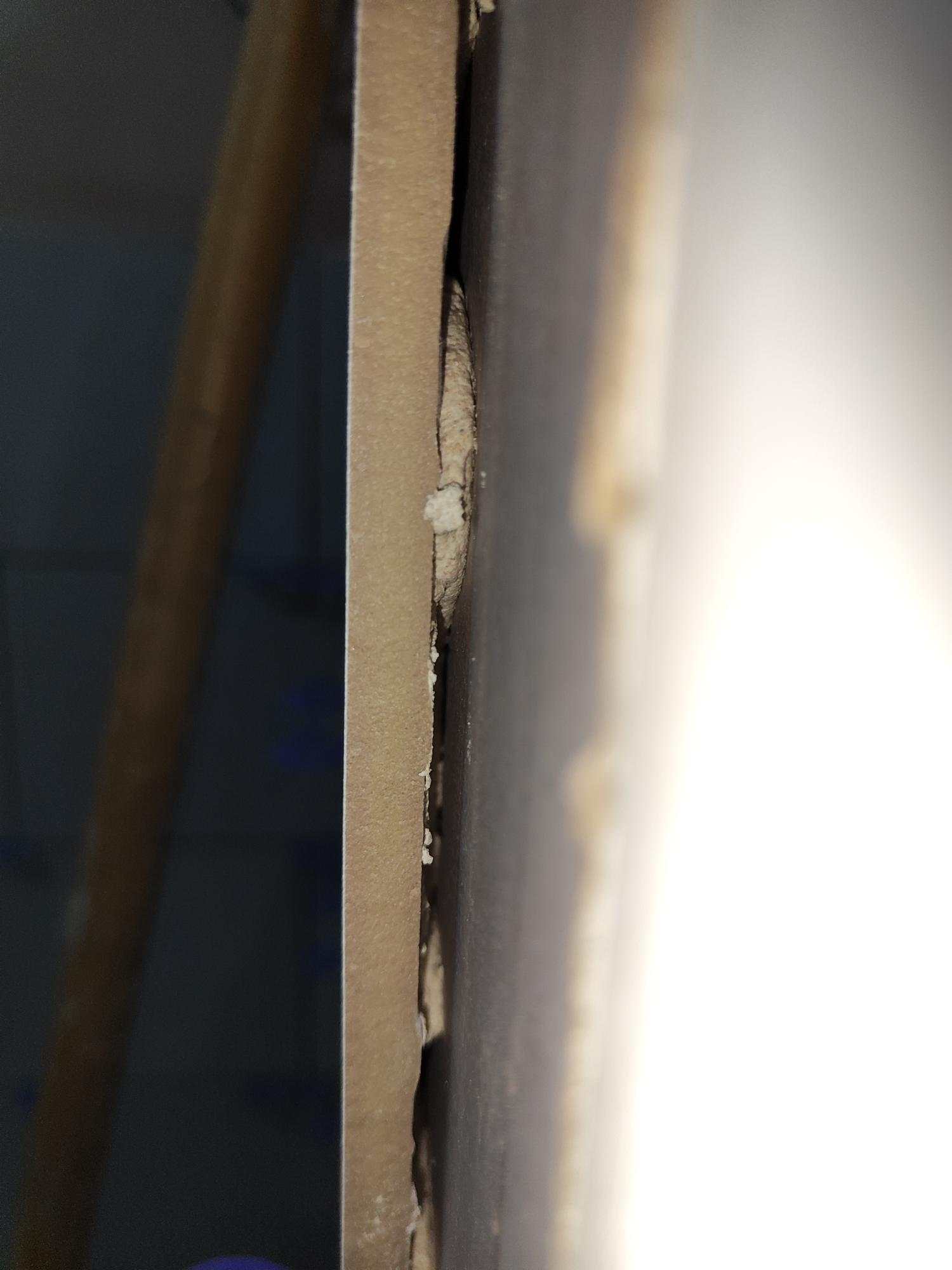

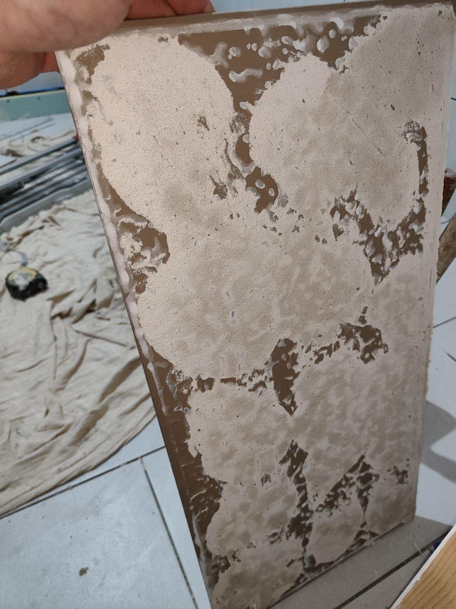

MortarThePoint Posted November 7, 2024 Author Posted November 7, 2024 (edited) I didn't watch over him today and he was laying walls in 600x300 porcelain tiles (3.27kg each so 18.2kg/m2) and it looks like he has used a dot and dab method. See pictures below. I noticed this because I stepped into the room after he left and the whole room is making a bubbling/fizzing sound. The photo of a tile back is one that was lent against the wall. The other photos are taken looking at the edge of the tiled area. The tiles are 9mm thick. Half the room is plasterboard, the other half is rendered blockwork. @Nickfromwales @nod urgent advice please 😱 Edited November 7, 2024 by MortarThePoint 1
MortarThePoint Posted November 7, 2024 Author Posted November 7, 2024 (edited) From the BAL website: "BS 5385-1: 2018 advises: “Tiles with a surface area of less than 0.1 m², but which weigh more per square metre than 70% of the background’s capacity to carry the weight, should be solidly bedded e.g. the maximum weight of tile that can be supported by Gypsum plaster = 20 kg; whereas 9 mm thick porcelain tiles, which weigh approximately 18 kg/m², weigh more than 70% of 20 kg (14 kg) therefore, they should be solidly bedded regardless of their size”" Edited November 7, 2024 by MortarThePoint
MortarThePoint Posted November 7, 2024 Author Posted November 7, 2024 (edited) As it's all still wet should I pull the tiles off and if so how best to clean to save some and the walls? Edited November 7, 2024 by MortarThePoint

MortarThePoint Posted November 7, 2024 Author Posted November 7, 2024 I phoned the tiler (he is a dedicated tiler and not cheap either) and he says that he has dot and dabbed them and that's the only way to get them flat. He's "been tiling for 40 years and never had tiles fall off. They will never fall off"
Chanmenie Posted November 7, 2024 Posted November 7, 2024 I could not live with them that far off flat it would do my head in. l’ve just tiled my upstairs bathroom and used a levelling system. It was so easy to use and the end result looks great. I would never lay tiles now without using a levelling system. 1
MortarThePoint Posted November 7, 2024 Author Posted November 7, 2024 (edited) 2 minutes ago, Chanmenie said: I could not live with them that far off flat it would do my head in. live just tiled my upstairs bathroom and used a levelling system. It was so easy to use and the end result looks great. I would never lay tiles now without using a levelling system. Sorry, I have now steered the thread to a new issue which is some dot and dab tiling Edited November 7, 2024 by MortarThePoint
Chanmenie Posted November 7, 2024 Posted November 7, 2024 1 minute ago, MortarThePoint said: Sorry, I have now steered the thread to a new issue which is some dot and dab tiling Yeah I saw that, that looks crap as well. if the wall is a bit off flat just use a bigger notched trowel. That will give a much better contact area. Dot and dab is just lazy IMHO, I’ve watched lots of tiling videos and no professionals use dots and dabs, they all use notched trowels 1
Pocster Posted November 7, 2024 Posted November 7, 2024 (edited) Back butter tiles . Adhesive on wall and notch . Don’t want any hollows especially if anything is mounted to the tiles . Though back buttering not strictly necessary for wall tiles … Edited November 7, 2024 by Pocster 1
Chanmenie Posted November 7, 2024 Posted November 7, 2024 5 minutes ago, Pocster said: Back butter tiles . Adhesive on wall and notch . Don’t want any hollows especially if anything is mounted to the tiles . Though back buttering not strictly necessary for wall tiles … Yeah I back buttered it’s quite easy with a little practice and gives confidence 1
nod Posted November 7, 2024 Posted November 7, 2024 NO I would lay flags like that Whilst voids behind wall tiles to really matter He’s making work for himself A nice even 10 mil notch on the wall and a 5 mill lick on the back of the tile 3 1
