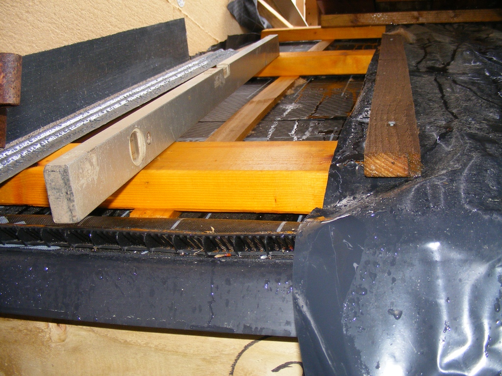

This is the detail for my sun room. The box profile sheeting (mocked up with the spirit level) won't quite touch the ventilator strip. The eaves filler for the box profile roofing will fix (probably with glue) to the top of the ventilator strip.

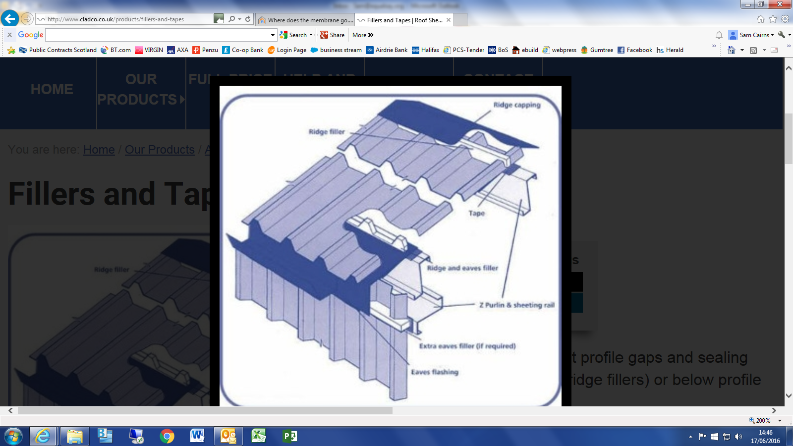

I'm not yet sure how you ventilate the ridge of a box profile roof.

That picture above seems to show what you do if you have the felt above the counter battens, Then the vent strip can go under the support tray. That won't work if you have the membrane on the sarking and then the counter battens, which is why i have the vent strips on top of the support tray.
The bottom of the membrane gets sandwiched between the tray and the vent strip and then the flapping edge I cut off with a knife.

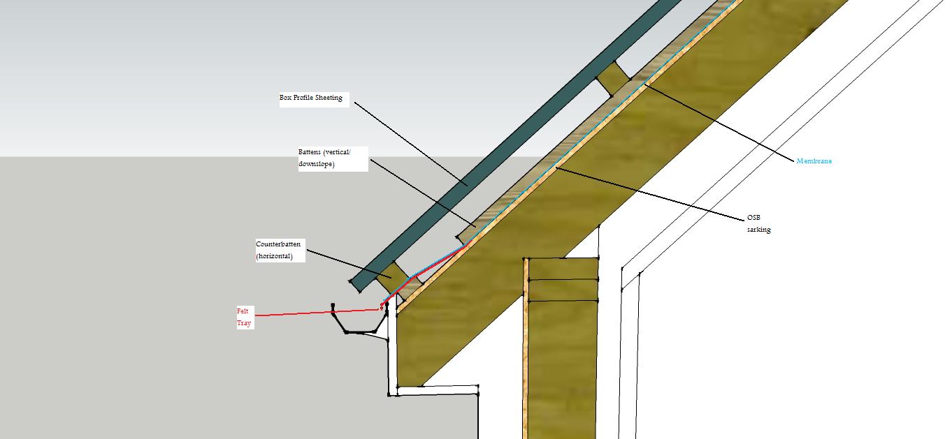

How does this look for my eaves detail?
(sorry for my poor CAD skills!)
I guess I'll need some sort of beastie mesh between the underside of the steel and the felt tray (this is a 50mm gap created by the horizontal battens).
Main concern is that the very edge gets a bit messy with the tray riding up over the edge of the fascia. I could drop the height of the gutter and keep the tray at the same angle as the roof, which was my original plan, but this leaves a bigger gap which might look a bit odd, and may be harder to find suitable vent strip or bug mesh for.

Interesting, thanks. One problem I'm finding with using steel roofing is that the normal application is quite different from a house- i.e. an open underside, without sarking needing drained, and installation on purlins rather than rafters.

My plan detailed above will not work- the 50x50 horizontal batten would close off the drainage gap under the roof sheeting completely. So I would have to move that batten 'upslope' but this weakens the support for the roof sheets right at the eaves, where support is critical to resist wind loads.

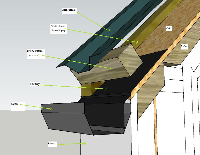

New plan is simpler- stick the felt trays down directly onto the OSB, with all the battens on top. I have not shown the membrane for clarity but it would go on top of the osb and overlap onto the start of the tray (googling suggests min 125mm overlap).
The downside of this approach is a slightly more open eaves detailing and I wonder what it will look like. I would use a 25mm vent strip (or a DIY version) beneath the 50x50 batten, which would be hidden from view by the gutter; an eaves infill strip would go on top of that batten to close up the gaps along the bottom of the box profile.

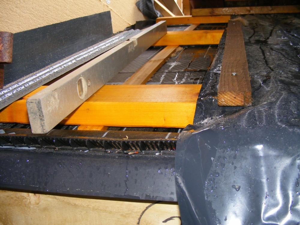

What is wrong with the way I am doing it, in post #6? the bottom horizontal batten is only about 6" up roof so I don't think it will leave much flapping in the wind.
Your roof is going to be so high compared to the gutter, I would be worrided the water might miss the gutter.
Have to admit I'm struggling a bit to interpret your picture, Dave. Perhaps there is some foreshortening going on and the tray is a bit hard to see.
Studying it a bit harder, I wonder if the tray is quite flexible and you have battened it down almost to the bottom of the roof, then kicked it up to a shallow (near flat) angle to sit on top of the fascia board?
