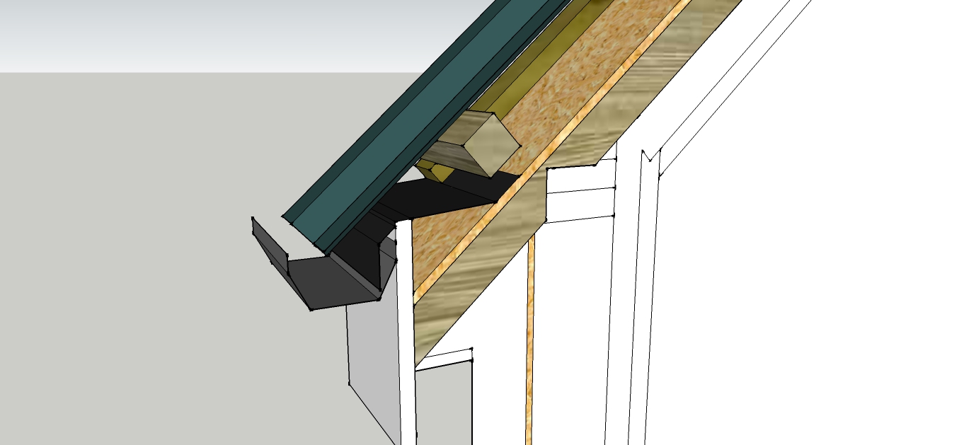

Where does the membrane go..?
Yes I admit the picture might be hard to understand.
Start with a sloping roof with your cross battens on to support the box profile. your bottom batten say 6" up from the bottom of the roof slope.
Now lay something down the roof to represent the box profile roofing.
Offer up your fascia board, with a vent strip on top of it and set it at a heght that almost touches the underside of the roof sheeting (small gap to allow for the infill piece)
Your fascia board will of course now be higher that the bottom of the slope. This is where the eaves tray comes in. The eaves tray fixes to the top of your fascia and creates the kick up slope to meet the main slope of the roof. This tray is made of plastic, and the joint between the fixing and the main part of the tray, is scored, so you can pre bend it to match the angle it has to be at.
Once you have done that mock up you take it all apart, lay the eaves tray first, then the membrane which now kicks up on the tray and over the edge. then fix the vent strip to also fix the bottom end of the membrane, then fix your battens and counter battens.
Making any sense yet?  If it wasn't hissing down I would go and try to get a better picture.
Brilliant, that makes sense now. And also means that I need to fast-track the whole fascia bit.
I had assumed that, having got my sarking on, I could slap on the membrane and be wind/watertight for now, then sort out the eaves detail at a later date.
Third time lucky- what do you make of this interpretation?

Yes that's about it.

Your sketch up pretty well matches my description of what we've done. We used some arras rail from the local timber yard for the 90/45/45 section. The membrane goes over this, and the ventilation strip is pinned to this and the tile /slate sits on top:

So you've effectively got a solid fillet of timber to kick up the angle between the roof and the fascia?
For now, I'm just going to do a temporary tack down at the eaves, because I have loads of building materials arriving soon and need the roof to stop leaking!
For a temporary fixing of the bottom of the membrane, don't nail it directly, fix it down with a batten nailed through and leave the nail heads a bit proud so you can pull them out.
That's what we did.  For a couple of months the main waterproof layer was the membrane -- even though MBC wouldn't warrant this -- but we had absolutely no problems.  Then we lifted the stapling along the eaves edge and fitted the arras rail before the slater started work.  We also wrapped the front face and the underneath is a folded aluminium L section as I discussed recently in another topic.
