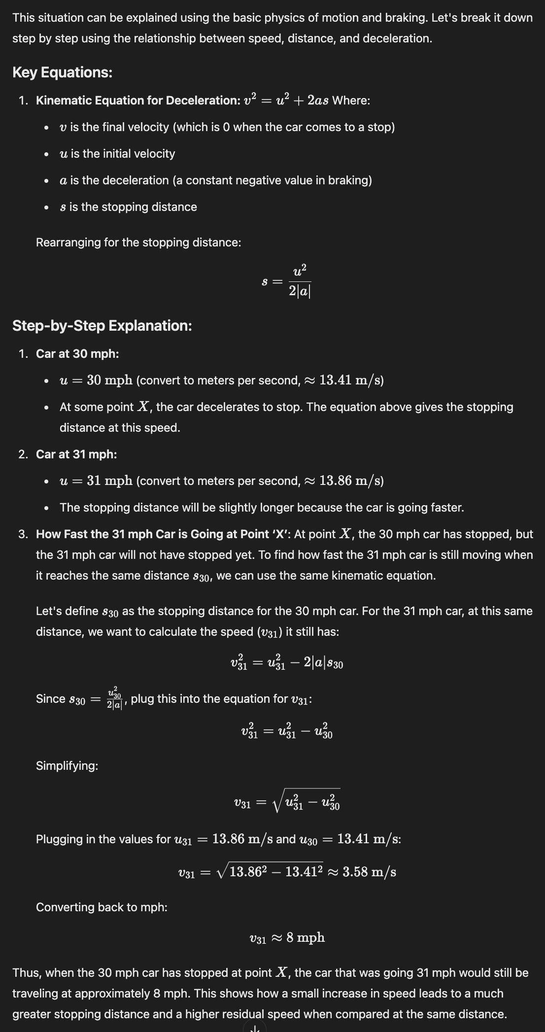

Russdl Posted Friday at 17:07 Share Posted Friday at 17:07 I’ve just been on one of those course you are invited to take instead of 3 points on your driving licence (I was innocent! So were the other 20 people on the course). One element of the course explained that with two identical cars, one doing 30 mph one doing 31 mph braking at exactly the same time the car doing 30mph would stop at point ‘X’. The car doing 31 mph would still be doing 8 mph at point ‘X’. I couldn’t argue that because I don’t know where to start on the maths. Can one of you boffins show me the ‘workings’ of such a sum? Link to comment Share on other sites More sharing options...

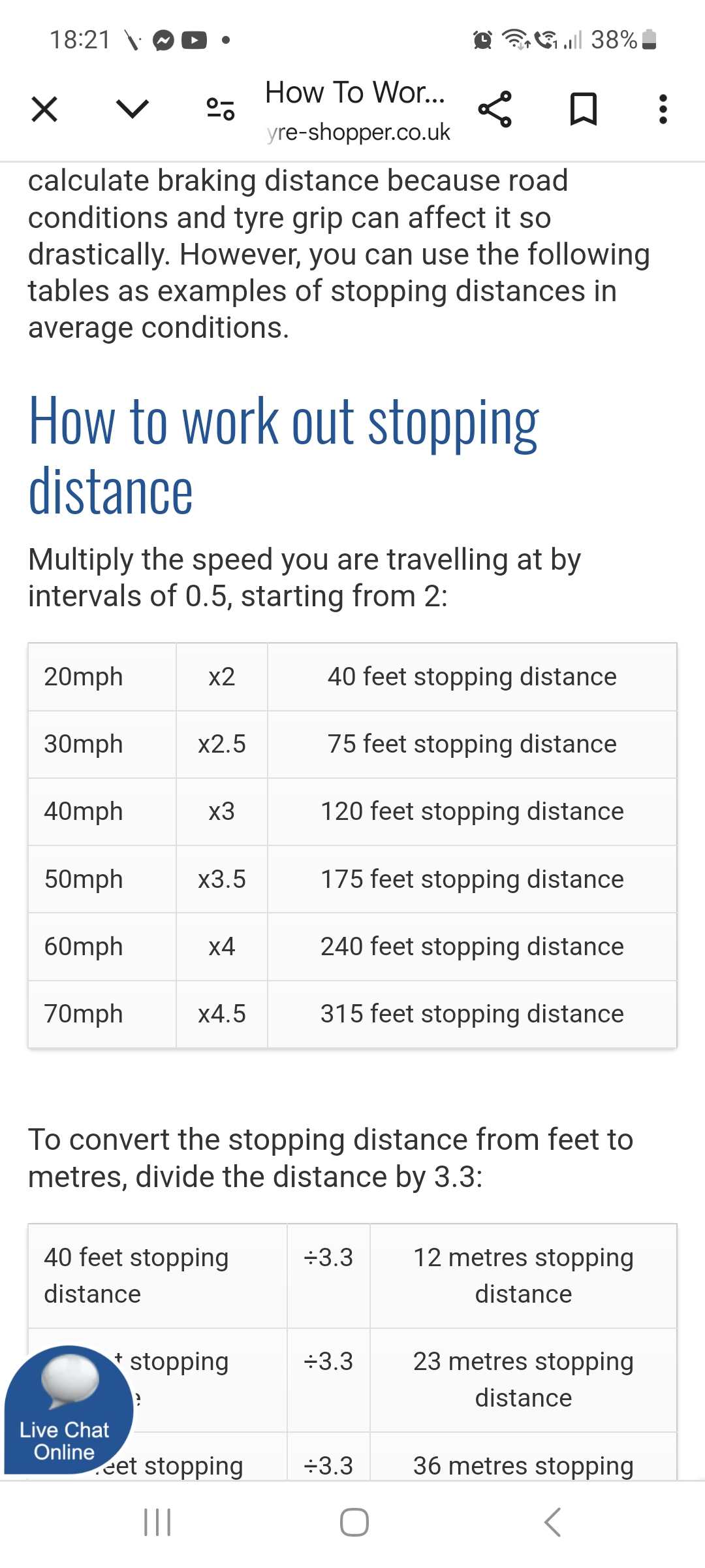

saveasteading Posted Friday at 17:27 Share Posted Friday at 17:27 5 minutes ago, ProDave said: biting your tongue if needed Been there, learnt my lesson. So good I'm doing it again next week. 60,000 miles since the last time, shows that I'm a good person really......is not the sort of thing to say. Yes, people argue pointlessly. Sit still. Answer the most glaringly obvious questions with the 'correct' answer. Watch the taxi driver.....he says as little as possible. At 8mph the remaining stopping distance is going to be, apparently 12 ft. by extrapolating the attached. Link to comment Share on other sites More sharing options...

Russdl Posted Friday at 17:56 Author Share Posted Friday at 17:56 @garrymartin I got lost in the maths there but it would seem they were telling truths. They weren’t talking about stopping distances per se more about how fast you would still be going at the point the ‘compliant’ car had stopped. I was quite surprised. What about the speed of a car at point ‘X’ if it’s doing 35 mph, that’ll be significant I suspect? it sounds like I’m a convert but it is my second course so they haven’t fixed me yet 😔 Link to comment Share on other sites More sharing options...
garrymartin Posted Friday at 18:04 Share Posted Friday at 18:04 7 minutes ago, Russdl said: What about the speed of a car at point ‘X’ if it’s doing 35 mph, that’ll be significant I suspect? 18 mph apparently. Link to comment Share on other sites More sharing options...

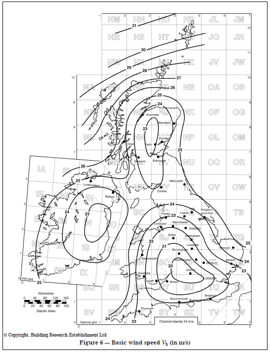

Gus Potter Posted Friday at 20:21 Share Posted Friday at 20:21 1 hour ago, garrymartin said: No AI's were harmed during this answer... I hope not! 1 hour ago, Russdl said: I’ve just been on one of those course you are invited to take instead of 3 points on your driving licence (I was innocent! So were the other 20 people on the course). Of course.. voluntary work is so good for the soul. Ok the maths. I'll relate this to wind load on a house then cut to the chase about driving at hwich I'm a bit not Nigel Masell.. more like Rowan Atchinson.. enough knowledge to be dangerous but without the cash to excecute well. Excuse the spelling and grammer please. Simplistically the wind load on a house is related to the speed of the wind as we know for life experience. The general equation is air mass x the wind speed squared. For interest ( if you have nothing beter to do) I've screen shotted a wind diagram from the BS design code. . For the non mathematical often we can simplify maths by removing things that stay the same.. say the weight of your car. This lets us quickly compare like with like even though the number we get at the end does not equate to say a true real life value that we could then use to design a roof truss say. We can call this a qualitative analysis. In Oxford the basic wind speed is 20 metres per second... about 45 miles per hour (gust speed).. Build Hubbers.. do not use this as a value for your design.. as it then gets modified a lot. In the North of the country it is say 27 - 31 metres per second. Using the equation.. force = mass x velocity squared the two results can be compared in a qualitative manner. That said I hope the wind diagram helps you see how things could change for your house design depending on where you live. If you have big areas of glass then its a consideration.. is the glass and double glazing going to be ok if I live in Cornwall say. The mass of air is the same (except in the far north and the Hebrides where it is rarified by Whisky fumes so is a little lighter) so the "Energy ~ = mass of air * wind velocity squared. Just say the mass of air is 1.0 something units 1.0 * 20^2 = 1.0 * 20 *20 = 400 units. In the North it's 1.0 * 27^2 = 1.0 * 27 *27 = 729 units.. nearly double the force! When explaining to other designers about wind behavoir I often use the car velocity / breaking distances model as an example as most folk can relate to it. If you hit a kid when driving at 20 mph the energy you hit them with is similar to the wind. Your car = say 0.75 - 2 tonnes.. but it's the velocity that causes a lot of damage. Say your car weights 1.0 unit of measure. At 20 mph the qualitative units are mass of your car 1.0 * 20 * 20 = 400 units. At 30 mph it mass 1.0 * 30 * 30 = 900 units. In other words that extra 10 mph matters a lot. The extra 10 mph has more than double the energy. Now it's known that the survival rate for humans rapidly decreases when the intensity of the energy delivery increases if you get hit by something. This is what we call accelerating or braking if you are in the car. When folk go to the moon they get accelerated by a rocket but slowly. Now the driving courses are intended to make sure you stop before you hit anything.. as a kid could then get slowly rolled over by the wheels of you car at 1 -2 mph. The main thing about the above it to recognise that with a small increase in speed you need to exponentially decrease the rate of acceleration. To be frank.. if you hit someone at a couple of miles an hour you are unlikey to cause them organ damage. But as above the collateral damage comes from then running them over with your car or causing them to fall over and then damage their head say from the fall. Now if you are in an airplane.. the guy / doll up front has a big interest in not crashing at any time! At 150 - 300 knots a bit of difference in relative ground speed is not going to make any difference to you not getting squished. The last thing they are wanting to do is to make contact with anything solid or semi solid in the air. 3 Link to comment Share on other sites More sharing options...

Russdl Posted Friday at 21:02 Author Share Posted Friday at 21:02 2 hours ago, garrymartin said: 18 mph apparently. That, I guess, was the point they were trying to make. It resonated with me, especially the 1 mph extra resulting in 8 mph extra at point ‘X’ which could be where the car/bike/person etc is. I was baffled by the 1 mph becoming 8 mph so thanks @garrymartin for confirming that bit of weirdness is a reality. Link to comment Share on other sites More sharing options...
