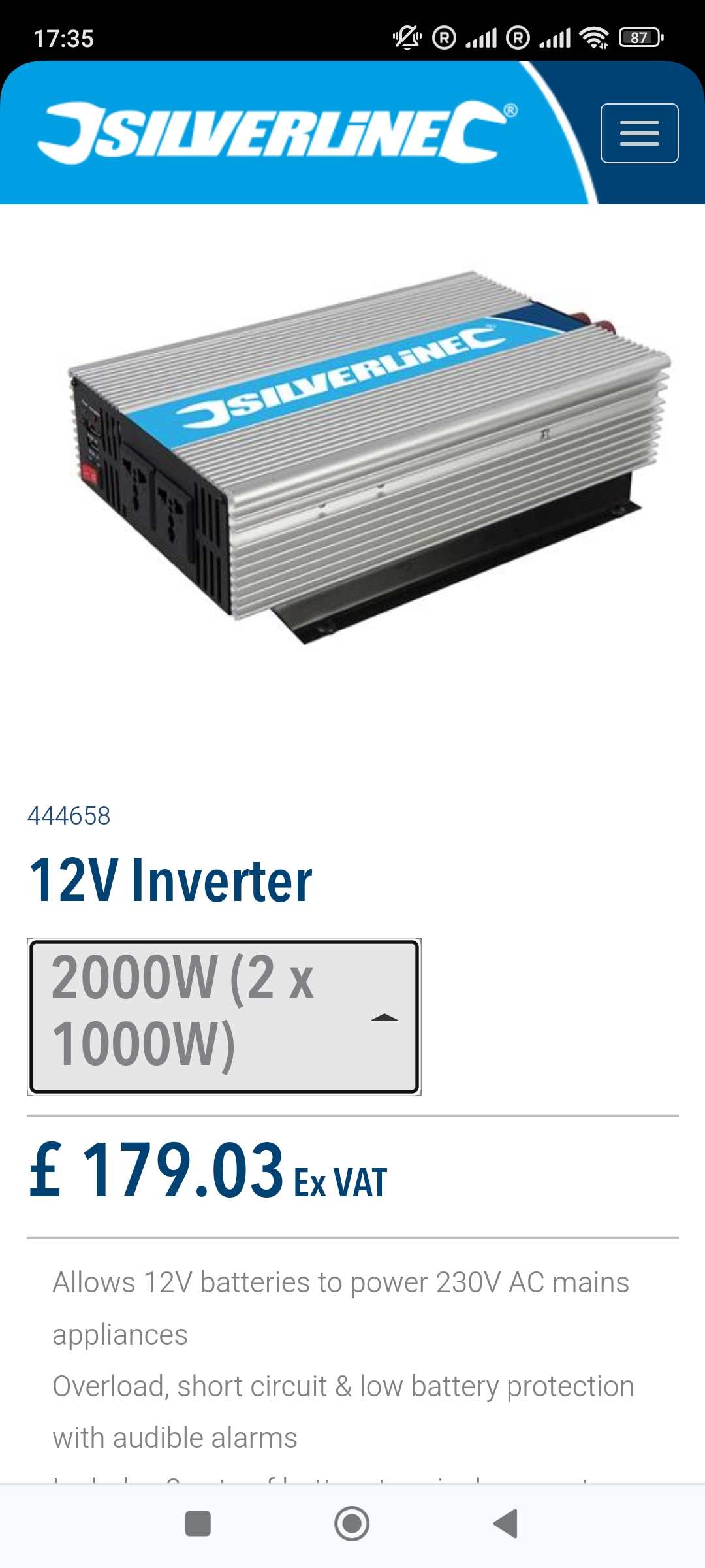

Iceverge Posted September 24 Share Posted September 24 I trialed an inverter coupled to the car battery a few years ago to power the house. A car alternator can be 100A at 14v so 1400w. Plenty for most stuff. It was only a cheap square wave inverter. It worked perfectly for everything with a built in rectifier like TVs and phone chargers. Same for resistive loads like incandescent bulbs, it even made a fair attempt to boil the kettle. However it was not happy with inductive loads like the hob and it didn't play well with LED bulbs. I sent it back and got one for these. I still think a better pure sine wave inverter and quick connectors to the car battery like @markocosic suggested might be a good idea. Maybe add a leisure battery and just charge that from the car a couple of times a day. Link to comment Share on other sites More sharing options...

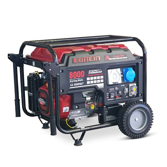

JohnMo Posted September 24 Share Posted September 24 I was just using this initially https://hyundaipowerequipment.co.uk/p1-p10000le-7-9kw-9-8kva-recoil-electric-start-site-petrol-generator-powered-by-hyundai?absrc=Google&abid=&abcampid=20457680345&abgroupid=&gclid=Cj0KCQjwxsm3BhDrARIsAMtVz6OdU063Hh0q_OXZ9cG9n3YoyecXIdDMUai4B6yBIx4tceC0UWEQsz8aAmiLEALw_wcB&abkwdid=&tw_source=google&tw_adid=&tw_campaign=20457680345&gad_source=1 Ran whole house, including LED lights, induction hob and ASHP and borehole pump. Just add a mains change over switch. Link to comment Share on other sites More sharing options...
