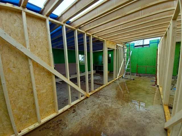

Dave Jones Posted September 8, 2024 Share Posted September 8, 2024 On 06/09/2024 at 21:59, ProDave said: There is something more fundamentally wrong here. That does NOT look like a load bearing wall, there should be a double header. Anyone else care to confirm that or tell me it is okay? correct, should be at a min doubled up studs under it. i'd want written confirmation from the joist supplier that the builders 'method' of fixing the 2 cut halfs is correct. NHBC state multiple studs to be used on load bearing walls. https://nhbc-standards.co.uk/6-superstructure-excluding-roofs/6-3-internal-walls/6-3-5-load-bearing-timber-walls/#:~:text=individual studs%2C rails and head,a maximum of 600mm centres I'd pause and get an SE in, deduct his cost from builder retention, and look over the lot before anything else is covered up. 1 Link to comment Share on other sites More sharing options...
Omnibuswoman Posted September 8, 2024 Author Share Posted September 8, 2024 58 minutes ago, Oz07 said: How many are cut like that? Whats the bottom of that stud sitting on, is the floor below load bearing? There are about 14 of those joists that have been cut. In the photo below you can see the ones that go across the whole length of the house - those are the ones that were cut. You can also see in these pictures the make up of the ground floor supporting walls with only one top plate, and then the joists resting on scraps of OSB because the walls were built short. The sole plates are sat on the load bearing confrere slab. I agree that these don’t look like load bearing walls, but I can’t find any mention in the structural engineering drawings or building regs plans about having a double top plate. i will send the email I’ve written to the builder, and will request a site visit with him and the architect. We may well bring along an independent SE at that point. Sadly we have no financial hold on the builder as we settled the withheld final payment several months ago after the snagging list was complete. These issues have only come to light in the last couple of weeks. Link to comment Share on other sites More sharing options...
Omnibuswoman Posted September 8, 2024 Author Share Posted September 8, 2024 Ps These photos are from Nov 2022 when the structure was going up. The house is now at first fix with all floors complete, roof and windows in place, and eggerboard flooring glued and nailed to the top of the joists, so remediation of some of these issues going to be challenging. Link to comment Share on other sites More sharing options...

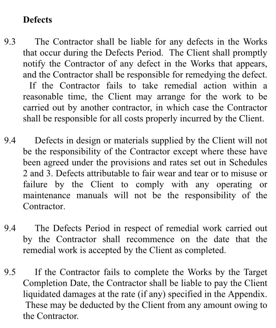

Omnibuswoman Posted September 8, 2024 Author Share Posted September 8, 2024 3 hours ago, saveasteading said: I'd say the contract is for now. What does it say happens in these circumstances? yes, it looks as though this is the relevant part… 1 Link to comment Share on other sites More sharing options...
FuerteStu Posted September 8, 2024 Share Posted September 8, 2024 4 hours ago, Omnibuswoman said: By the time I’ve finished the house, I should just about know enough to build one 😂 This is the way we all end up, but most of us are too terrified to begin the process all over again 😂😂😂 1 Link to comment Share on other sites More sharing options...
saveasteading Posted September 8, 2024 Share Posted September 8, 2024 ...remedial action within a reasonable time.... it says. Perhaps you should suggest what is a reasonable time. I'd suggest you have already given notice and sufficient time for them to consider the remedy. You have now to give a target programme. So...you look forward to his formal proposal by ...date. 23rd September? Which is to include his programme for the remedial works. Failure to do this will result in omnibuswoman considering having the necessary remedial works by another contractor. You the builder will be liable for these costs, consultants and other costs arising, and also liquidated and ascertained damages caused by the delay. I hope it doesn’t come to this and look forward to receiving your constructive proposals ASAP. Something like that, and refer to the contract 2 Link to comment Share on other sites More sharing options...
