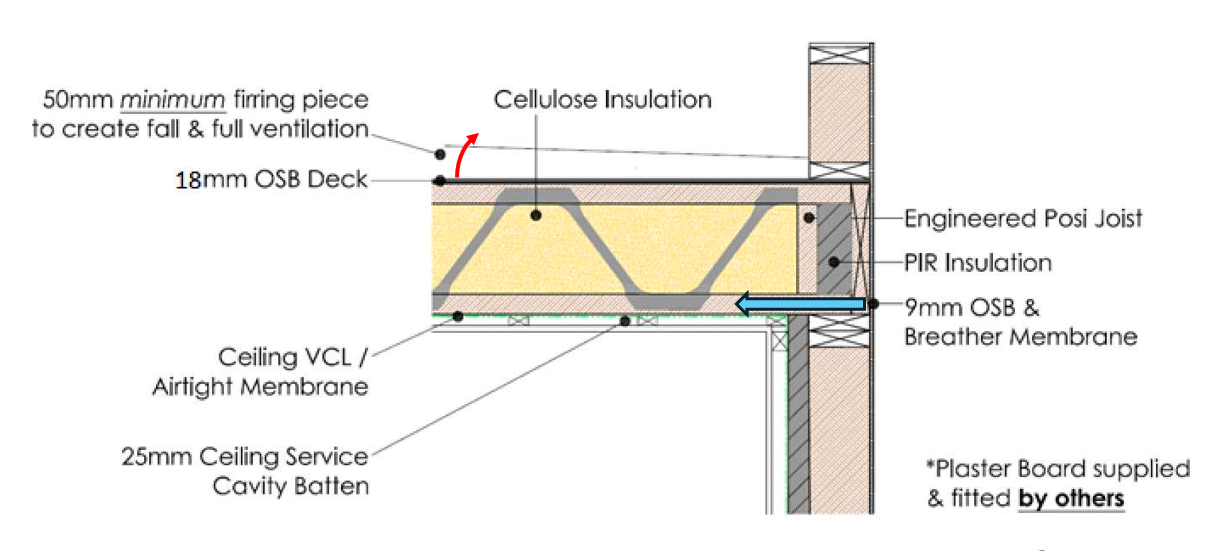

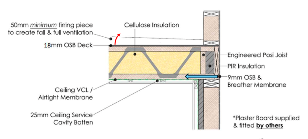

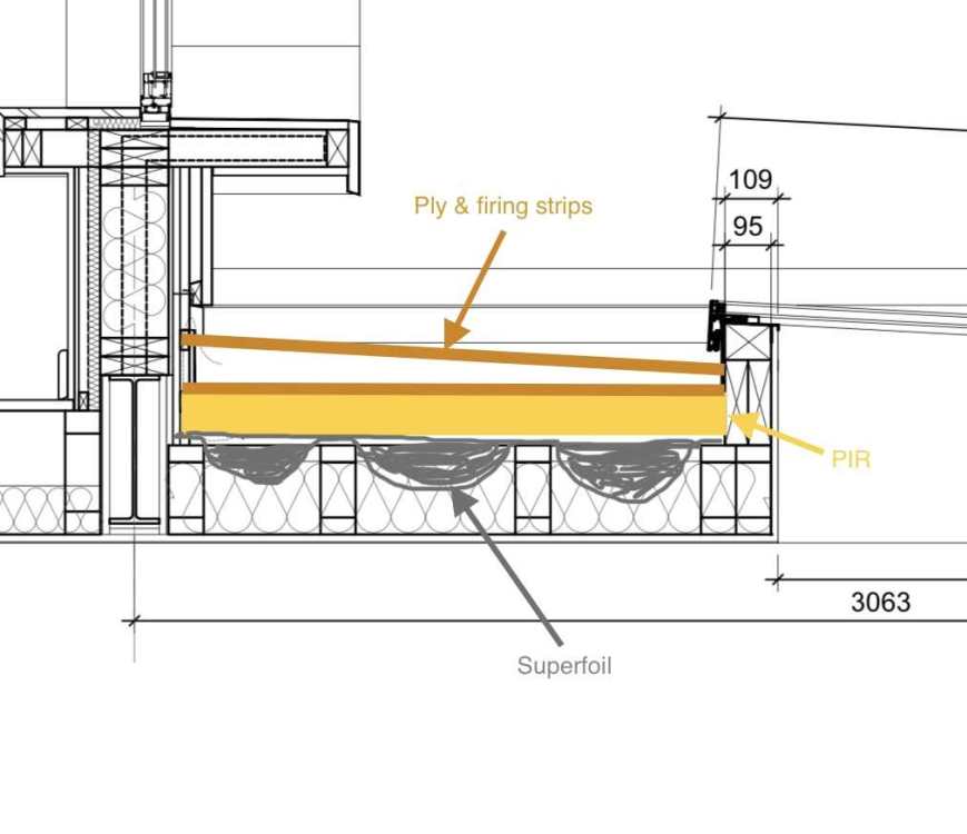

LnP Posted September 4 Share Posted September 4 (edited) I'm interested in comments on this flat roof and parapet detail. 1. Am I right in thinking it's a cold roof? 2. And is the 18mm OSB deck in the wrong place and should it be moved to be on top of the firring (red arrow)? This would give the possibility for ventilation between it and the insulation? 3. What do people think about cold roofs and the risk of condensation if the VCL gets perforated? Is the risk manageable or are warm roofs always preferred, assuming you've space for the additional thickness? 4. What about the cold bridge along the bottom of the joist (blue arrow)? If so, what could be done about that? Thanks Still learning!! Edited September 4 by LnP Link to comment Share on other sites More sharing options...
Redbeard Posted September 4 Share Posted September 4 27 minutes ago, LnP said: 1. Am I right in thinking it's a cold roof? Yes 27 minutes ago, LnP said: 2. And is the 18mm OSB deck in the wrong place and should it be moved to be on top of the firring (red arrow)? This would give the possibility for ventilation between it and the insulation? I don't know, because I do not know what the designer had in mind. One assumes either that it is an incomplete dwg - there is nothing shown above the firrings - or, as you surmise, the OSB is in the wrong place. I always like a howling gale on the top side of a cold roof, although I have seen designs for apparently unventilated, fully-Warmcel-filled roofs, which seem to work OK. As that is drawn I cannot tell whether the 'air gap' has ins and outs (cross-ventilation) anyway. Has the detail been drawn by a company specialising in Warmcel-ins'd roofs? 27 minutes ago, LnP said: 3. What do people think about cold roofs and the risk of condensation if the VCL gets perforated? Is the risk manageable or are warm roofs always preferred, assuming you've space for the additional thickness? Warm roofs are theoretically much better, I feel, but the scope for poor execution due to misunderstanding the concept can be significant. If you get someone who is really good at insulated cold flat roofs you *may* get a better job than asking them to do a warm roof that they have never done before. 27 minutes ago, LnP said: 4. What about the cold bridge along the bottom of the joist (blue arrow)? If so, what could be done about that? Is it really a full-depth thermal bridge, or is the tail of the arrow masking a 'mitigating' piece of insulation? Certainly it wants to be 'cloaked' as best it can. 1 Link to comment Share on other sites More sharing options...
LnP Posted September 4 Author Share Posted September 4 @Redbeard thanks for that. There's nothing hidden by the blue arrow. The stud is 140 mm and as drawn there's already only about 100 mm of the joist sitting on the stud. If the joist was shortened to make room for say 50 mm of insulation, there'll only be about 50 mm of the joist sitting on the stud. Is that enough or is there another solution? Thanks Link to comment Share on other sites More sharing options...
bob the builder 2 Posted September 4 Share Posted September 4 if this is a plan from a well known timber frame suppler... and the upper surface is external then you need to allow ventilation across that top surface between it and the final external membrane IN which case you need to in build another layer of osb on battens to place the final membrane and allow air to flow across this cavity 1 Link to comment Share on other sites More sharing options...
SBMS Posted September 4 Share Posted September 4 We’ve had this exact issue with our flat roof design. We are going with 304mm posi rafters with warmcell for our pitched roof. Originally we were going to do the same with the flat roof portion but then another BH member pointed out the need to ventilate this. Then came the issue that cross ventilation with a parapet wall around the top is incredibly difficult to detail successfully. I decided to switch to a much simpler warm roof design with PIR on top. Any reason you’re not going warm roof for the flat roof? Much easier to detail. 1 Link to comment Share on other sites More sharing options...
DevilDamo Posted September 4 Share Posted September 4 A warm roof is so much better and easier when dealing with flat roof upstands. Assuming that stud on top is forming some kind of parapet? 1 Link to comment Share on other sites More sharing options...
LnP Posted September 4 Author Share Posted September 4 1 hour ago, bob the builder 2 said: if this is a plan from a well known timber frame suppler... Indeed it is .... and one could concluded it's not a good detail. 36 minutes ago, SBMS said: Any reason you’re not going warm roof for the flat roof? Much easier to detail. Just that that was what this timber frame supplier proposes. But I'm asking myself if there's a better way, so yes it looks like that detail would need to be changed. The build up on a warm roof will present a bit of a challenge though. We were planning to make this flat roof a balcony/roof terrace and if we put all the insulation on the top , there will be some head scratching to work out how to avoid a big step up from the FF door onto the balcony. Using shallower joists on closer centres would help but maybe not the full solution. Anybody any further thought on the cold bridging question? Thanks Link to comment Share on other sites More sharing options...

LnP Posted September 5 Author Share Posted September 5 On 04/09/2024 at 20:44, SBMS said: Any reason you’re not going warm roof for the flat roof? Much easier to detail. No reason apart from ignorance 🙂!! I think we'll change it! 23 hours ago, SBMS said: What’s your current joist depth your cold roof is working to - or to put it another way, what’s your maximum height you’ve got for the warm roof make up and the u value you’re trying to achieve? Good question. I don't have that information at the moment. 23 hours ago, ETC said: Go with a warm roof. Good advice which I'm going to follow! 13 hours ago, DevilDamo said: Is there scope to lower the roof for that element so you’ll have a bulkhead below and therefore flush levels at first floor level? The bulkhead could be made out to be a feature too with a coffer for example. Nice idea thanks. A creative solution. We'll give that some thought! Link to comment Share on other sites More sharing options...

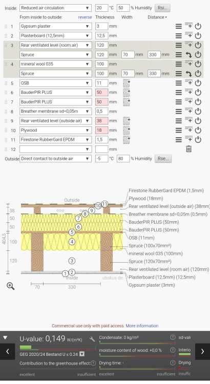

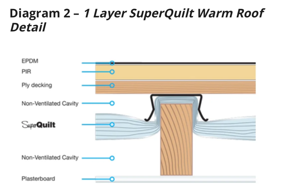

SBMS Posted September 6 Share Posted September 6 If you could reduce your joist depth to 202mm - 2 layers of super quilt plus 40mm PIR making 242mm yields 0.15 u value. All warm roof. We’ve got a 202mm posi joist with green roof loading… alternatively if it’s the Mbc detail then it’ll be a 300mm joist (0.14 u value with cellulose) which you could do with a 202mm with 1 layer super quilt and 80mm PIR. 1 Link to comment Share on other sites More sharing options...
mjc55 Posted September 6 Share Posted September 6 13 minutes ago, SBMS said: If you could reduce your joist depth to 202mm - 2 layers of super quilt plus 40mm PIR making 242mm yields 0.15 u value. All warm roof. We’ve got a 202mm posi joist with green roof loading… alternatively if it’s the Mbc detail then it’ll be a 300mm joist (0.14 u value with cellulose) which you could do with a 202mm with 1 layer super quilt and 80mm PIR. How was the posi-joist sizing in relation to green roof loading? We got a quote for posi-joist some time ago but at that stage we were not specific on roof construction. Link to comment Share on other sites More sharing options...

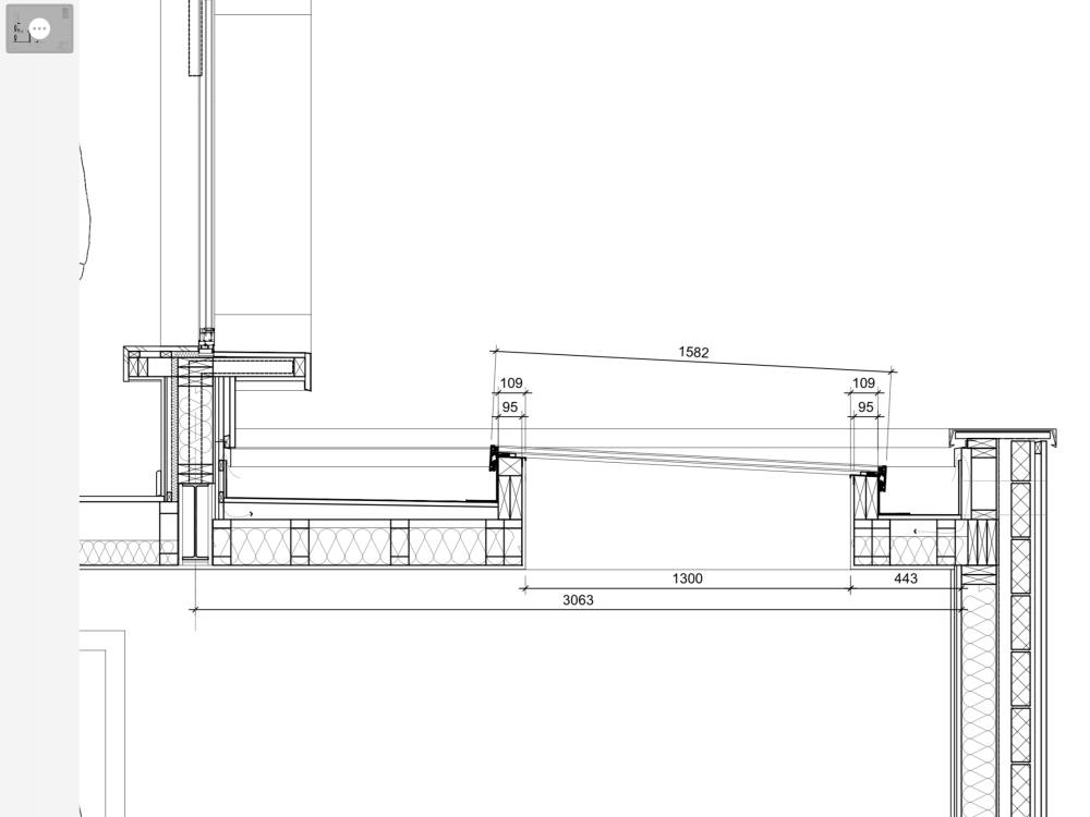

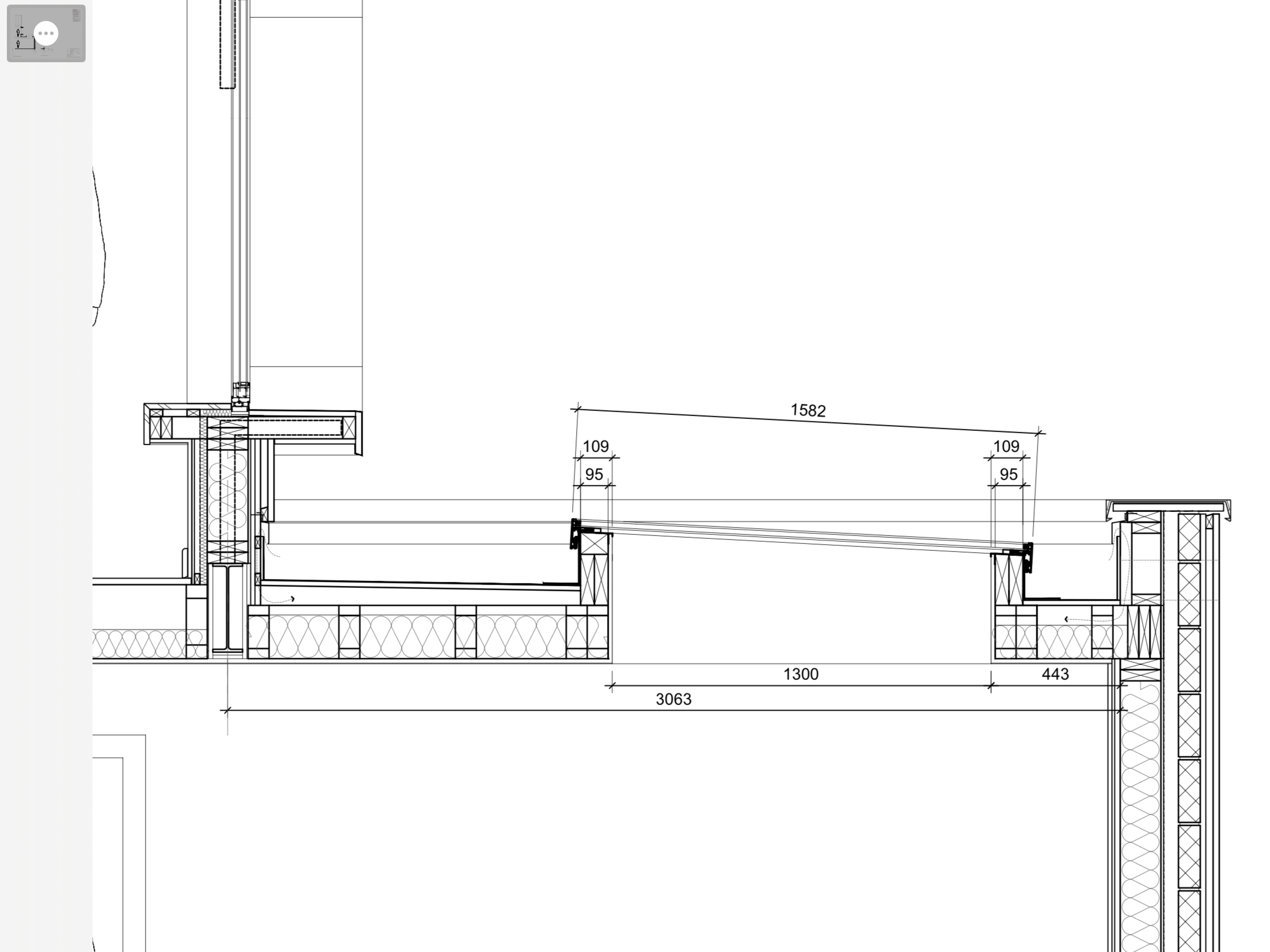

G and J Posted October 4 Share Posted October 4 On 06/09/2024 at 20:06, SBMS said: If you could reduce your joist depth to 202mm - 2 layers of super quilt plus 40mm PIR making 242mm yields 0.15 u value. All warm roof. We’ve got a 202mm posi joist with green roof loading… alternatively if it’s the Mbc detail then it’ll be a 300mm joist (0.14 u value with cellulose) which you could do with a 202mm with 1 layer super quilt and 80mm PIR. So, we are now looking at our flat roof. Architect has suggested cold roof inside parapet so cross flow is not as easy as it could be. Not got the details yet but drawing suggests insulation is within the joists so presumably the assumption is mineral wool stuffed in and around the 202mm posi joists. I think this means at best a u value of 0.17 ignoring the joists, so in reality equivalent to circa 100mm of PIR on top. If we convert to a warm roof do we still need a 150mm upstand to the inside of the parapet? If not then I’ve room for a layer of PIR above the joists. Link to comment Share on other sites More sharing options...
Iceverge Posted October 4 Share Posted October 4 Parapet. Flat roof! Can you design them out?! A cross section would be good of what's proposed. Link to comment Share on other sites More sharing options...
SBMS Posted October 4 Share Posted October 4 (edited) 1 hour ago, G and J said: So, we are now looking at our flat roof. Architect has suggested cold roof inside parapet so cross flow is not as easy as it could be. Not got the details yet but drawing suggests insulation is within the joists so presumably the assumption is mineral wool stuffed in and around the 202mm posi joists. I think this means at best a u value of 0.17 ignoring the joists, so in reality equivalent to circa 100mm of PIR on top. If we convert to a warm roof do we still need a 150mm upstand to the inside of the parapet? If not then I’ve room for a layer of PIR above the joists. A 150mm upstand for skylight? As I understand it that’s the minimum for a rooflight. But your PIR depth isn’t governed by the height of your upstand. Your 150mm upstand is from the finished surface of the roof (ie above your insulation). Edited October 4 by SBMS Link to comment Share on other sites More sharing options...
G and J Posted October 4 Share Posted October 4 2 hours ago, Iceverge said: Parapet. Flat roof! Can you design them out?! Not now. We don’t want to go back through planning. There be dragons! Link to comment Share on other sites More sharing options...
G and J Posted October 4 Share Posted October 4 2 hours ago, Iceverge said: A cross section would be good of what's proposed. Just for you, don’t show anyone else…. I think the joists either side of the roof light are 202mm to give some scale. Link to comment Share on other sites More sharing options...
