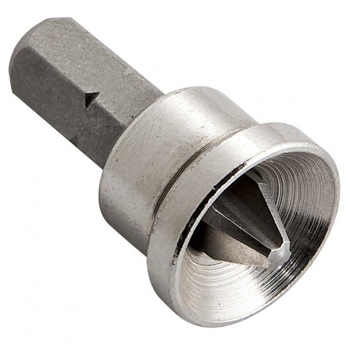

Luckylad Posted December 15, 2017 Posted December 15, 2017 If they're not collated,you have to pick them up out of the box/ pouch and put them on the drywall bit. If you're not using one already make sure you use a depth gauge bit for your drywall driver. I just tried to load an image in here of one but failed !
Nickfromwales Posted December 15, 2017 Posted December 15, 2017 1 hour ago, Luckylad said: If they're not collated,you have to pick them up out of the box/ pouch and put them on the drywall bit. If you're not using one already make sure you use a depth gauge bit for your drywall driver. I just tried to load an image in here of one but failed ! Save the image to your device first, then click the 'click to choose file' button. . You cant paste an image in afaik. Allow me ?
Luckylad Posted December 16, 2017 Posted December 16, 2017 Thanks that worked. This is what I tried to upload. 1
