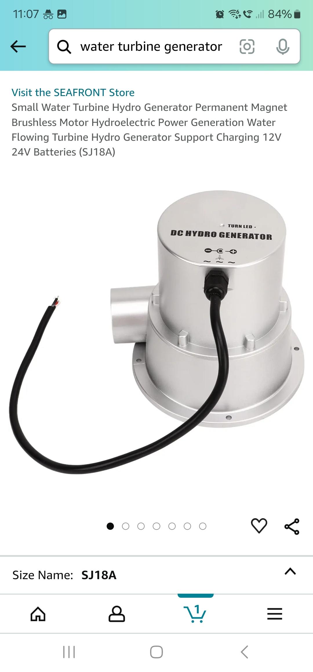

canalsiderenovation Posted July 15, 2024 Posted July 15, 2024 Ok, I know nothing about this but I'm curious to try. We have a small bywash in our garden (some of you may remember me at one time considering a water source heat pump but Canal and River Trust did not take kindly to that idea and we also discovered that when maintenance is done on the canal the bywash doesn't flow) so we couldn't rely on it all of the time. I'd like to see if it is possible to try and use this flow for something such as charging things. We don't have electric nearby (just a small shed) but I'm curious to see if there is any way of generating some kind of power we could use to charge things for example..... Other half who has the electrical knowledge has refused to get involved in such hairbrained ideas so I'm sure buildhubbers can point me into what sort of equipment I may need (and I don't want to spend much otherwise I risk divorce if it doesn't work or I mess something up)! Electrical stuff is not my strong point so you'll need to spell anything out to me in a non technical way..... Video of area (bywash is shallow despite looking quite deep). 20240715_112416.mp4 This is something I'd seen on Amazon not sure if its suitable and what else I'd need.

IanR Posted July 15, 2024 Posted July 15, 2024 1 hour ago, canalsiderenovation said: Ok, I know nothing about this but I'm curious to try. We have a small bywash in our garden It looks like you have a really good flow rate in the bywash, how deep is it? If there's enough depth I'd look at a pelton turbine, or something more like a water wheel, although you'd probably have to build the water wheel. 1
canalsiderenovation Posted July 15, 2024 Author Posted July 15, 2024 3 minutes ago, IanR said: It looks like you have a really good flow rate in the bywash, how deep is it? If there's enough depth I'd look at a pelton turbine, or something more like a water wheel, although you'd probably have to build the water wheel. No, it's not deep at all. Not even knee deep, perhaps a little over ankle deep. I'll measure exactly later.

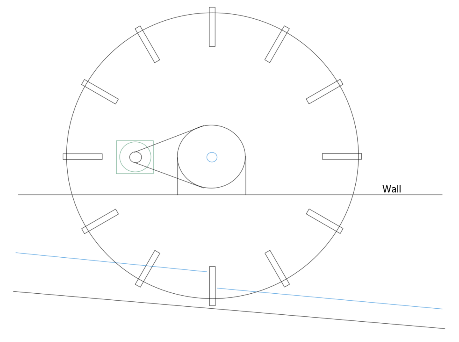

joe90 Posted July 15, 2024 Posted July 15, 2024 My immediate thought was an undershot water wheel, you would need to dam the water slightly which would upset the water level within the canal upstream. 1
IanR Posted July 15, 2024 Posted July 15, 2024 53 minutes ago, canalsiderenovation said: No, it's not deep at all. Not even knee deep, perhaps a little over ankle deep. I'll measure exactly later. That's probably enough. I think it would need a dam either side of the wheel, so that most of the water went under the wheel. If it was a largish wheel, that was geared to spin the generator faster than the wheel itself, the resistance of the wheel would cause the upstream side of the wheel to rise. Something like

canalsiderenovation Posted July 15, 2024 Author Posted July 15, 2024 2 hours ago, IanR said: That's probably enough. I think it would need a dam either side of the wheel, so that most of the water went under the wheel. If it was a largish wheel, that was geared to spin the generator faster than the wheel itself, the resistance of the wheel would cause the upstream side of the wheel to rise. Something like Dam isn't an option as there is a lock the other side of that bridge. Sometimes the flow is more fierce in thr bywash especially when the locks are in operation...
SteamyTea Posted July 15, 2024 Posted July 15, 2024 (edited) Start with the physics. Power (W) = mass flow rate (kg/s) x head (m) x gravity (9.81 m/s²). While the flow rate may seem impressive, the head is only going to be a few millimeters (across a water wheel), so very little usable power. If you know the flow rate in m/s, then you can calculate the most efficient water wheel size as the perfect speed is half the flow rate. So say your flow rate is 3m/s, a 1m diameter water wheel which has a curcumfere of 3.14m, will spin at 30rpm. But, all is not lost. Do you know the height difference between the start and the end of the bywash? If you have over 2m then you could run a pipe from the start to the end, where it then drops the height down to a very small nano turbine (a central heating water pump). Will still be a fraction of a small amount. How about making a scale model of Niagara Falls? With some battery LED lights to make it interesting. Edited July 15, 2024 by SteamyTea 1
