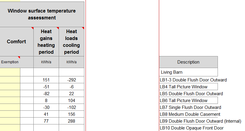

Alan Ambrose Posted July 13, 2024 Share Posted July 13, 2024 >>> PHPP will tell us our heating demand (e.g. 10W/m² heating load), but I'm not aware of it giving a cooling load. Here are the tabs in the PHPP spreadsheet (below) - a bunch for heating / shading / ventilation, a bunch for cooling, and a bunch for overall energy use and HP sizing. Also look at https://passipedia.org/ Your architects should be on top of both heating and cooling. Personally I don't see any environmental problem with running A/C or HP in cooling mode if it is driven by PV. By and large, the heating / cooling balance is governed by the amount of glazing - particularly S, W, E glazing. Little glazing roughly means easy to heat and cool, much glazing means potential heating and cooling problem. You can intervene with shading, external binds, low g glass etc but the amount of glazing is key. I'm wrangling this balance too atm. I'm coming round to the idea that you can somewhat balance winter solar gains (desired) with summer solar gains (somewhat undesired). FYI PHPP has an analysis of positive winter heat gains by window vs. undesirable summer heat gains (bottom image) which I'm trying to fully understand. Link to comment Share on other sites More sharing options...
