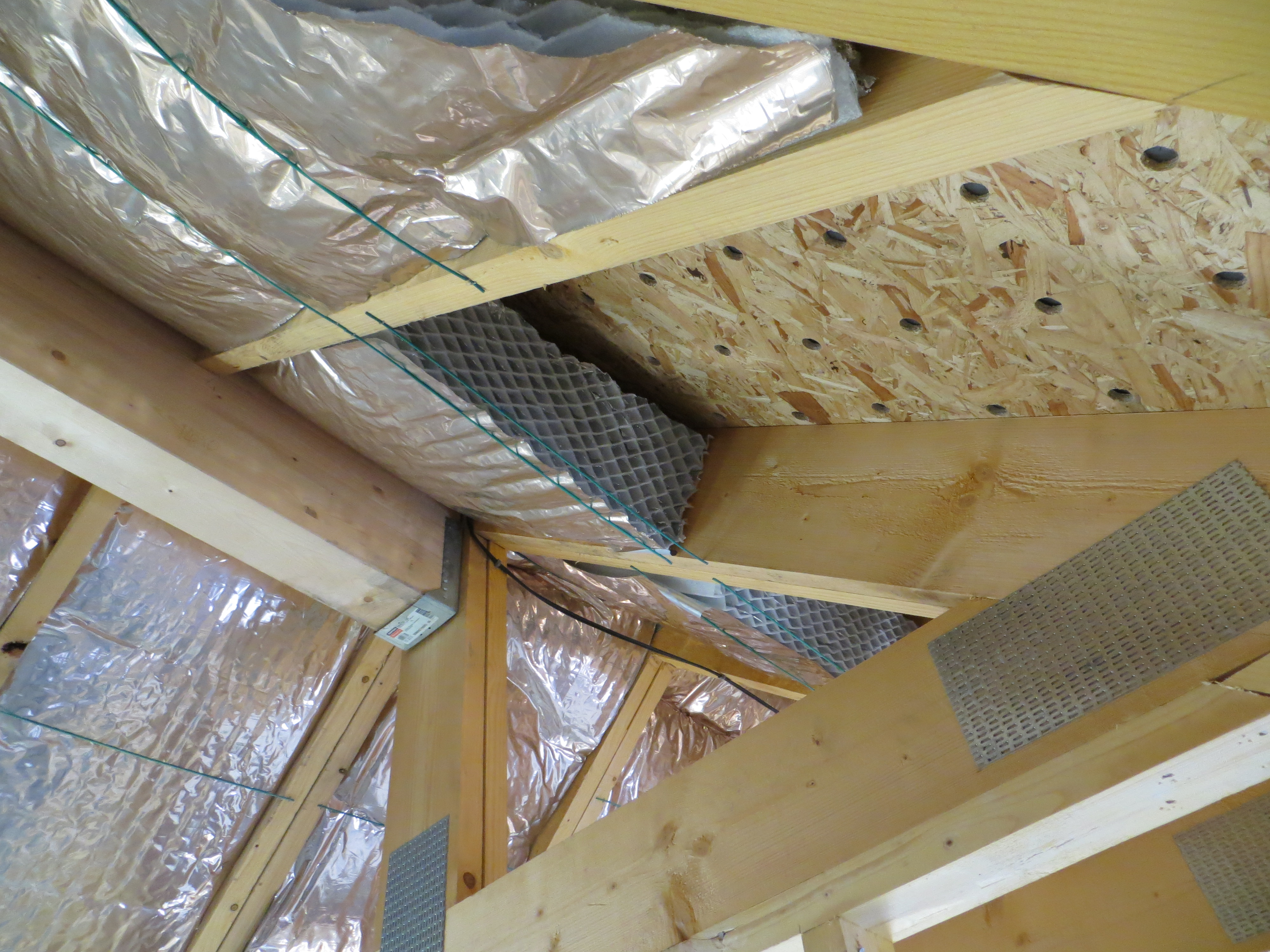

NSS Posted June 13, 2016 Share Posted June 13, 2016 150mm Actis Hybris in situ. Link to comment Share on other sites More sharing options...

NSS Posted June 13, 2016 Share Posted June 13, 2016 Rafters are at 600mm centres and 45mm H-Control is being added over the top (and fully taped), then 35mm counter battens to create service void and to take 15mm plasterboard. Link to comment Share on other sites More sharing options...

ADLIan Posted June 13, 2016 Share Posted June 13, 2016 NSS - OK, just looked to be at 400mm c/c looking at 150mm actis between. Check Actis U-vals against their 'certified' thermal values very carefully. Link to comment Share on other sites More sharing options...
