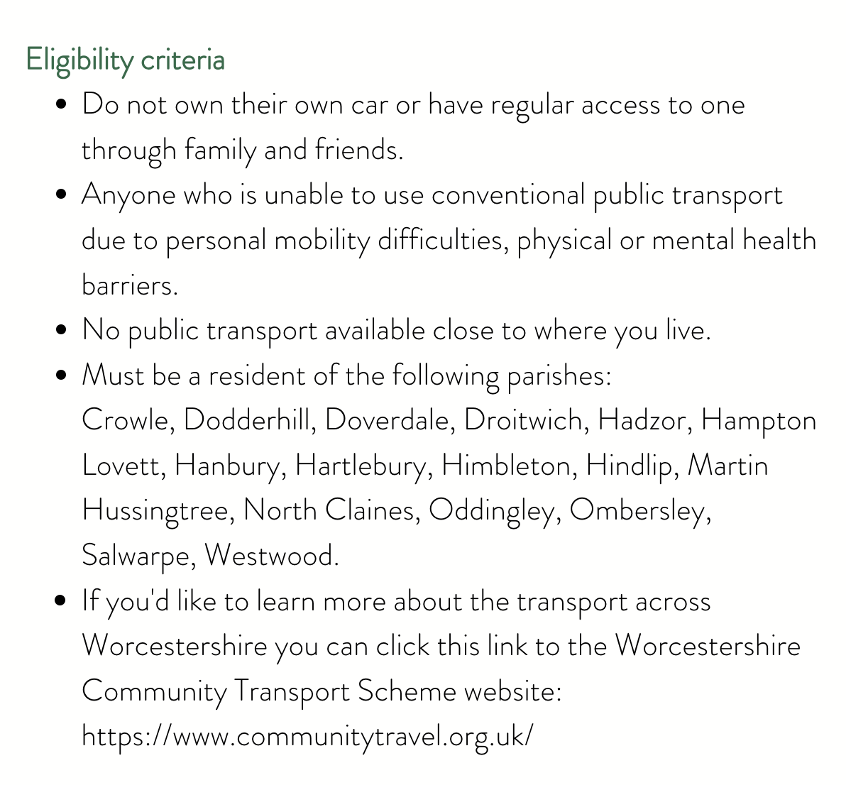

Jilly Posted July 31, 2024 Posted July 31, 2024 I still think it world be easier to start a community bus route 😜 1
garrymartin Posted July 31, 2024 Author Posted July 31, 2024 1 minute ago, Jilly said: I still think it world be easier to start a community bus route 😜 I found out there is one. But one of the conditions for use is that you don't own your own car or have access to one!! 🤣

Jilly Posted July 31, 2024 Posted July 31, 2024 (edited) 1 hour ago, garrymartin said: I found out there is one. But one of the conditions for use is that you don't own your own car or have access to one!! 🤣 Just had to self moderate my reply to that one. Edited July 31, 2024 by Jilly 1
garrymartin Posted July 31, 2024 Author Posted July 31, 2024 1 minute ago, Jilly said: FFS that is stupid Yep.
joe90 Posted July 31, 2024 Posted July 31, 2024 1 minute ago, garrymartin said: FFS that is stupid Too right, how bonkers is that, never mind Labour will sort it all out (puts tin hat on and runs away)…… 1
