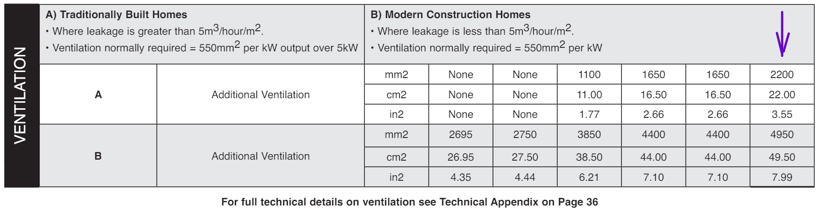

Tetrarch Posted yesterday at 11:01 Author Share Posted yesterday at 11:01 Hi Just by way of explanation. The project has evolved significantly since it started. It is mostly new now eith a brand new insulated room.The diagram below shows the house as it is now Black = Insulated timber frame or BC-complaint 0.17 solid walls Orange = 1970s cavity wall Grey = 1914 solid wall Red = Added insulation In my opinion the house should be very airtight. The fireplace is a retained feature - it was something we wanted to keep and the WBS is as much an aesthetic choice as a secondary heat source Regards Tet Link to comment Share on other sites More sharing options...

IanR Posted yesterday at 11:52 Share Posted yesterday at 11:52 (edited) 56 minutes ago, Tetrarch said: In my opinion the house should be very airtight. "very" will mean different things to different people, but assuming you expect it to be better than 5m³/m².h @ 50 Pa then you need to install the additional ventilation which for your unit needs to be equivalent to a 10cm x 5cm clear hole to outside. With that additional ventilation installed, you'll then need to perform the the "full spillage test " they mention, with all extracts and ventilation running on max. If it passes Building Control should not have an issue. Edited yesterday at 11:58 by IanR 1 Link to comment Share on other sites More sharing options...

Tetrarch Posted yesterday at 13:04 Author Share Posted yesterday at 13:04 1 hour ago, IanR said: "very" will mean different things to different people, but assuming you expect it to be better than 5m³/m².h @ 50 Pa then you need to install the additional ventilation which for your unit needs to be equivalent to a 10cm x 5cm clear hole to outside. With that additional ventilation installed, you'll then need to perform the the "full spillage test " they mention, with all extracts and ventilation running on max. If it passes Building Control should not have an issue. Thank you - that is terrific information. I fully expect that the fire will only be used sparingly. Is it possible to use something like this as a manual vent? I can locate this directly behind the fire to make it invisible, but reachable when it is being used https://www.ebay.co.uk/itm/385765701438?chn=ps&norover=1&mkevt=1&mkrid=710-153316-527457-8&mkcid=2&itemid=385765701438&targetid=4584757337645565&device=c&mktype=&googleloc=&poi=&campaignid=554427144&mkgroupid=1298524317493059&rlsatarget=pla-4584757337645565&abcId=9313282&merchantid=87779&msclkid=67fb7f5074de1dcfd3bb19d2d3237291 Regards Tet Link to comment Share on other sites More sharing options...
IanR Posted yesterday at 13:13 Share Posted yesterday at 13:13 4 minutes ago, Tetrarch said: Is it possible to use something like this as a manual vent? I can locate this directly behind the fire to make it invisible, but reachable when it is being used I don't believe you could install a vent that could be closed off. Link to comment Share on other sites More sharing options...
saveasteading Posted yesterday at 13:21 Share Posted yesterday at 13:21 16 minutes ago, Tetrarch said: something like this as a manual vent? You need a pipe from outside directly into a purpose made socket in the wbs. Link to comment Share on other sites More sharing options...
