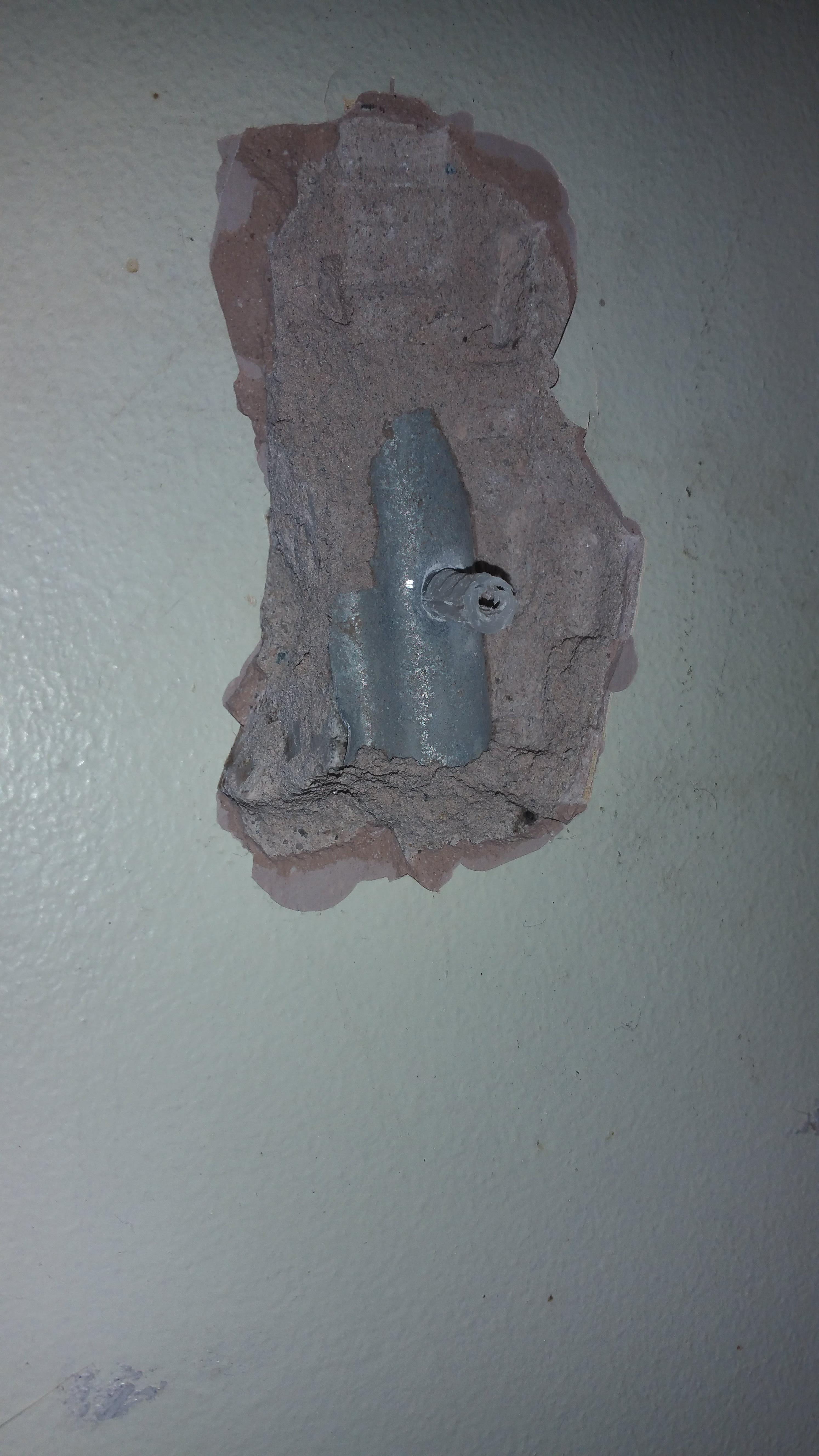

ToughButterCup Posted October 21, 2017 Posted October 21, 2017 Being a responsible builder, I installed our eyewash station in the most used room of the house - the kitchen. Right where everyone can grab it easily and quickly. Put it up, right pleased with myself, until Debbie asked why the kitchen lights weren't working anymore? I've put a screw right through a cable buried in the wall haven't I? Right here..... The right hand screw is the culprit. The mood-o-meter says it all. To repair it, I need to isolate the circuit, prove that it is is dead ( a la John Ward) Dig the cable out, and find the break Then what? Help please....... I know less than anyone in the world about electrics. Thanks Ian 1

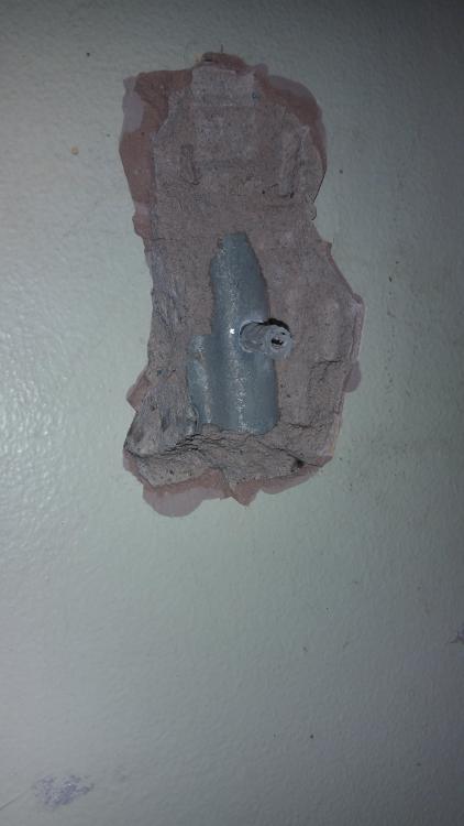

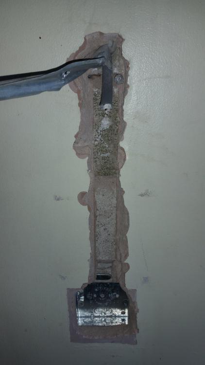

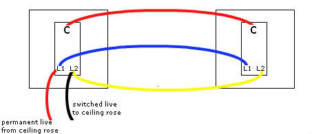

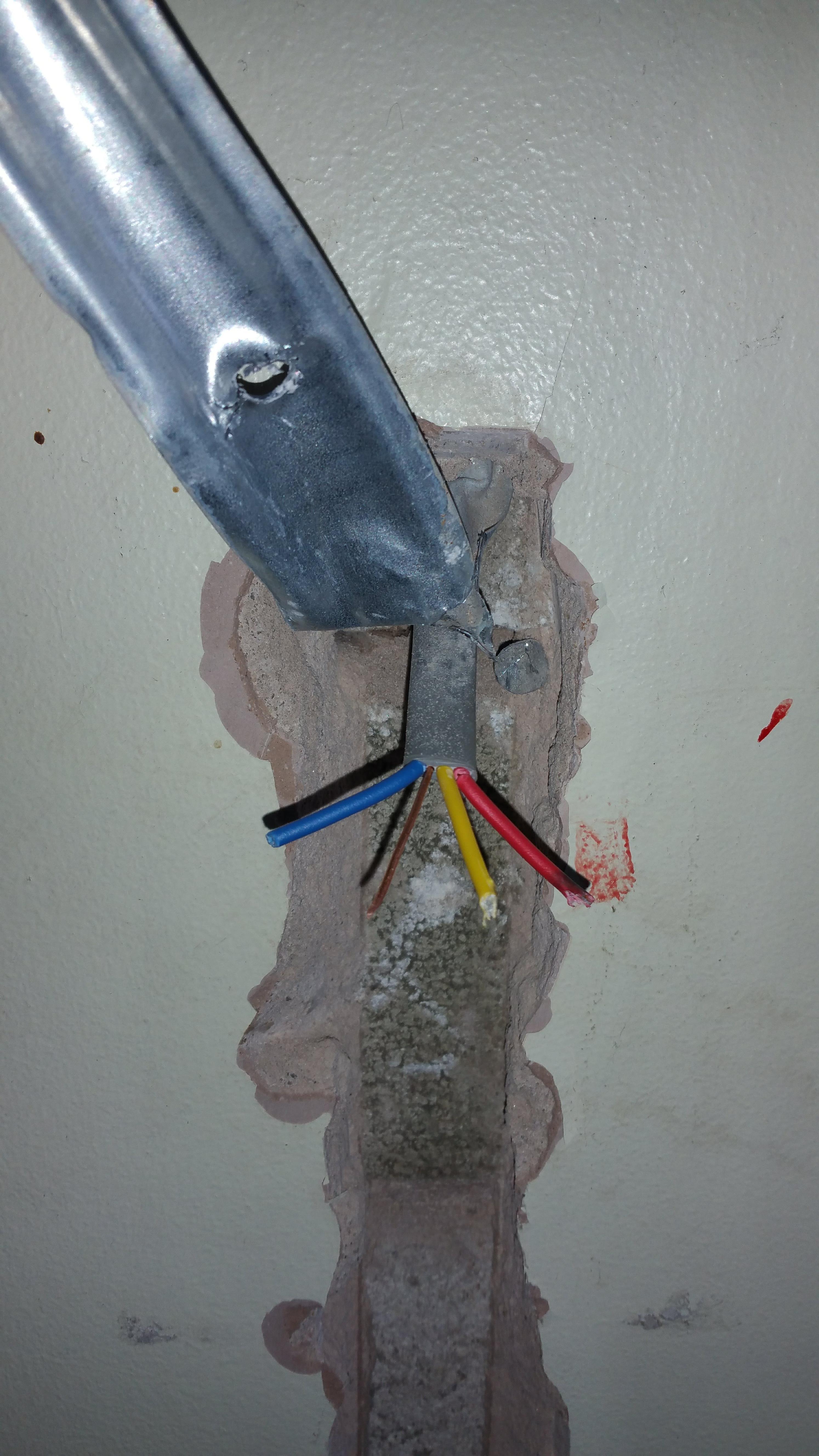

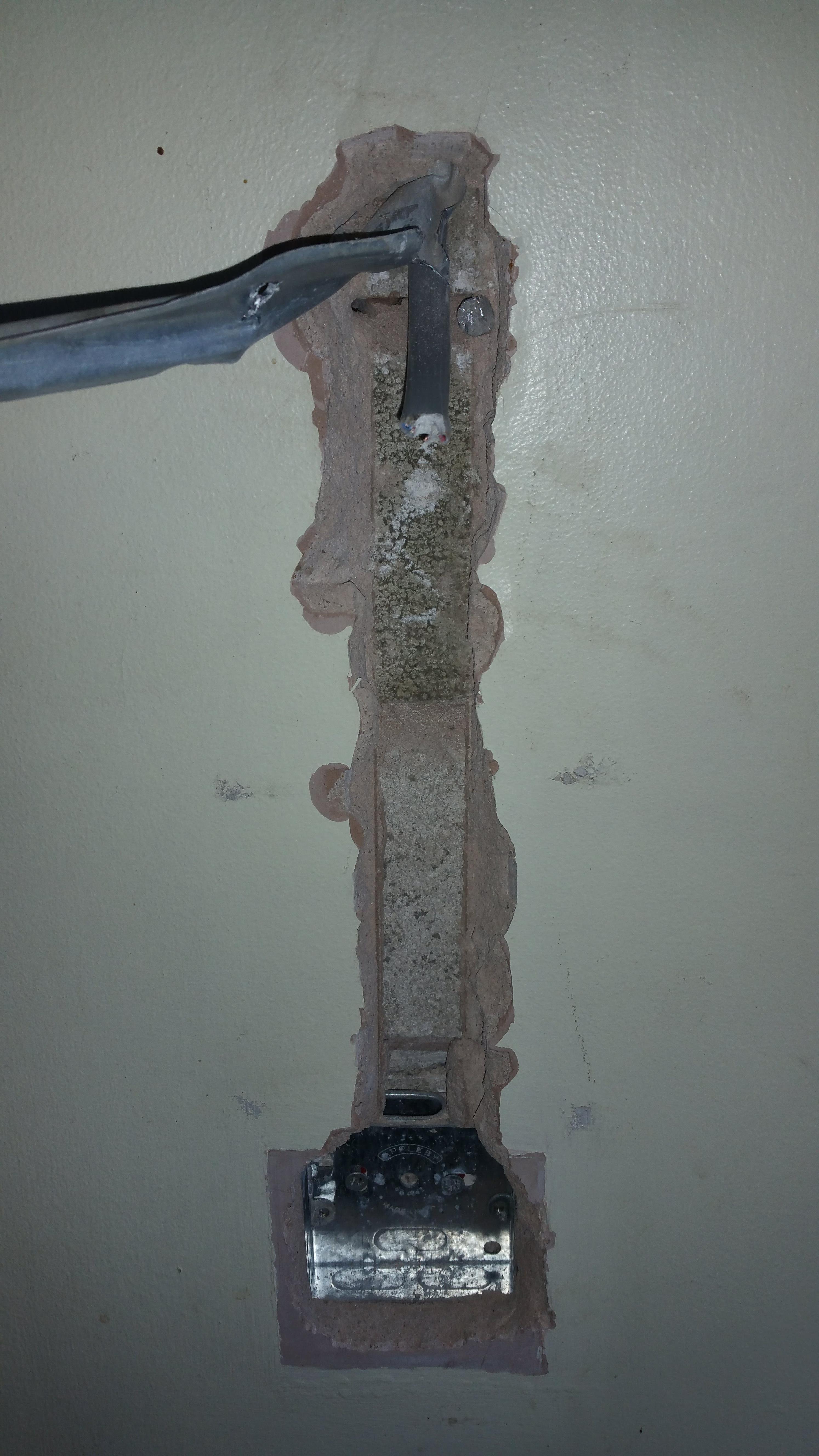

ToughButterCup Posted February 11, 2018 Author Posted February 11, 2018 Rivalling @Onoff's capacity for procrastination, I'm getting round to mending this today... This is what I found Nice one, Ian. Hmmm, stripping it out further, I got to this... Taking it one step further...... Now, remember, I will never know as much as some of you hAve already forgotten about electricity..... But 4 wires? 4 Wires? Whassat about then? In a sense it doesn't matter because all I need to do is crimp a new wire (sleeved) to each end and then poke them into the switch box, connect up and switch on . Innit?
Jeremy Harris Posted February 11, 2018 Posted February 11, 2018 It's a two way switched lighting circuit by the look of it. Just fit a new bit of 3+E and run it to the switch, wiring it as it was before. You'll need 3+E for the new build, even if you don't have two way switched lights, as linked heat/smoke alarms usually need it.

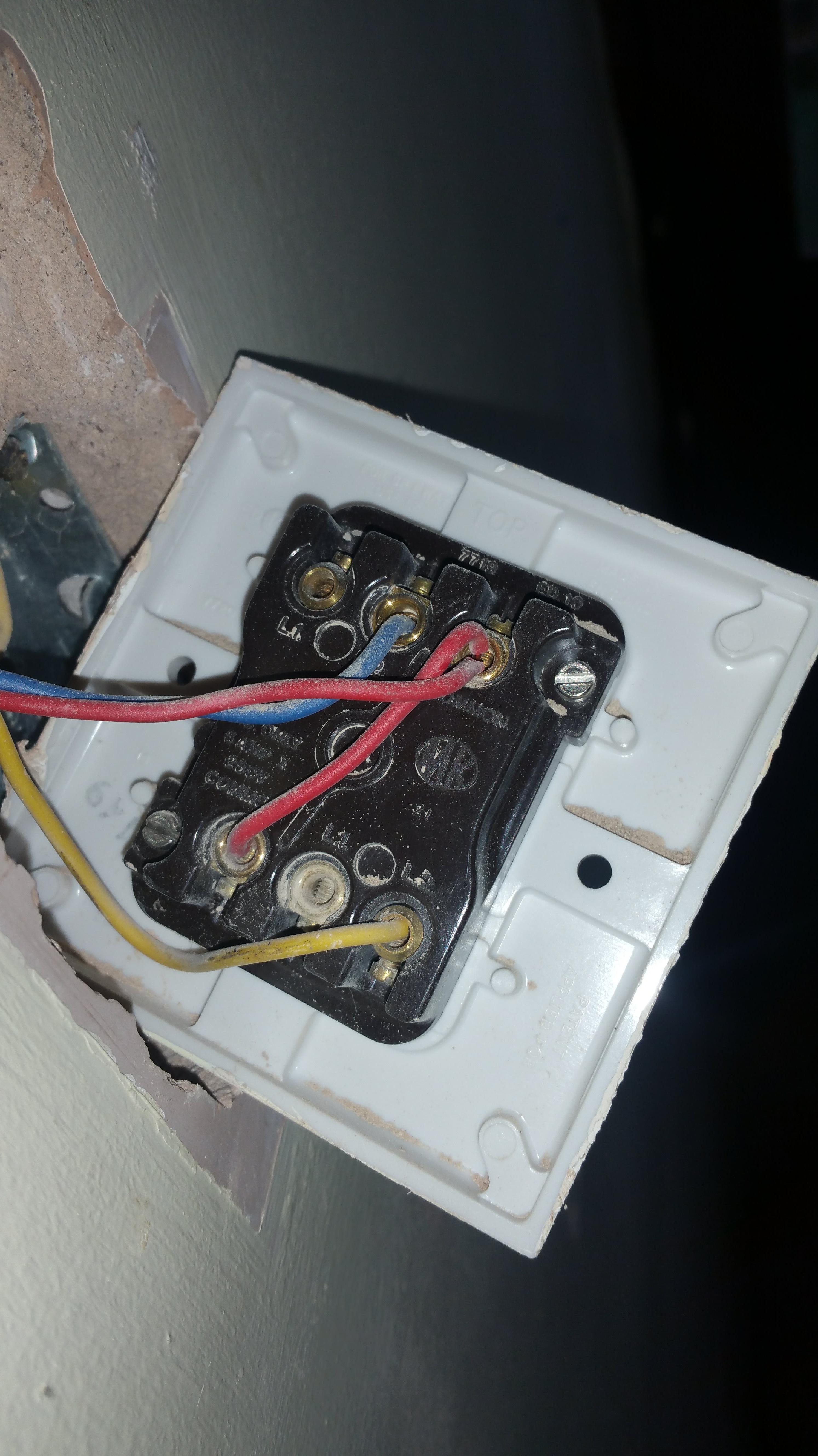

Onoff Posted February 11, 2018 Posted February 11, 2018 TURN THE POWER OFF FIRST! So a two way light switch wired in "old colours", 3-core and earth. This nicked at random off the web: Hopefully the wires are still connected to the switch? If not copy where the wires connect at the "sister" switch. The reason I say this is not everybody follows the colours above. Best bet is if you can haul that bit up and replace. If not some deft crimping.
ToughButterCup Posted February 11, 2018 Author Posted February 11, 2018 3 minutes ago, Onoff said: TURN THE POWER OFF FIRST! [...] Best bet is if you can haul that bit up and replace. If not some deft crimping. Did this before snipping so all I need to do is copy it. 3 and E : off to get a bit from a Shed. I'll try hauling on the end of the bit of wire that I have exposed , if not cut back a good deal more. Thanks for the support, both of you Ian
Jeremy Harris Posted February 11, 2018 Posted February 11, 2018 (edited) Looks like the light switch back box at the bottom of the last photo, so hopefully Ian will have left the wires connected to the switch, so they can be copied when re-wiring it. Edited February 11, 2018 by JSHarris Cross posted!
TerryE Posted February 11, 2018 Posted February 11, 2018 On 21/10/2017 at 13:35, Onoff said: This was to demo joining two bits of T&E, 2.5mm new & old in this case Clive, just noticed this; you are a star, BTW. Ian, You shouldn't have cut the 3+E back to the same height above the rawlplug hole. Look through Clive's example again. You'll need to hack back further now. The joins need to be staggered so that no joins are at the same level. I guess this is a bit like asking Jan about her soldering skills, but you can use twisting the copper plus soldering as an alternative to crimping. You just need to strip back enough to slide the heat shrink beyond the hot bit otherwise it will shrink in the wrong place. And also wrap some wet cloth or kitchen towel around the heat shrink to keep it cool. However you achieve it, the end rest needs to be doubly insulated: once around each phase and once around the lot.
