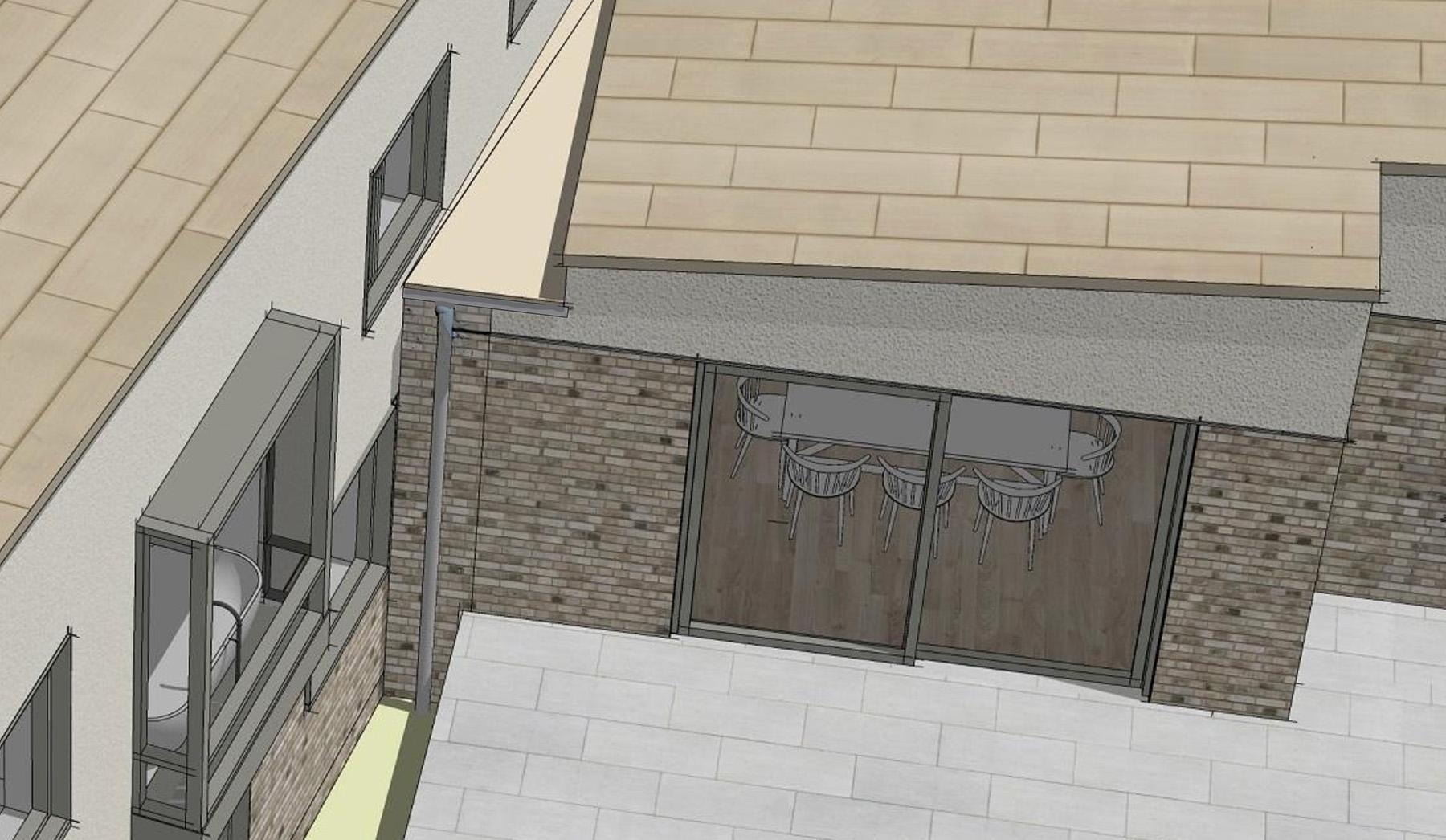

SteamyTea Posted June 20, 2024 Share Posted June 20, 2024 @Mulberry View Have you thought of making up a cardboard model, then you can play around with ideas in read 3D. 1 Link to comment Share on other sites More sharing options...
Sparrowhawk Posted June 20, 2024 Share Posted June 20, 2024 1 hour ago, Mulberry View said: I'm starting to think this roof may have to be open and into a short gutter. I'm fast running out of time. Not an architect and slightly facetious, but: Your main entrance is on the other side of the house This runoff is in a corner next to a patio A climber or large potted plant will hide a short gutter from the patio As a bonus, without a parapet your grandchild gets a better view from the window It's not what you planned for, but it sounds like the easiest compromise at this stage. Plus it's easy to maintain. 2 1 Link to comment Share on other sites More sharing options...
Mulberry View Posted June 20, 2024 Author Share Posted June 20, 2024 1 minute ago, Sparrowhawk said: Not an architect and slightly facetious, but: Your main entrance is on the other side of the house This runoff is in a corner next to a patio A climber or large potted plant will hide a short gutter from the patio As a bonus, without a parapet your grandchild gets a better view from the window It's not what you planned for, but it sounds like the easiest compromise at this stage. Plus it's easy to maintain. I'm starting to think the same way. It's a short section (around 1200mm max), we could have a nice gutter and downpipe on that side. That wouldn't bother me, I guess I just need to understand how the edge would be detailed and if that would look OK. Link to comment Share on other sites More sharing options...
Thorfun Posted June 20, 2024 Share Posted June 20, 2024 2 minutes ago, Sparrowhawk said: Not an architect and slightly facetious, but: Your main entrance is on the other side of the house This runoff is in a corner next to a patio A climber or large potted plant will hide a short gutter from the patio As a bonus, without a parapet your grandchild gets a better view from the window It's not what you planned for, but it sounds like the easiest compromise at this stage. Plus it's easy to maintain. Nice idea. Could potentially look at a rain chain running in to said potted plant? 1 Link to comment Share on other sites More sharing options...
Thorfun Posted June 20, 2024 Share Posted June 20, 2024 1 minute ago, Mulberry View said: I'm starting to think the same way. It's a short section (around 1200mm max), we could have a nice gutter and downpipe on that side. That wouldn't bother me, I guess I just need to understand how the edge would be detailed and if that would look OK. We had lots of compromises and at the time it feels like a really big deal. But after a while you just move on and then it’s like it always was supposed to be and you wonder why it seemed such a big deal at the time! I know I’m not the only one on here to experience that either. 1 Link to comment Share on other sites More sharing options...

Mulberry View Posted June 20, 2024 Author Share Posted June 20, 2024 17 minutes ago, Thorfun said: Nice idea. Could potentially look at a rain chain running in to said potted plant? SWMBO would KILL for a rain chain. Honestly. Link to comment Share on other sites More sharing options...
Kelvin Posted June 20, 2024 Share Posted June 20, 2024 15 minutes ago, Mulberry View said: SWMBO would KILL for a rain chain. Honestly. They don’t really work in heavy rainfall. Wife’s uncle has them on his Huf Haus. Nice looking things but slightly impractical. Link to comment Share on other sites More sharing options...
Mulberry View Posted June 20, 2024 Author Share Posted June 20, 2024 4 minutes ago, Kelvin said: They don’t really work in heavy rainfall. Wife’s uncle has them on his Huf Haus. Nice looking things but slightly impractical. Yes I know. We might end up with one on a little garden building just as a feature to keep 'er indoors happy. 1 Link to comment Share on other sites More sharing options...

Mr Punter Posted June 21, 2024 Share Posted June 21, 2024 Another vote for the gutter. I have used Guttercrest for aluminium gutters and I am very happy with them. If the roof is going to be zinc, you could stick to zinc. Expensive though. I have seen the top hung posis in the manual. The only issue may be that the strut should overhang the bearing by 15mm, but if the supplier did the design and calcs to prove it works, then all is good. 1 Link to comment Share on other sites More sharing options...
Mulberry View Posted June 21, 2024 Author Share Posted June 21, 2024 1 hour ago, Mr Punter said: Another vote for the gutter. I have used Guttercrest for aluminium gutters and I am very happy with them. If the roof is going to be zinc, you could stick to zinc. Expensive though. I have seen the top hung posis in the manual. The only issue may be that the strut should overhang the bearing by 15mm, but if the supplier did the design and calcs to prove it works, then all is good. Pasquill designed the scheme and it was cross checked by my SE. 45mm bearing is all that was needed. I am almost resigned to gutters now, they are only short lengths and I'd like to beautify them as much as possible ideally with Zinc details/flashing etc. I just need to understand from the Zinc contractor whether he needs to come before the single-ply membrane goes on because there is a 'for and against' regarding who comes first. Link to comment Share on other sites More sharing options...
Kelvin Posted June 21, 2024 Share Posted June 21, 2024 (edited) You need something that works and is worry free and gutters seems the easiest solution. On the ‘what gets installed first’. I had exactly the same debate. The consensus between the metal roofers, the membrane installers and some other advice was the membrane gets fitted first. The problem this creates is maintenance down the years as you can’t get to it. Edited June 21, 2024 by Kelvin 1 Link to comment Share on other sites More sharing options...
Thorfun Posted June 21, 2024 Share Posted June 21, 2024 1 hour ago, Mr Punter said: Another vote for the gutter. I have used Guttercrest for aluminium gutters and I am very happy with them. If the roof is going to be zinc, you could stick to zinc. Expensive though. 43 minutes ago, Mulberry View said: I am almost resigned to gutters now, they are only short lengths and I'd like to beautify them as much as possible ideally with Zinc details/flashing etc. I just need to understand from the Zinc contractor whether he needs to come before the single-ply membrane goes on because there is a 'for and against' regarding who comes first. zinc guttering isn't necessarily stupidly expensive! I fitted zinc gutters to our place and, yes they're a lot more than plastic, but totally worth it and not amazingly more than aluminium guttering. some pictures and details of where we got ours from in 1 Link to comment Share on other sites More sharing options...
Kelvin Posted June 21, 2024 Share Posted June 21, 2024 Our Lindab metal guttering was dearer than the zinc quote. Neither was that dear. This was driven by energy prices apparently as zinc takes less energy to make. What the supplier told me anyway. 2 Link to comment Share on other sites More sharing options...
Mulberry View Posted June 21, 2024 Author Share Posted June 21, 2024 I mean, I'm literally talking about 3 linear metres or so of guttering here, its not going to break the bank! I just want to have it detailed better than a plastic soffit board behind it etc. Link to comment Share on other sites More sharing options...
Mulberry View Posted June 21, 2024 Author Share Posted June 21, 2024 16 minutes ago, Thorfun said: zinc guttering isn't necessarily stupidly expensive! I fitted zinc gutters to our place and, yes they're a lot more than plastic, but totally worth it and not amazingly more than aluminium guttering. some pictures and details of where we got ours from in Without wanting to get all mushy over some guttering, that looks delightful. 1 Link to comment Share on other sites More sharing options...
Thorfun Posted June 21, 2024 Share Posted June 21, 2024 2 minutes ago, Mulberry View said: Without wanting to get all mushy over some guttering, that looks delightful. thank you. my first time fitting guttering. I was very happy with the outcome. 🙂 1 Link to comment Share on other sites More sharing options...
saveasteading Posted June 21, 2024 Share Posted June 21, 2024 3 hours ago, Mulberry View said: almost resigned to gutters now, It's like being reluctant to have a roof. Gutters and downpipes are the only right answer. Lindab is elegant and precise. I've got about 12m of it with special bends. 15 years on still looking good. Just think carefully on the position for the downpipe, and choose a colour to blend or contrast. 1 Link to comment Share on other sites More sharing options...
