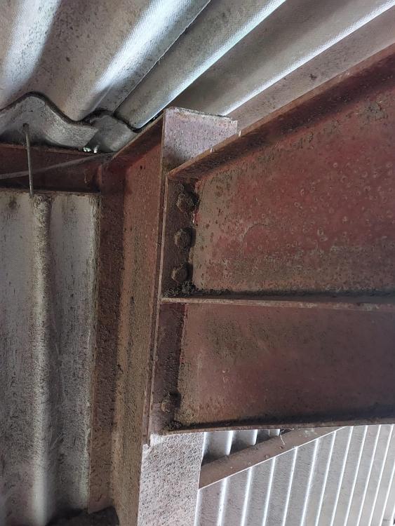

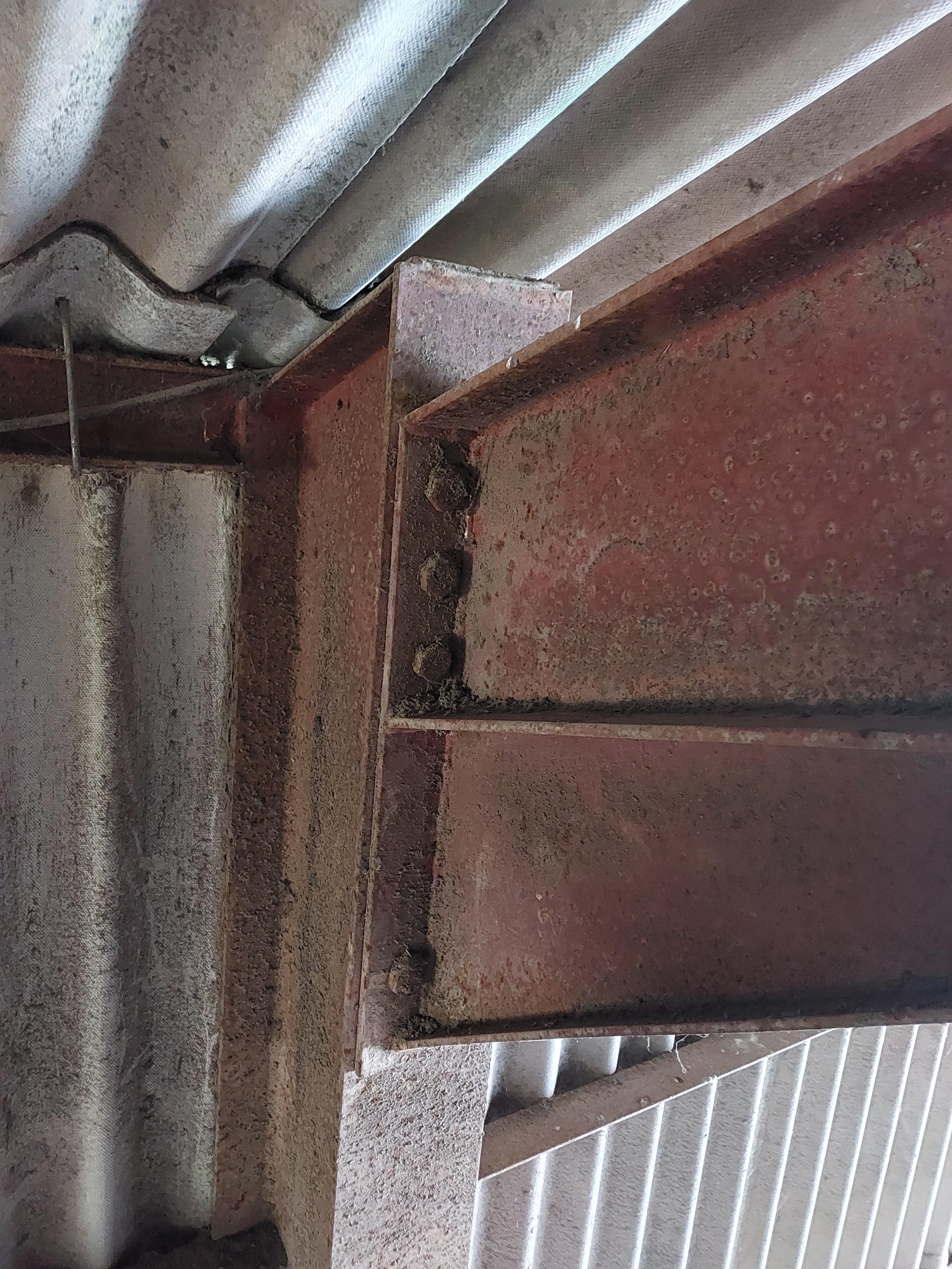

saveasteading Posted June 2, 2024 Posted June 2, 2024 34 minutes ago, joe90 said: What’s the difference It gets hot. There should be 3 turns beyond the nut, Irs probably a tough cut Corrosion, as above. It possibly can't be turned off again. 38 minutes ago, joe90 said: What’s the difference They come in multiple choices of length for choice and to not waste steel, and to not stick out too far. Buy the right length. 31 minutes ago, JohnMo said: I came from a different direction RAF, And planes are pegged together? Certainly that seems to be how a glider wing is fixed. Here is something i was surveying last week. A steel portal frame. At this joint, if the wind lifts the roof, then the bottom bolts go into tension, and lots of it. With normal downward loading the rafter tries to rotate around the bottom of the haunch and the top bolts go into tension. With no nut it simply doesn't work Oops. I am on the wrong device....photo to follow..
