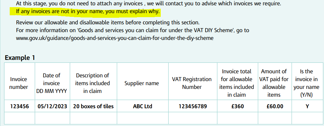

LnP Posted May 14 Share Posted May 14 7 hours ago, Blooda said: In the covering letter to HMRC, any receipts invoices that had Tradesman's name on [almost always made sure the postcode was on somewhere.], were highlighted with a note saying, "it was a trade account, I paid, I can supply matching Credit card statements if you need to check]. I think I recall Andrew Jones (The VATMAN) cautioning against this. IIRC his advice is that the name on the invoice has to link directly to your build. Link to comment Share on other sites More sharing options...

Blooda Posted May 15 Share Posted May 15 12 hours ago, LnP said: I think I recall Andrew Jones (The VATMAN) cautioning against this. IIRC his advice is that the name on the invoice has to link directly to your build. Cautioning against, yes. But it can be interpreted that the name has to be on the invoice, and not necessarily, the account holder:- From HRMC:- You must have a VAT invoice for all the eligible goods you claim for. The goods must have been supplied to you and we may ask you to prove you have paid for them. The VAT invoice will need to show: -the supplier’s name, address and VAT registration number -date of issue -the quantity and description of the goods -your name and address if the value is more than £250 -the price of each item showing the VAT treatment I supplied invoices from several suppliers, Including Howdens and Travis Perkins, from tradesman's accounts. These always had our name and site address on them somewhere, either in the notes, reference or delivery address. Highlighted these in the covering letter, explaining the supplier was trade only [I did throw a bit of COVID into the wording] and my tradesman had ordered and I paid, and I could supply credit card statements to validate. I got paid the claim and they did not want to see credit card statements. I did fail to mention, the tradesmen wanted to stay under the VAT Threshold 🤔 1 Link to comment Share on other sites More sharing options...
