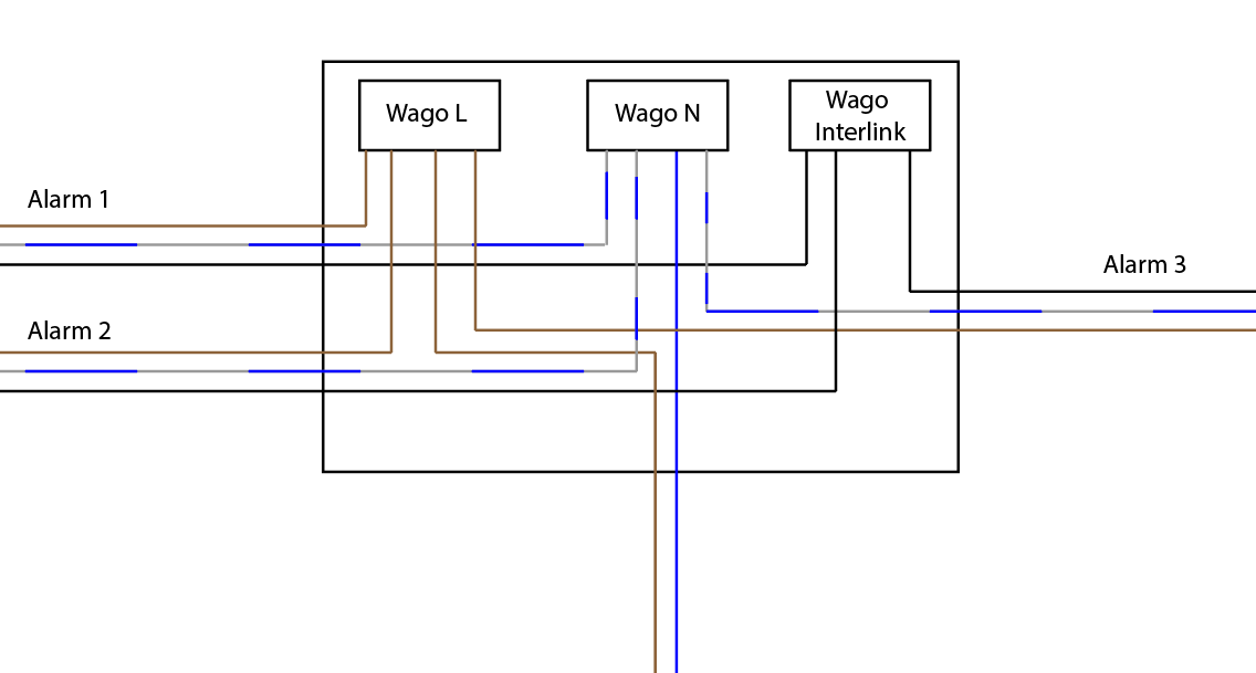

Super_Paulie Posted May 8, 2024 Posted May 8, 2024 afternoon. Is there any particular reason why i couldnt use a central junction location to distribute my phase, neutral and interlink to my smoke alarms? My reasoning being that i would rather not have to remove final flooring in the future to get to the back of the alarms to chain it to a new one, i could have a Wago enclosure or similar in an easy to access location say under a hatch in the landing. So i can get all my new alarms in now in the new side of the house and in the future i could add in new to the existing part without having to pull all the new floors up. BC are happy with my proposed locations to LD3 but i would in the future add more to upgrade to LD2.
ProDave Posted May 8, 2024 Posted May 8, 2024 No reason why not, but I would not. I would just run cables to the ones you can with a spur running off ready for the next stage, long enough to reach it's eventual destination and terminated so it is safe until you are ready for the next phase of the job.

Super_Paulie Posted May 8, 2024 Author Posted May 8, 2024 I guess i could just add and leave cables and then connect to them with Wago when the time comes, it's just adding joints whereas I thought the central location might have been the better option for future expansion and less joints in the system.
FuerteStu Posted May 8, 2024 Posted May 8, 2024 I've not refurbished the kitchen yet.. But I've already fitted the three smokes in the utility (boiler and washing machine) and the upstairs hallway.. I left a loop in the middle of where the kitchen will be, right above where I've cut a hole that is temporarily plugged. When I fit out the kitchen, I'll pull the loop down and cut and terminate the head then. It means it's in one radial and they're all linked.
