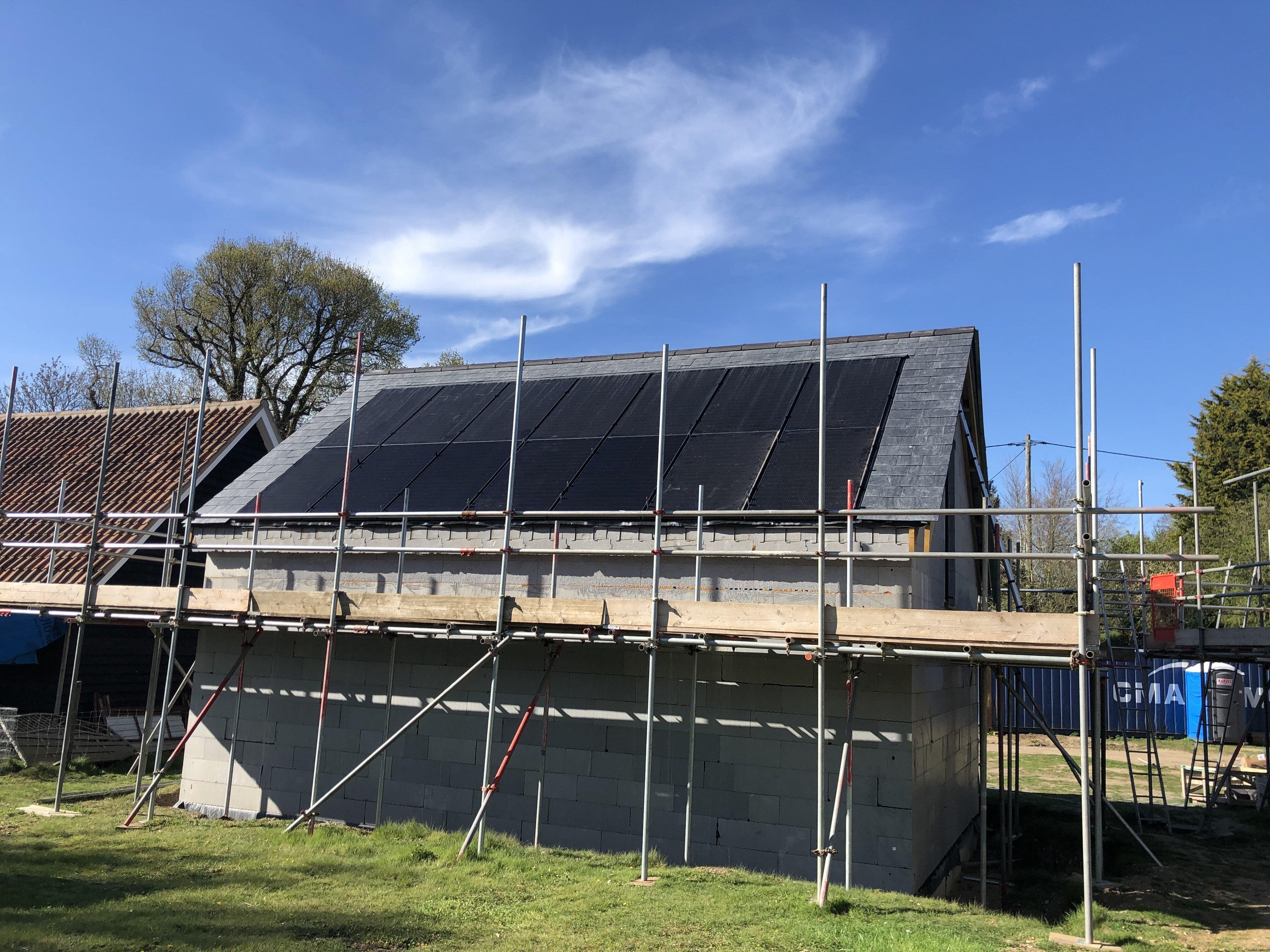

Nick Laslett Posted May 5 Share Posted May 5 3 hours ago, AppleDown said: Just seen the latest Skill Builder video where they attach the panel directly to the battens and then add some fitted flashing: Has anyone used that or know what system it is? Looks a complete pain if you need to switch out panels or access behind it though. My plan is still to use GSE trays, but happy to be swayed... I used the GSE in roof system for my install, very simple. When I looked at the Viridian system, there were specific panels it was specced for. I had already bought 2 panels for the first phase of my build, so these panels wouldn’t work with Viridian system. It is surprising how many different sizes there are of solar panels. 1 Link to comment Share on other sites More sharing options...

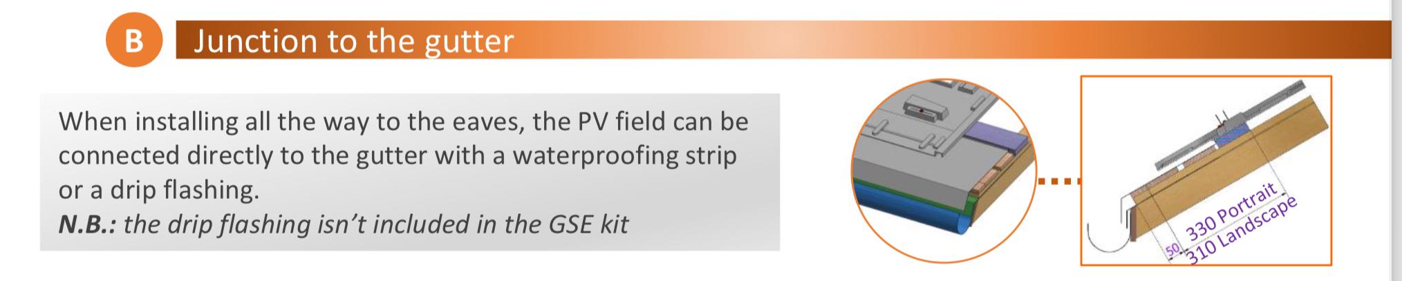

LiamJones Posted May 6 Share Posted May 6 @Nick Laslett I see you’ve ran the gse trays up to the eaves. What flashing/tray did you use to bridge this? Standard eaves trays are too small for the gap specified in the gse manual. 330mm. Considering using lead now. Or custom Ali trays Link to comment Share on other sites More sharing options...

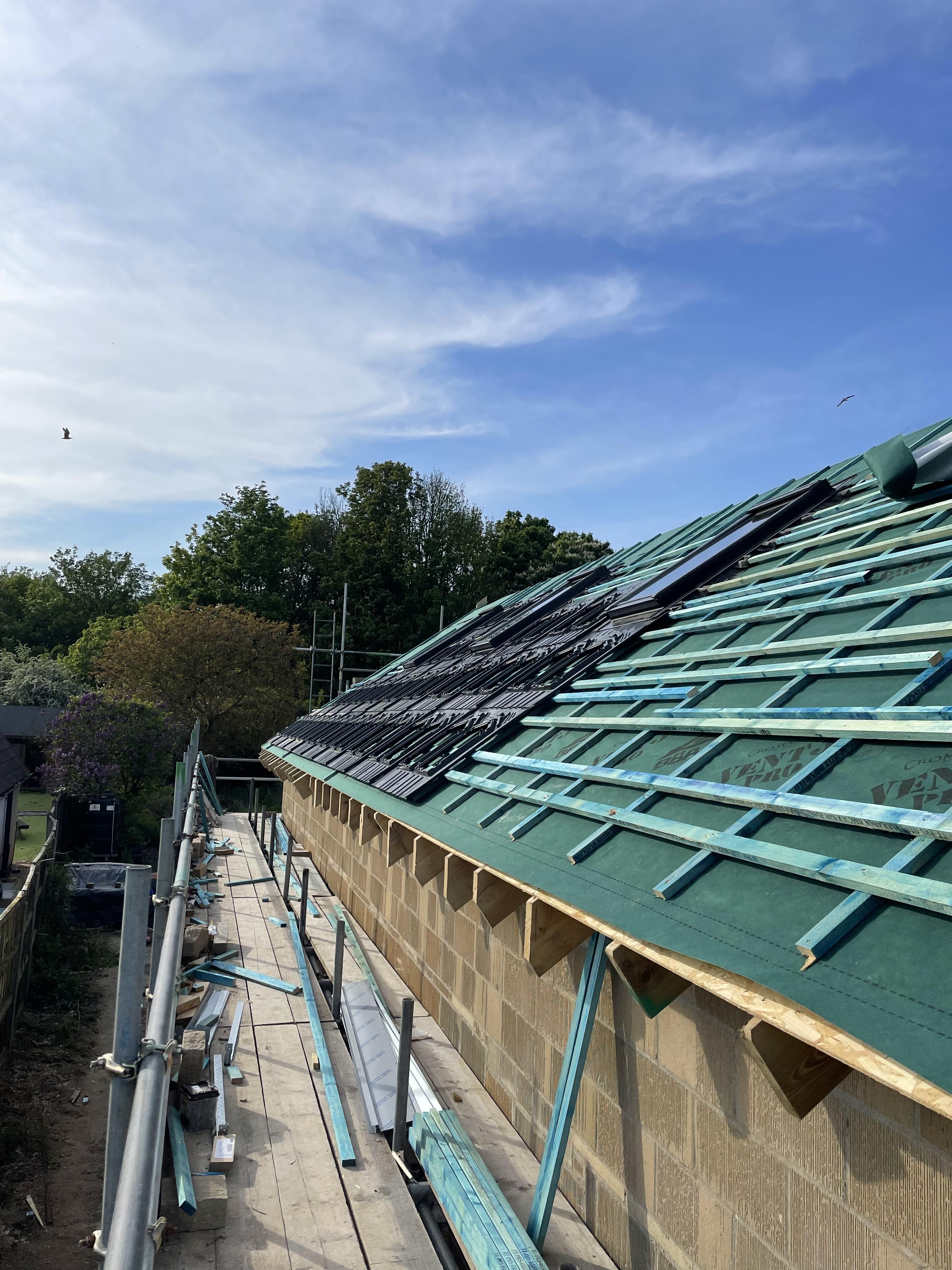

LiamJones Posted May 6 Share Posted May 6 For the OP. GSE trays with the Velux ODL kits for a seamless array. Not finished yet, trays/solar will go round all the velux. 1 Link to comment Share on other sites More sharing options...
Nick Laslett Posted May 6 Share Posted May 6 10 hours ago, LiamJones said: @Nick Laslett I see you’ve ran the gse trays up to the eaves. What flashing/tray did you use to bridge this? Standard eaves trays are too small for the gap specified in the gse manual. 330mm. Considering using lead now. Or custom Ali trays https://midsummerwholesale.co.uk/buy/roof-integrated-solar-pv/flexalu-330 I used the Midsummer solar panel web based design tool, which listed all the materials. https://easy-pv.co.uk I didn’t see any specific issues from my reading of the installation booklet. 1 Link to comment Share on other sites More sharing options...
