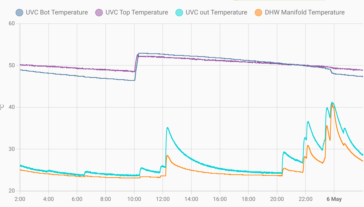

TerryE Posted May 6 Share Posted May 6 5 hours ago, George said: How is your hot water heated? We have an OSO UVC which is heated by dual immersion. I also have a couple of digital thermometers on the inner tank, one next to each immersion. My Node-RED heating control system does a day-ahead heating calcs at 23:00 GMT each night. We have Octopus Agile and the daily half-hour (HH) pricing runs 00:00 - 00:00 C.E.T. As far as DHW goes, the CH calc takes the average tank temp to work out a slight overestimate of kWh needed to bring it up to 55°C and this get scheduled at the cheapest HH slots with a cut out at 55°C (though at the mo the Immersion thermo cuts out first). We are on a Greek island ATM, so the HW draw is only from one occupant; our son who lives with us in his bed-sit on the 2nd floor. The screen capture below show the last 24hr history for Home Assistant. (BTW, the bottom scale is in local Greek time, sorry.) He hasn't used much hot water today (mainly just a quick shower, I guess). The OSO is really well insulated but even so most heating here is loss replacement. Checking my eventlog table, the total DHW heating used was 1.6 kWh costing 20p (The north sea is dead calm ATM, so the daily low price is quite high at about 13p.) Over the last few months since we commissioned the OSO it's been a lot windier and even though we use more HW with 3 of us in the house, the HH price for DHW has been averaging around 5p so we typically spend maybe 50p a day on DHW. 1 Link to comment Share on other sites More sharing options...
