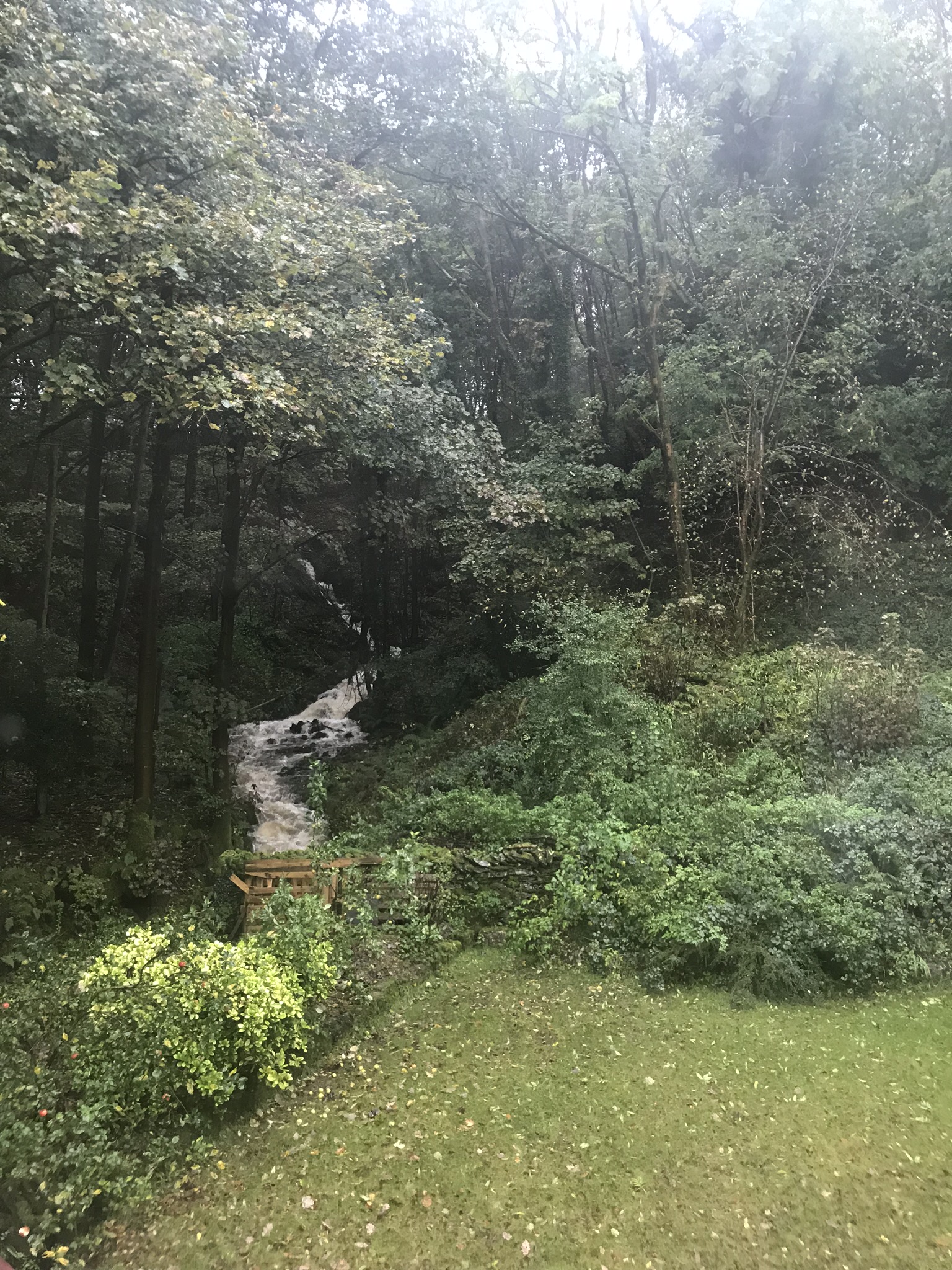

Lesgrandepotato Posted October 11, 2017 Share Posted October 11, 2017 Seems to be wet up here, must be a KW or two in this little lot! Link to comment Share on other sites More sharing options...
Temp Posted October 11, 2017 Share Posted October 11, 2017 http://www.renewablesfirst.co.uk/hydropower/hydropower-learning-centre/how-much-power-could-i-generate-from-a-hydro-turbine/ 2 Link to comment Share on other sites More sharing options...
A_L Posted October 11, 2017 Share Posted October 11, 2017 (edited) - at a reasonable 50% efficiency you've probably got about 250W - assumes 10l/s flow, 5m head - formula, .............flow(l/s) * head(m) * 9.81 (gravity) * 0.5 (efficiency of generator) = Output (Watts) Edited October 11, 2017 by A_L to add 'of generator' 1 Link to comment Share on other sites More sharing options...

Lesgrandepotato Posted October 11, 2017 Author Share Posted October 11, 2017 (edited) 9 minutes ago, ProDave said: If that's in your garden I would definitely be doing something with it. I will one day have a play with a generator in our burn but at only 1 metre head I won't get much. An undershot water wheel may work better in our situation. Its next years plans - TS with plenty of immersions going in. Thought it was worth a photo while its in spate today! Depending where we feed in, its something like 40-60ft of fall. - about the height of a 4 story mill in fact :-) Edited October 11, 2017 by Lesgrandepotato Link to comment Share on other sites More sharing options...
