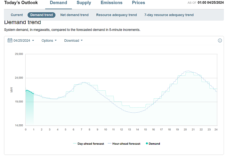

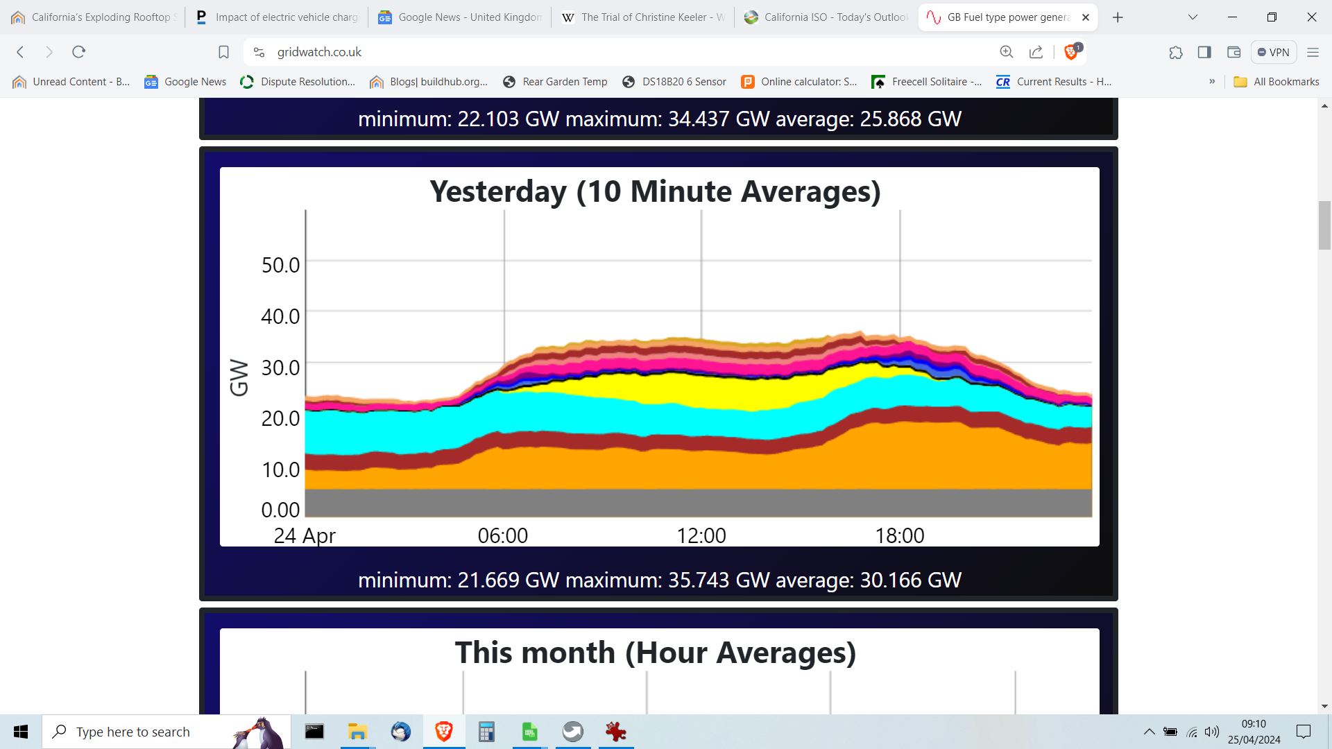

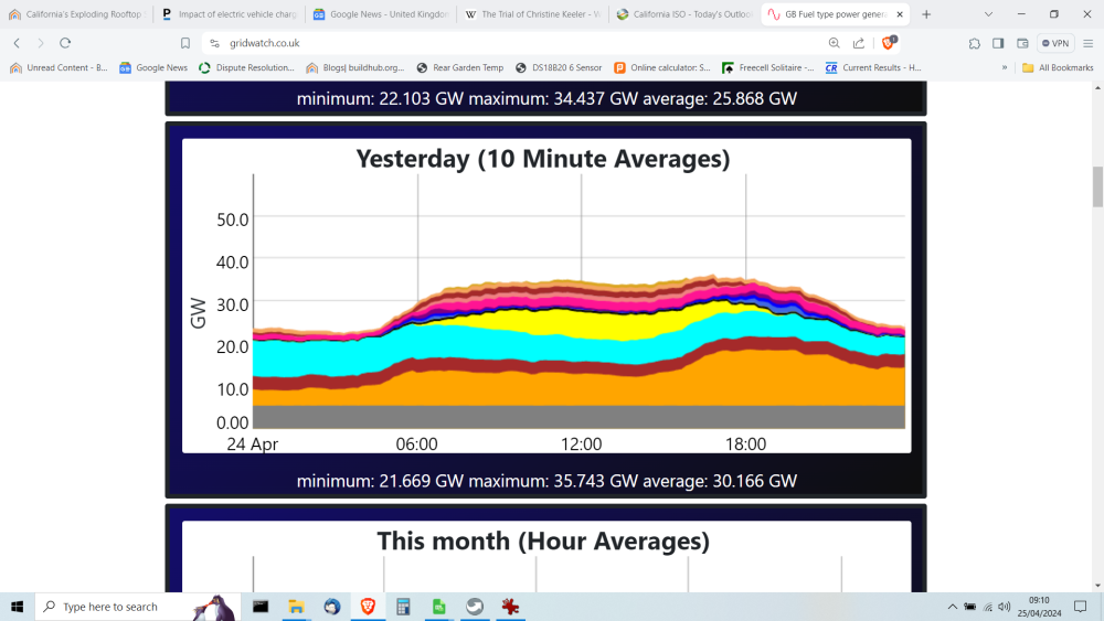

SteamyTea Posted April 25, 2024 Posted April 25, 2024 5 minutes ago, Alan Ambrose said: BTW I think California is interesting for us It is, they have a population of 40 million people but use a similar amount of electrical energy to us. Being Western they also live similar lifestyles.
saveasteading Posted April 25, 2024 Posted April 25, 2024 13 minutes ago, SteamyTea said: they also live similar lifestyles Except they use lots of aircon cooling?
SteamyTea Posted April 25, 2024 Posted April 25, 2024 4 minutes ago, saveasteading said: Except they use lots of aircon cooling Yes, but the overall usage patterns are probably very similar. They tend to be in developed countries. Not identical but a useful comparision. https://www.caiso.com/TodaysOutlook/Pages/default.aspx https://gridwatch.co.uk/ 1
