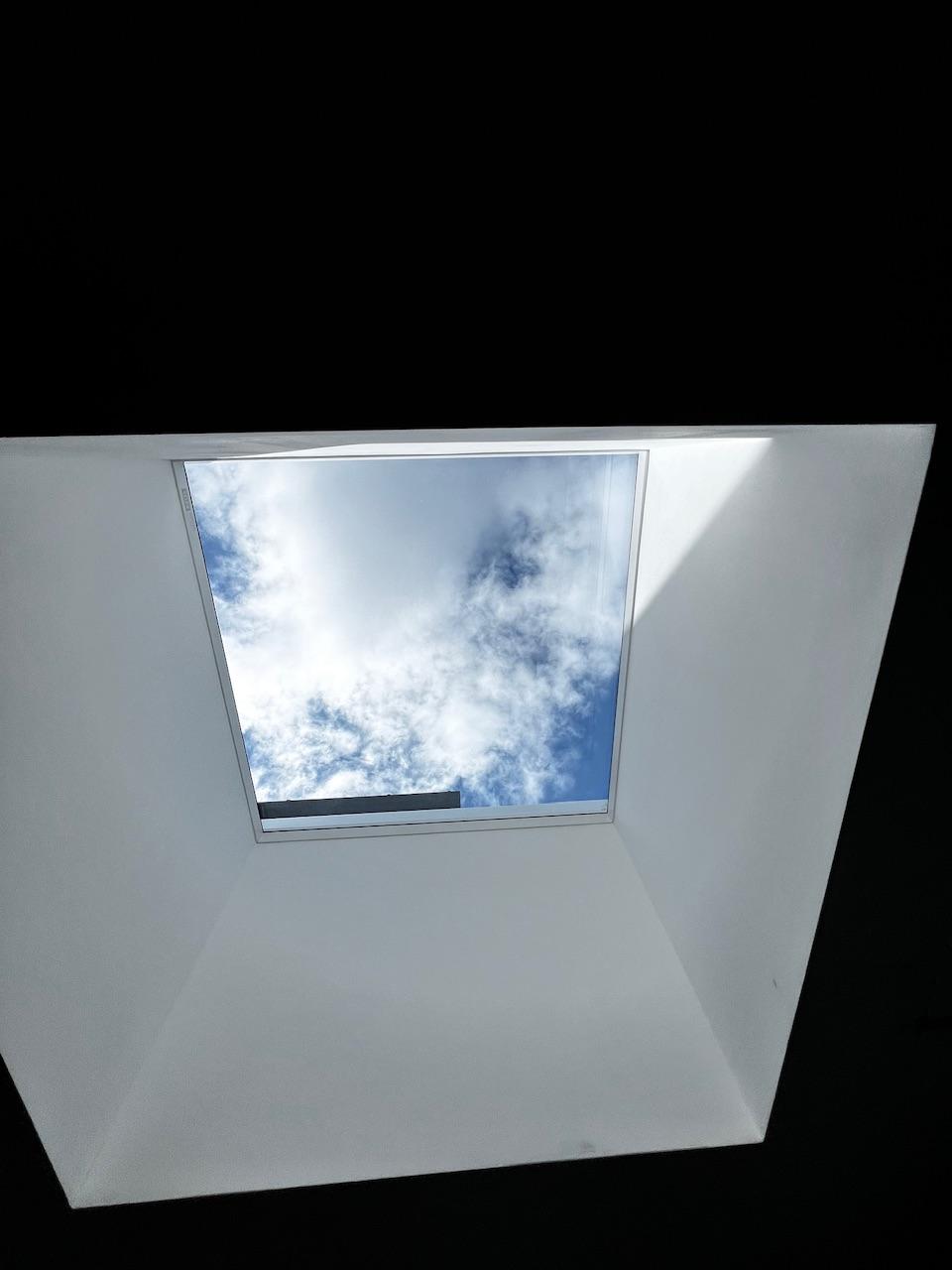

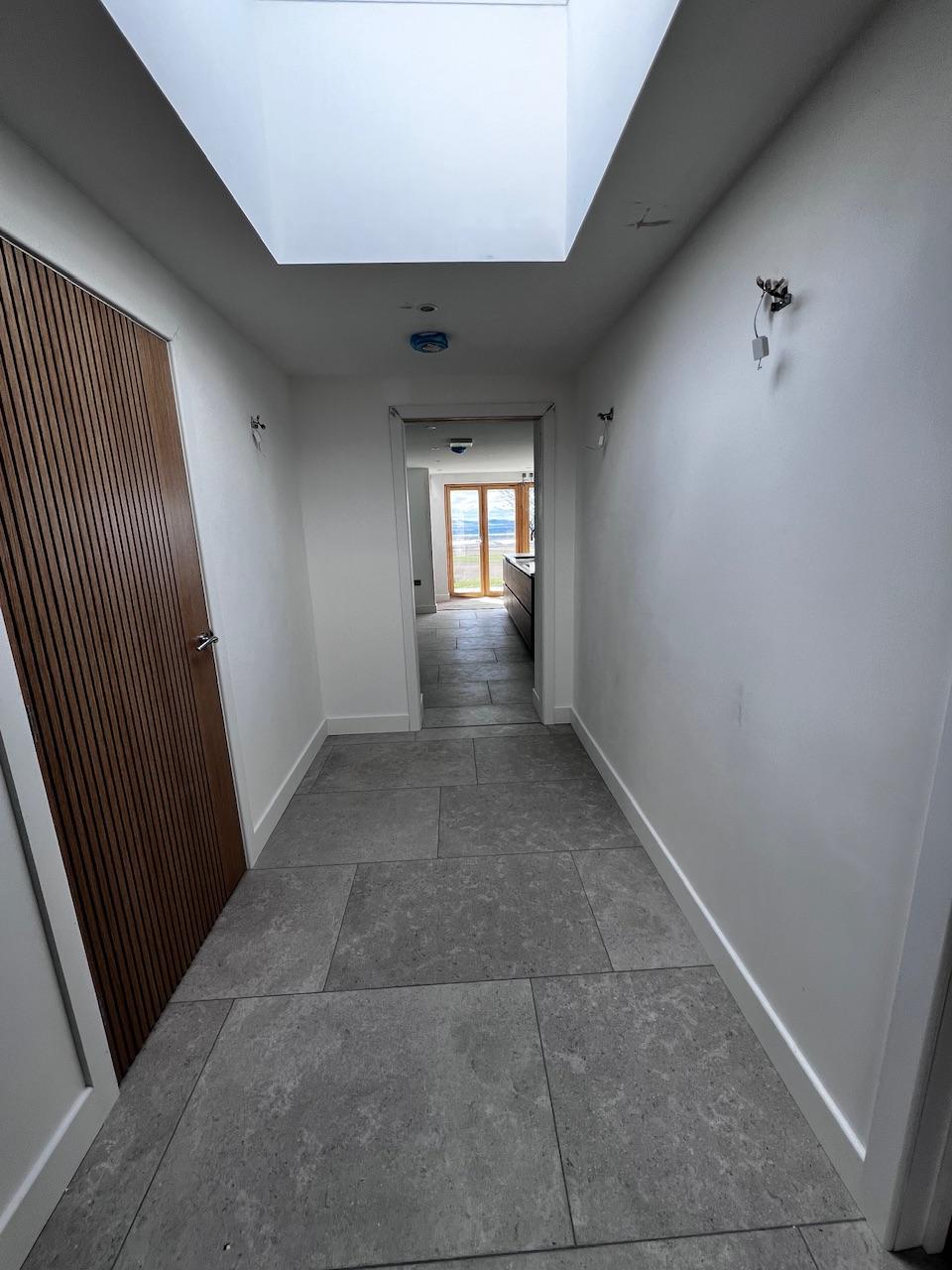

Kelvin Posted April 25, 2024 Posted April 25, 2024 We made a last minute change and added a rooflight for the hallway. I considered a light tunnel instead but we decided that making a feature of the rooflight would add some interest to otherwise flat ceilings. It has a created wonderfully light airy hallway. I love the being able to see the sky when you walk in. There’s a glazed door to be fitted giving you a view to the hills beyond. 4

markharro Posted April 25, 2024 Posted April 25, 2024 I like your slatted door in that photo @Kelvin can I ask where you sourced that from?
Kelvin Posted April 25, 2024 Posted April 25, 2024 23 minutes ago, Super_Paulie said: yeah, amazing stuff Kelvin. Im not so lucky/rich. Velux do windows that aren’t that much more than the sun tunnels if you’d prefer a window.
