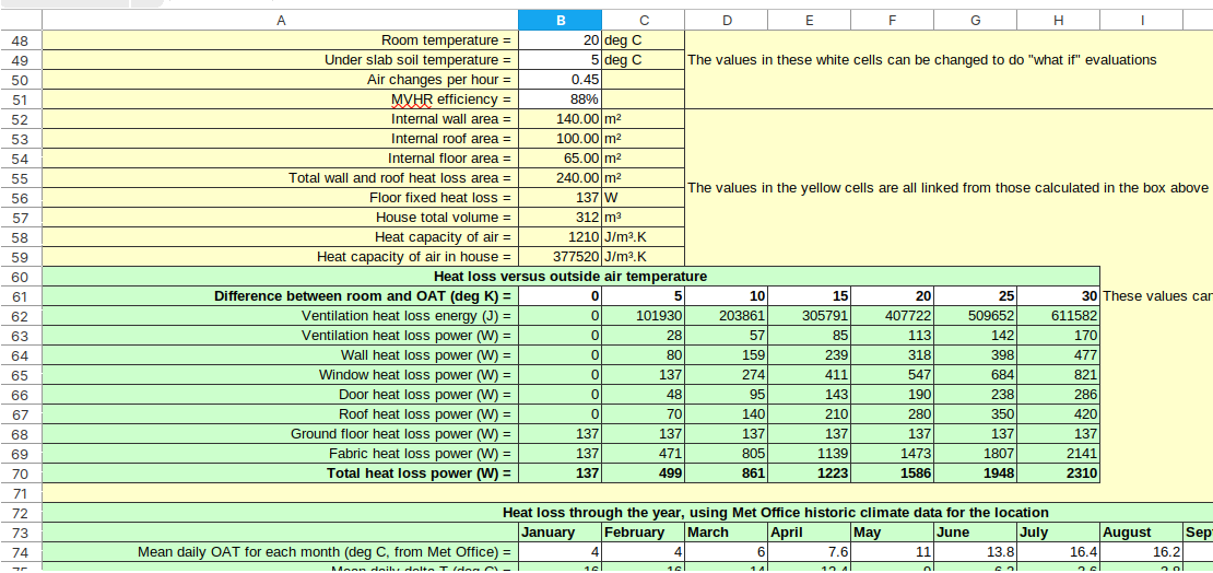

Barnboy Posted April 14 Share Posted April 14 I'm still to get an air test, not cheap and I'm not air tight yet. I've filled in Jeremy's heat loss calculator, to try and get an idea of ashp and ufh sizing. Firstly I'm not 100 % sure which figures I should be using fromt eh calculator to work these things out as there's Total heat loss, Inside vs outside heat loss, Total daily min and average, I had someone round to look at giving me a price for them to supply and fit, and also which would be the best position for a unit and route for pipework into the house. The guy did a rough calc on his phone of 40w/m² for ufh multiplied by 90 for the m² footprint of the building, saying I then needed 3.6kw ashp capacity, He then said as I have no heating on the 1st floor, only power points if I did want to put panel heaters in the future, I'd need to double the capacity of the heat pump. Is his theory correct that I'd need to double up having no upstairs heating, and which figure on the calc do I use ? Thanks Link to comment Share on other sites More sharing options...
nod Posted April 14 Share Posted April 14 We have radiators in the bedrooms that we will never use But the HP guy did the same with us If the rads are there They May need a heat supply 24-7 Weve put them in with any future sale in mind As some people assume all bedrooms are going to be cold in winter I’d stick to your original plan Link to comment Share on other sites More sharing options...

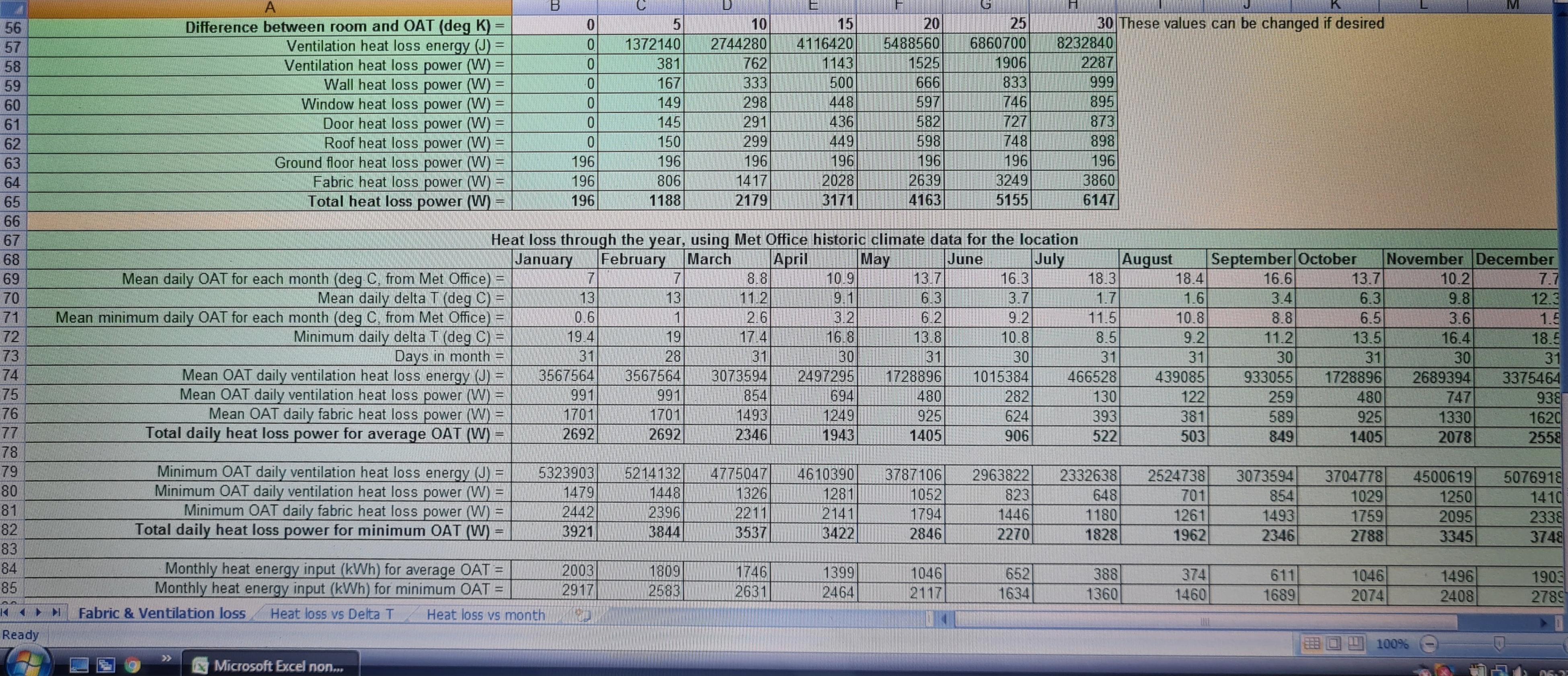

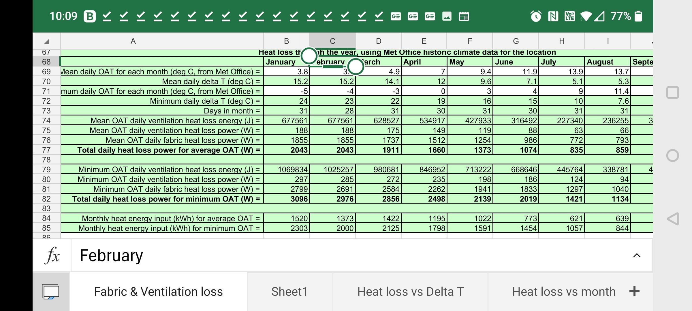

JohnMo Posted April 14 Share Posted April 14 You use, the Daily heat loss power for min OAT the coldest day. In thee example below for Jan. So that gives you the total heat loss for your house. 22 minutes ago, Barnboy said: I'd need to double the capacity of the heat pump. Is his theory correct No. Total heat loss is total heat loss, if this is supplied by 100 or 1 heater it's still the same. Link to comment Share on other sites More sharing options...
Barnboy Posted April 14 Author Share Posted April 14 So I'd be looking at needing a 4kw, or the nearest above that ashp if my calls attached are correct? Link to comment Share on other sites More sharing options...
ProDave Posted April 14 Share Posted April 14 There is an even simpler way I did not bother looking up the OAT data for my location so I only filled in the spreadsheet down as far as row 70 so row 70 column H shows me with a delta t of 30 degrees (20 degrees inside, -10 outside) the calculated heat loss is 2310 watts. So on the coldest day in winter my heating needs to put 2310W of heat into the building. Why make it any more complicated? Link to comment Share on other sites More sharing options...
JohnMo Posted April 14 Share Posted April 14 27 minutes ago, Barnboy said: So I'd be looking at needing a 4kw, or the nearest above that ashp if my calls attached are correct? So your area never freezes, you have a min temp of 0.6. You should really follow what @ProDave says or use these instructions as a sizing guide Link to comment Share on other sites More sharing options...

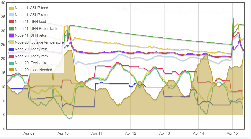

Barnboy Posted April 15 Author Share Posted April 15 8 hours ago, JohnMo said: That makes no difference, except make sure it's a heat pump suitable for a coastal location. Does wind chill not affect the performance ? If an ashp was facing south in a sheltered location on a sunny winters day with a chilly easterly wind would it not perform better than if it was in a shaded spot with the wind blowing straight at it ? Link to comment Share on other sites More sharing options...
Kelvin Posted April 15 Share Posted April 15 1 hour ago, Barnboy said: Does wind chill not affect the performance ? If an ashp was facing south in a sheltered location on a sunny winters day with a chilly easterly wind would it not perform better than if it was in a shaded spot with the wind blowing straight at it ? It’s more the ambient temperature around the ASHP which doesn’t vary much around a building as I understand it. Link to comment Share on other sites More sharing options...

SteamyTea Posted April 15 Share Posted April 15 (edited) It is an interesting point about windchill. Windchill is caused by evaporation, which is a phase change, and with water, a huge shift in energy levels, around 540 times different. If it was a problem, ASHP would not work a lot of the time. There may be marginal conditions where a 'triple point' temperature happens (ice, liquid and gas), but I doubt it as air pressure is probably too high. As for, as mentioned on another post, cold air recirculating back into the unit, without putting the unit into a well insulated, close fitting, airtight box, I don't think this is an issue. The amount of air a heat pump shifts is pretty minor compared to the amount of air surrounding it. Edited April 15 by SteamyTea Link to comment Share on other sites More sharing options...
JohnMo Posted April 15 Share Posted April 15 2 hours ago, Barnboy said: Does wind chill not affect the performance ? If an ashp was facing south in a sheltered location on a sunny winters day with a chilly easterly wind would it not perform better than if it was in a shaded spot with the wind blowing straight at it ? As above, also the unit is pulling a huge volume of air through it, so it's making its own strong wind. (Bold section) No Link to comment Share on other sites More sharing options...
ProDave Posted April 15 Share Posted April 15 My ASHP is on a south facing wall. In winter on a still day here, the front of the house that does not get any sun can stay cold and frosty all day long. The south that gets any sun going, warms up and the frost melts. I cannot believe being on the warmer side of the house has no positive effect on the ASHP performance. Link to comment Share on other sites More sharing options...

JohnMo Posted April 15 Share Posted April 15 Evaporator is on the wall side of the heat pump, so always in the shade, sun would never get close to the area to be effective with aiding defrost. Your heat pump reads the air temperature it sees going via the evaporator, compare it to ambient on a sunny day and report. Mine is exposed to early sun, if it's cold and sunny the air going through the evaporator is also cold. Link to comment Share on other sites More sharing options...
Bramco Posted April 15 Share Posted April 15 3 hours ago, Barnboy said: Does wind chill not affect the performance ? As above, probably not on the ASHP but surely the 'feels like' temperature, often windchill but sometimes just a clear sky at night, must make a difference to the heat required by the house. We've been monitoring the 'feels like' temperature recently and on some nights it can be at least 5C below the actual OAT. You can see this on the graph below. So the question then becomes, should you, in the spreadsheet use an OAT which is 5C or so below what the met office tell you is the lowest OAT? Which would mean a bigger heat pump than the spreadsheet would normally indicate. We're going to use the data to create some kind of 'heat required index' for our build and use that to set how long the ASHP runs for. Simon If you look at the 10th and 14th you can see the feels like temperature drops by about 5C from the outside temperature. Green and Yellow lines. The data is from openweathermap. Link to comment Share on other sites More sharing options...

ProDave Posted April 15 Share Posted April 15 Another point about Jeremys spreadsheet. The last part, where he inputs OAT data and predicts monthly heating requirement is flawed. If I look at the figures I have, which still has the OAT data for where Jeremy lives which is a lot milder than here, it gives me monthly values way higher that reality. In particular I find OAT of 10 degrees is a tipping point for us. 10 degrees or more and we don't need any heating at all. Yet Jeremy's spreadsheed is still calculating a June / July / August heat loss where nobody will be using any heating. Link to comment Share on other sites More sharing options...
