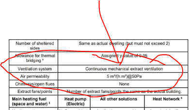

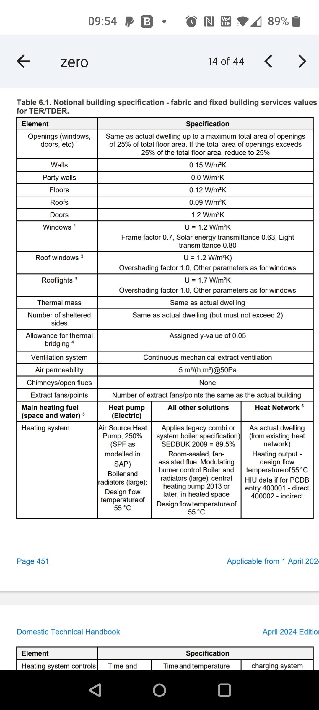

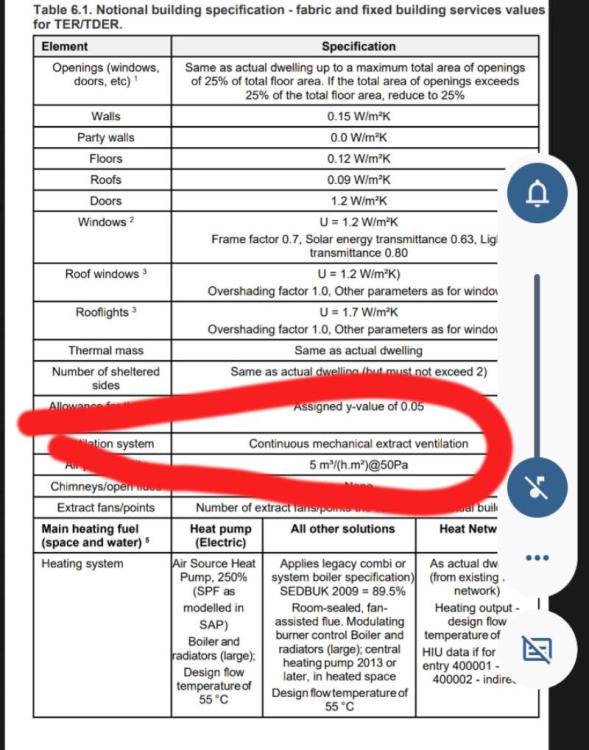

JohnMo Posted April 12 Share Posted April 12 Another thing missed in the article is the notional building performance has been moved to a higher standard also. So mediocre designs are pretty much banned, without loads of solar to compensate. 1 Link to comment Share on other sites More sharing options...
JohnMo Posted April 12 Share Posted April 12 43 minutes ago, ProDave said: allow WBS I have one and still have the gas boiler installed, although I do use an ASHP. But really hope they do stay banned. Link to comment Share on other sites More sharing options...
Kelvin Posted April 12 Share Posted April 12 I noticed that too. While the U values are good the air tightness is still poor. 2 Link to comment Share on other sites More sharing options...
