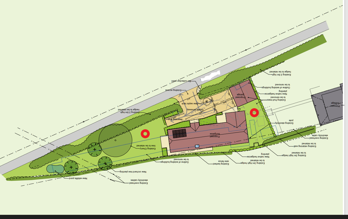

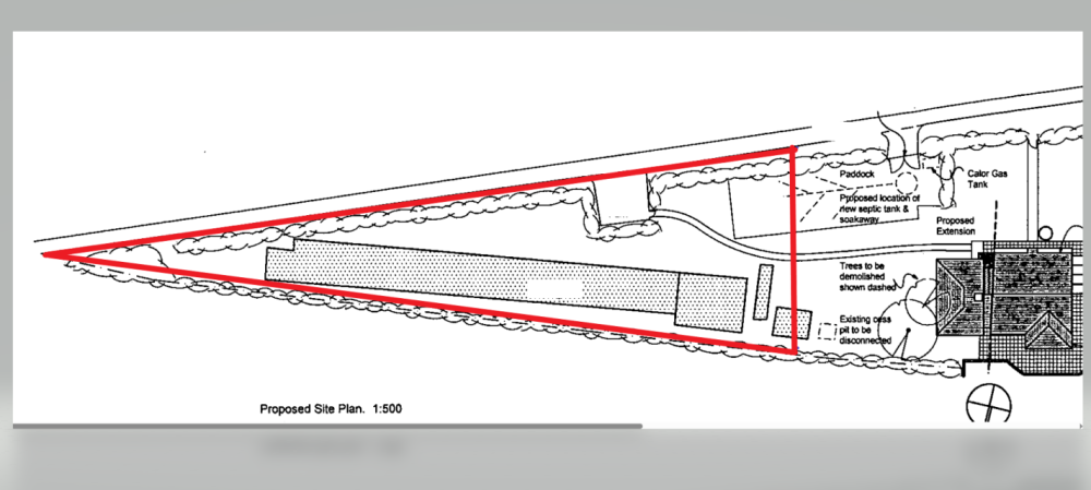

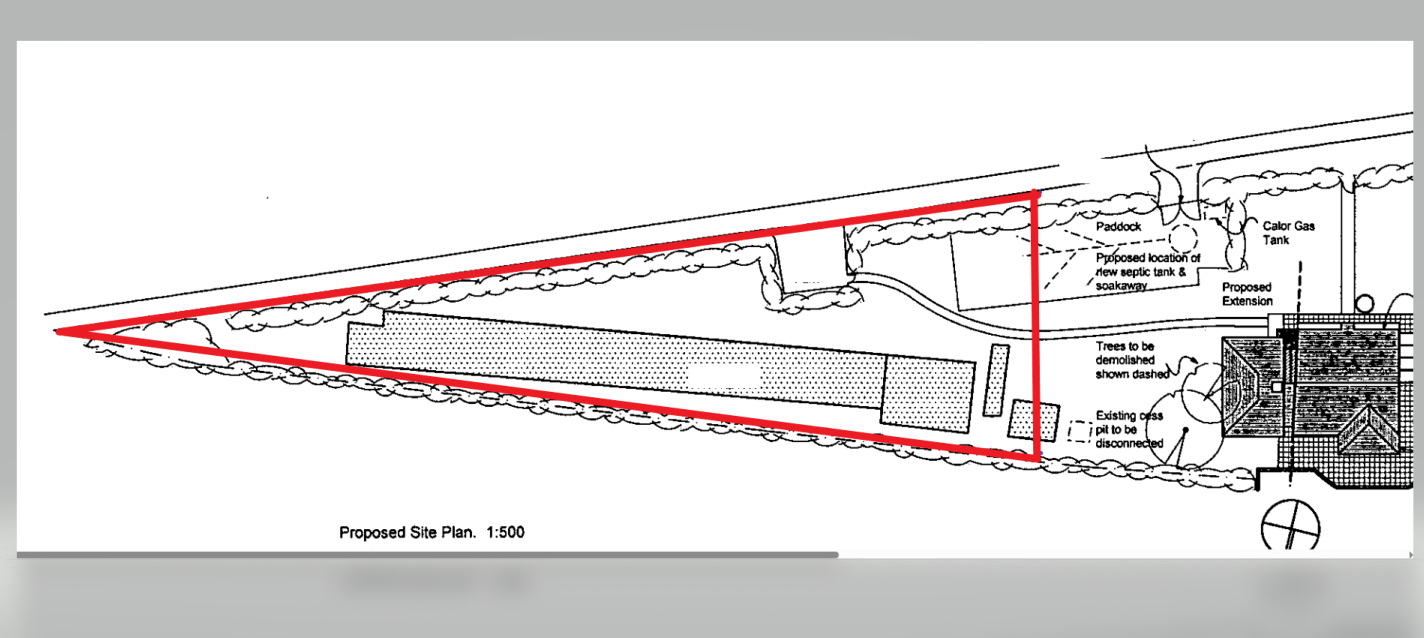

The issue is not with the drainage field of the proposed house, but with that of the neighbours.   The image below shows the current location of their drainage field in relation to the boundary.  The image at the very bottom shows the proposed house and garage.   As you can see, the garage will be literally on top of their drainage field, and the proposed house a little too close for my liking.

What's annoying, is that another plot has come to market that ticks the boxes and does not have the associated headache.  Having looked at the scaled drawings, I don't see what options the vendors have for moving their drainage field so that it satisfies the 15 metre away from any dwelling building reg.  They just don't have the space, and I am concerned that as a result it's dead in the water.  I do feel for them, as it appears that nobody involved in their whole planning application process, asked them the question "Just out of curiosity, where is your drainage field located?"

Now that I’ve looked at the block drawings I’d walk away. I wouldn’t want any aspect of my house relying on someone else’s land but nor would I want any aspect of someone else’s house relying on my land. Everything to do with our house is in our land.

I would walk away.  There is no way you can build a garage on top of next doors drainage field, even before you think about distances to the house.
Unless an off site drainage solution was available for both houses I would say the plot is not viable.  The minimum needed is permission from the land owner to the south for drainage fields for both properties to be installed under that field (assuming it is a field not other houses).
If I was the vendor I would be looking for such permission, and then thinking of installing a large TP to serve both houses and the drainage field for it, then sell the plot as a serviced plot.  That is about the only way I think it is viable.
They are currently investigating where they can move their septic tank and drainage field to.  Before we even consider moving forward, I would want building control involved, to ensure that the proposed location is acceptable, and it legally agreed that the moving of the field will be done as soon as we have purchased the property.
I agree that installing the drainage field in the paddock behind is a much better option, but they have said that is not viable.
It does also raise the question as to whether the contaminated land near the garden needs to be removed before the garage could be built.
