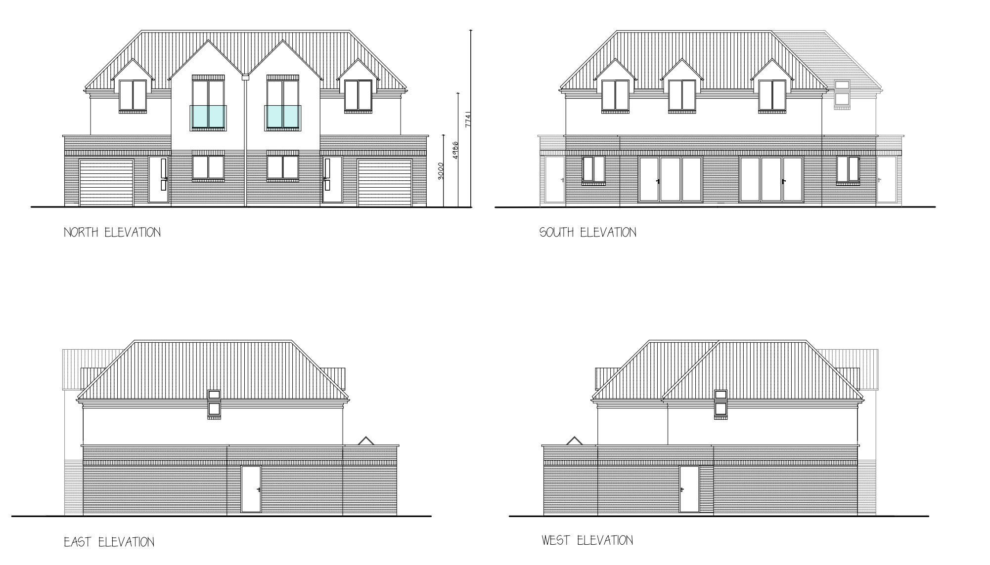

Below is the approved Semi detached plan which is expired in 2022.

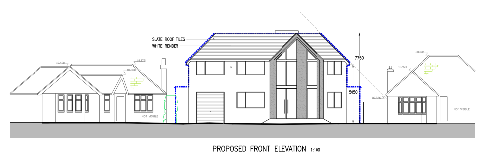

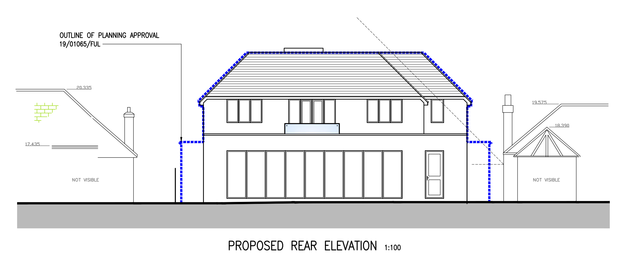

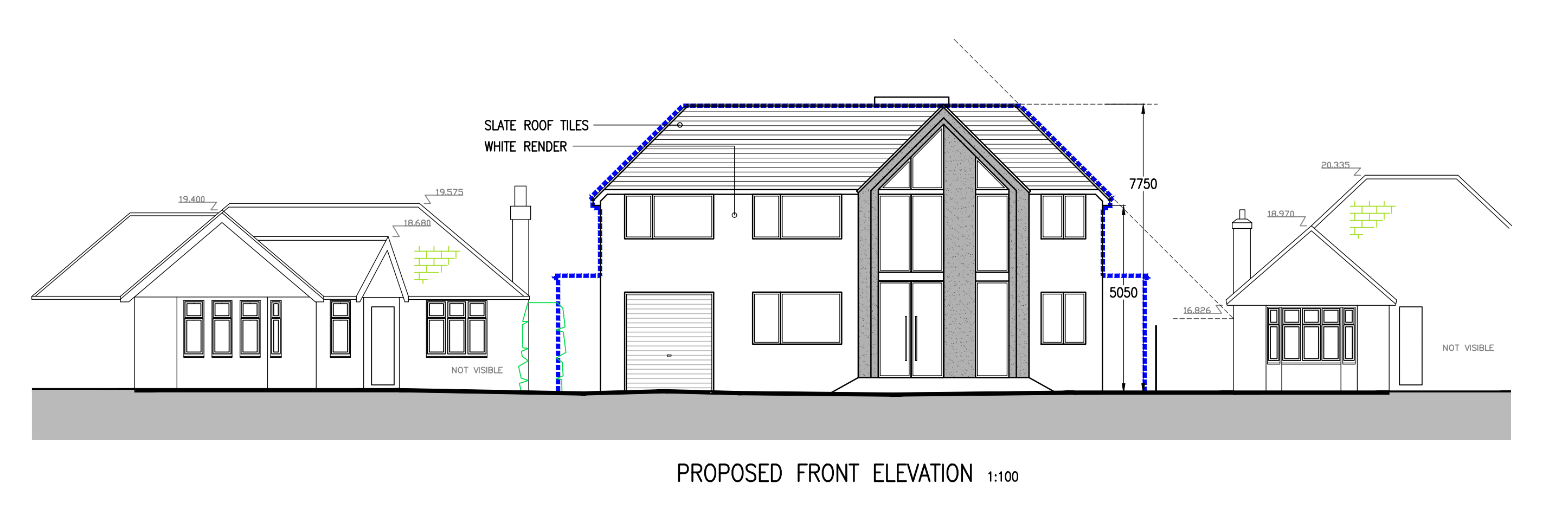

Current planning drawings which are being evaluated by planning officer:

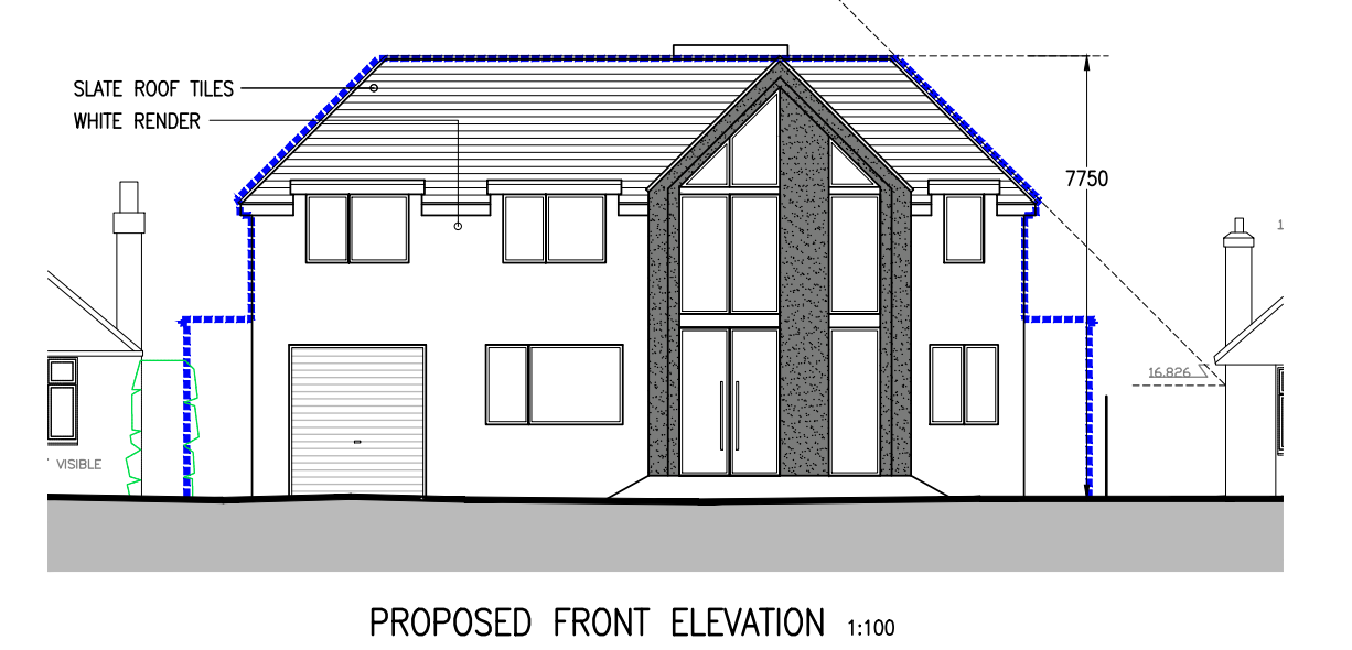

Initially the planner asked for the eaves to be lower and we submitted a ammened version as below (atleast to get some sort of approval):
Later the planning officer came back saying proposal is still unacceptable considering the comments made by the PI in the dismissed appeal. I have attached the dismissal note to this topic, because we think the planners are suggesting they made a mistake in 2019 ! as the subsequent appeal for the flats suggested a two building was not appropriate.

A latter Appeal decision will always in most cases override a previous LPA decision. The LPA will now (which they are doing) use the Appeal decision and the comments made by the PI in determining any future application.
Without knowing what the existing bungalow looks like, I can’t see it being much different to the neighbouring properties. Why not consider a chalet bungalow/1.5 storey dwelling?

I think you missed a trick by not referencing the approved ridge and eaves heights.
7741 ridge
4986 eaves as previously approved would be a small tweak, but may be the difference between getting planning and not!

I pulled up the previous plans and the new plans and had a look at the street on line.
I couldn't figure out why the new house looked larger to me, even though it isn't.
Looking at the previously approved plans for the semis. The windows are cut into the roof line at the front. This gives an eaves height of 4986mm. The new plans show and eaves height of 5050mm, but this is to the sides. The front eaves height seems to be around 5350mm, so a substantial 400mm taller. front wall, hence it looks more imposing on the street.
The new proposal is in white render with a small area of darker render. I assumed that the bungalows next door were also white as that is how they look in the drawings. However, looking on Streetview, every single house on that side of the street is built from dark coloured bricks (grey or red), both the older bungalows and the newer two storey 80s houses. I am not clear why the architect has gone for this colour scheme which would stick out like a sore thumb. Similarly the older houses seem to have red clay roof tiles and the more modern house dark concrete tiles. A slate roof also seems out of place.
Is there room for some discussion with the case officer to make the house look more like the previously approved application and fit in better than the current plans? It looks to me as if you could have a similar roof and eaves design to the previously approved semis for a final loss of upstairs space. I always feel like planners like a bit of compromise.

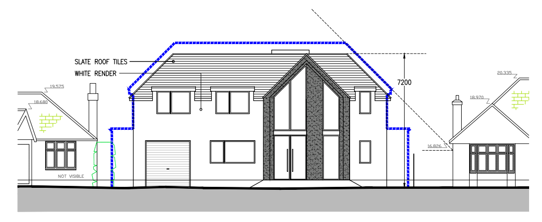

Thanks for your thoughts AliG, the render and color for the planned design is something I have proposed [Architect didn't seem to be concerned] assuming the current bungalow is in white. I never thought of the look for Semi-detached and always looking at the size perspective, as the street has a mix of bungalow to 2 & 3 storey houses with different colors. The current bungalow also visible on the other road where there are mixture of properties
My architect is proposing, we go back to case officer to check if it is acceptable if we reduce the ridge height to 7.2 M as below
I'm not able to picturize how the house looks like  as it seems I'm compromising [do agree all parties are at compromise] to fit the interested design in wrong scale or so...

That looks a lot more like the semis and I think would be more acceptable. It really reduces the bulk of the front wall. It also makes the house look better and less boxy. I actually don't think the original house is a good design.

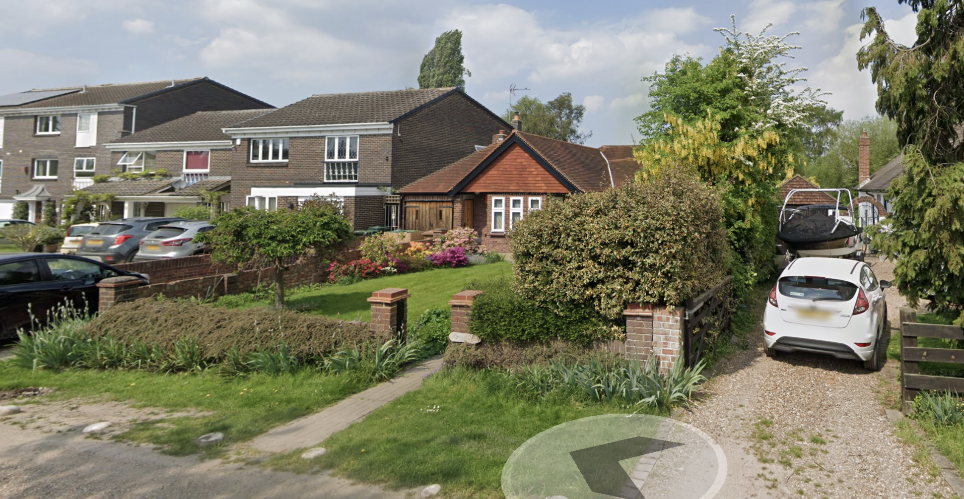

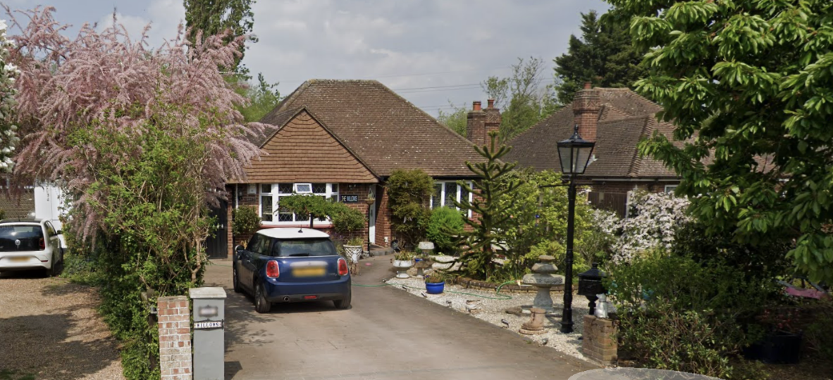

There is a white bungalow across the road. But it looked to me like all the houses on that side are totally made out of brick (Sorry, actually I had another look and the bungalow you are knocking down is white with some brick highlights, it is hard to see behind the bushes). If the planning officer continues to not like it I’d be asking if adding brick would help. Maybe half brick half render as the semis were, or the front gable in brick instead of dark render.
You could also consider a red roof which is more similar to the bungalows.
I have added in pictures of the houses either side to give people an idea of what you are working with.

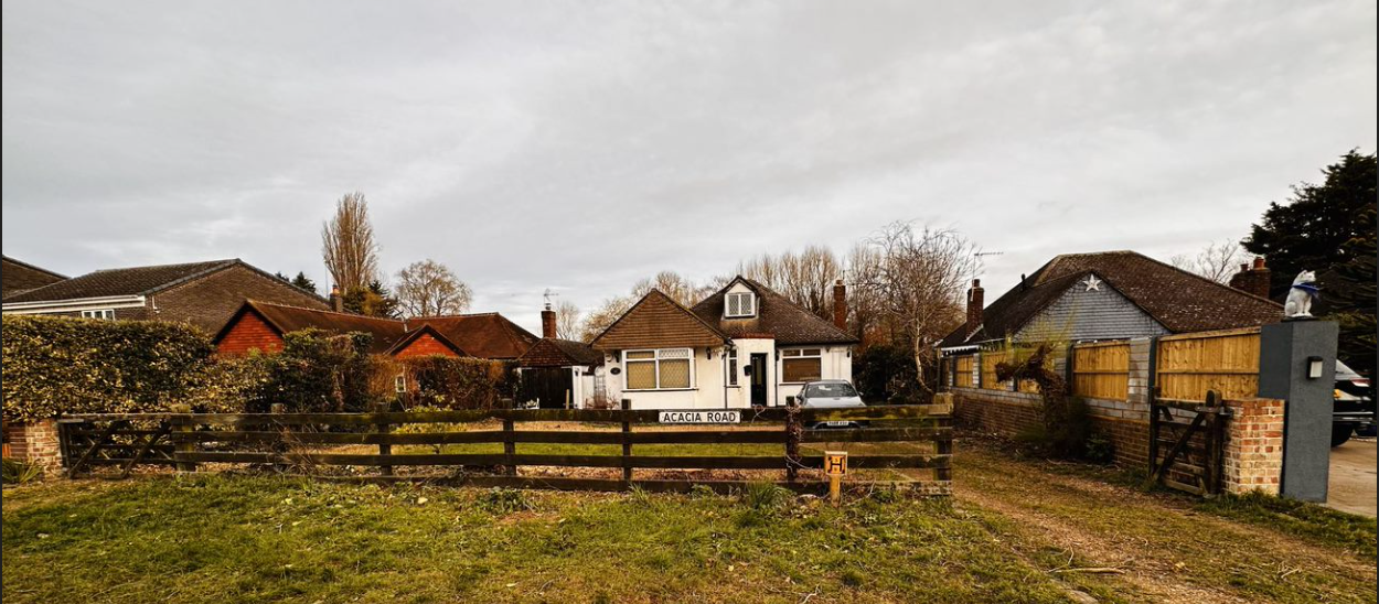

As of now the planning officer has not shared what elements of the design are of a concern, he simply referred to PI comments and in favor of rejection. We have asked for more detail so we can address the concerns and  compromise.
