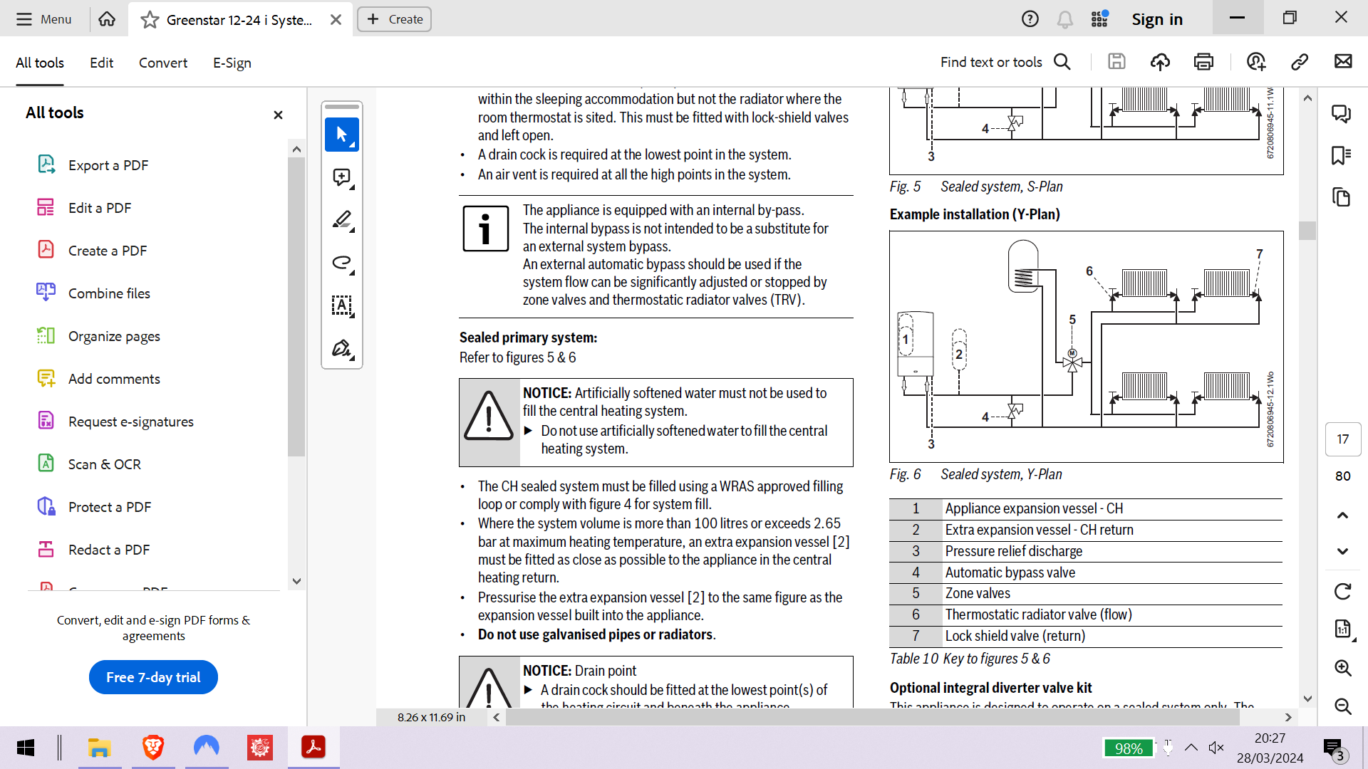

joth Posted March 28 Share Posted March 28 (edited) 7 hours ago, joe90 said: Oh yes, but softened water is not so good for consumption, I am sure the small amount of water consumed from a basin tap is minimal (but we are all different). I find softened water fine for drinking, I actually prefer it for filling bottles and especially if boiling it up for tea. We put softened in the quooker, works great There's a few areas in the UK that the water is so hard that wras recommend against drinking it, but in most areas the salt added is so low it's not considered a risk Likewise I use softened water to fill the heating system. Couldn't find any advice either way but seemed worth trying to avoid getting limescale in there Edited March 28 by joth 1 Link to comment Share on other sites More sharing options...

HerbJ Posted March 28 Share Posted March 28 Most gas boilers specifically prohibit the use of "artificially softened" to fill central heating systems, which why the heating system fill-point should be from the mains supply I seem to remember it caused problems with the heat exchangers? I attach the relevant page from WB Greenstar system boiler, which is now 8 years old. Maybe not problem with ASHP and modern UFH systems and it should be checked Link to comment Share on other sites More sharing options...
