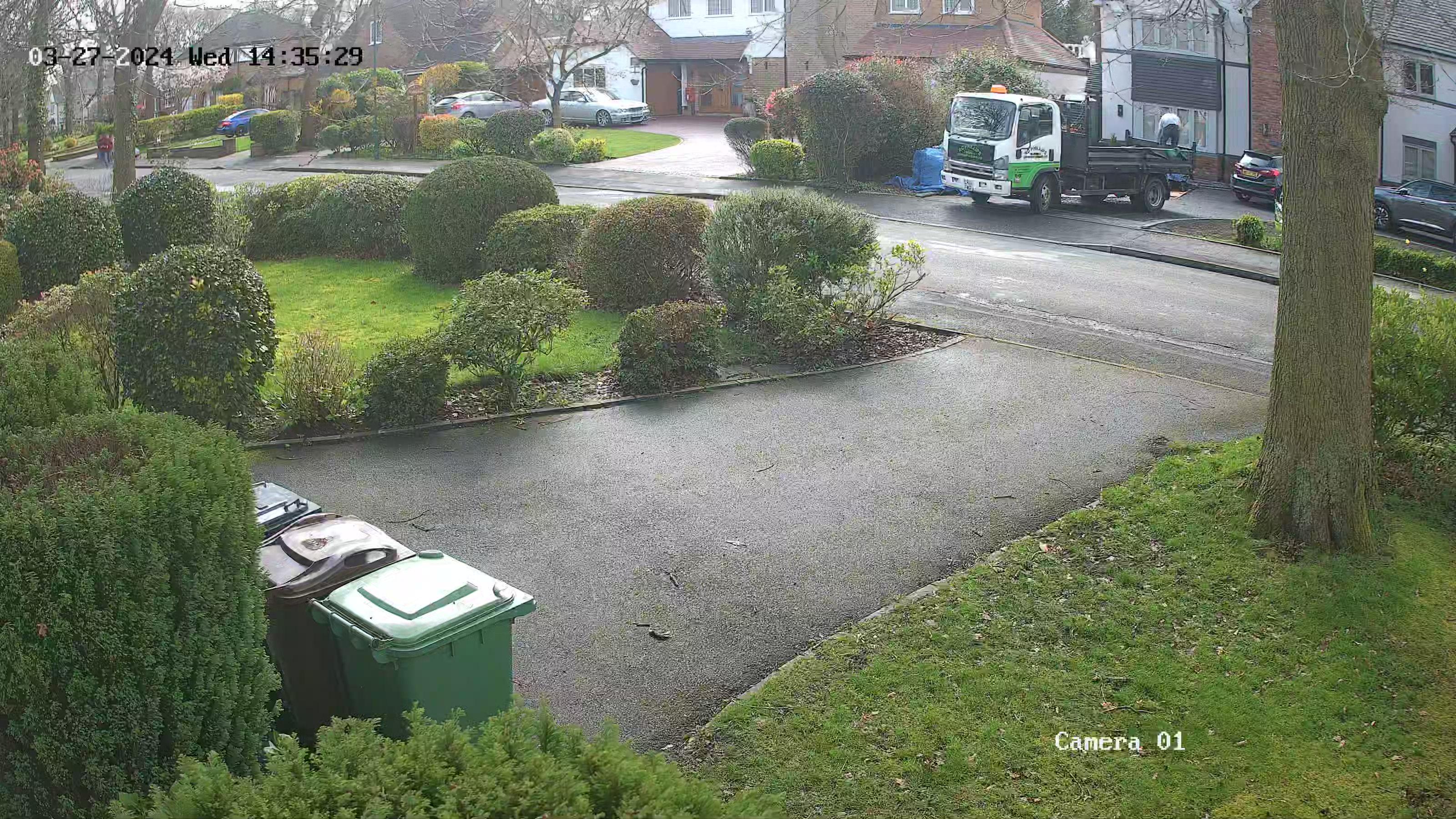

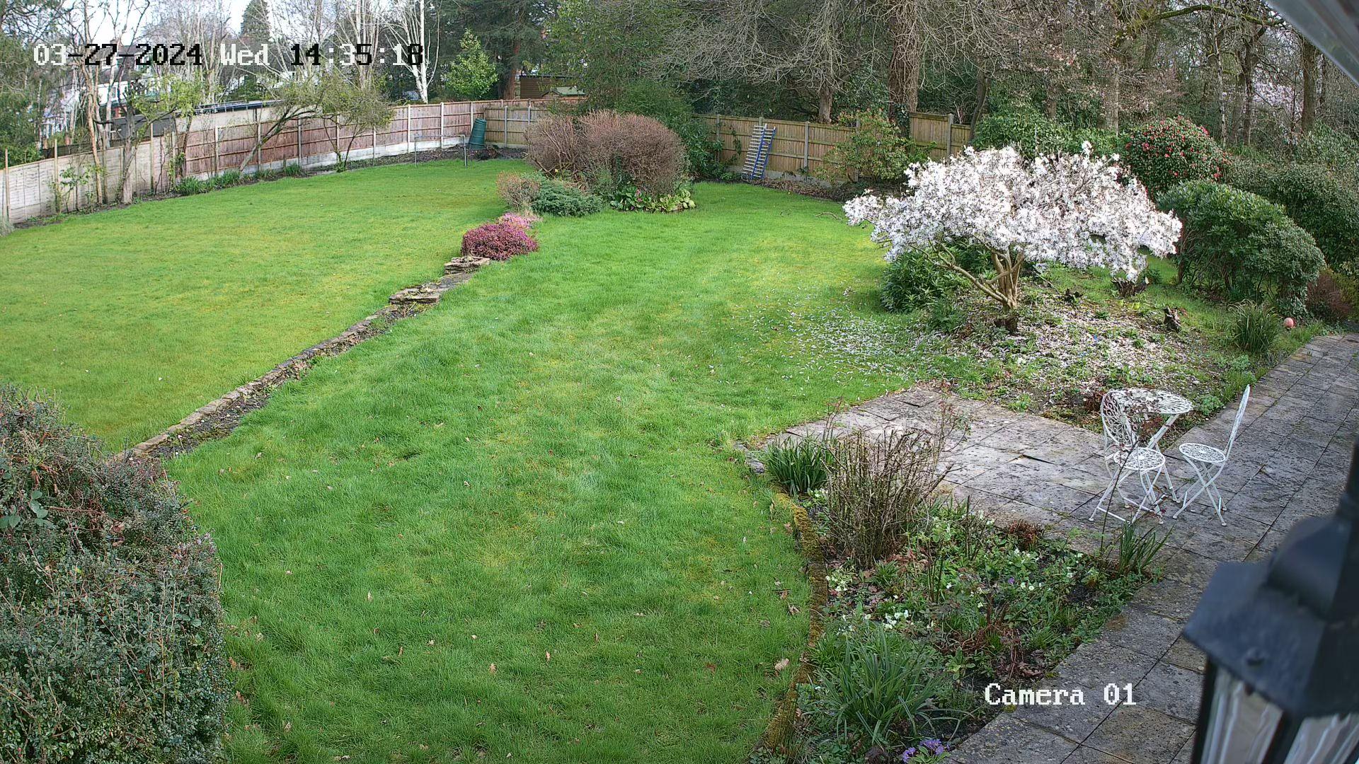

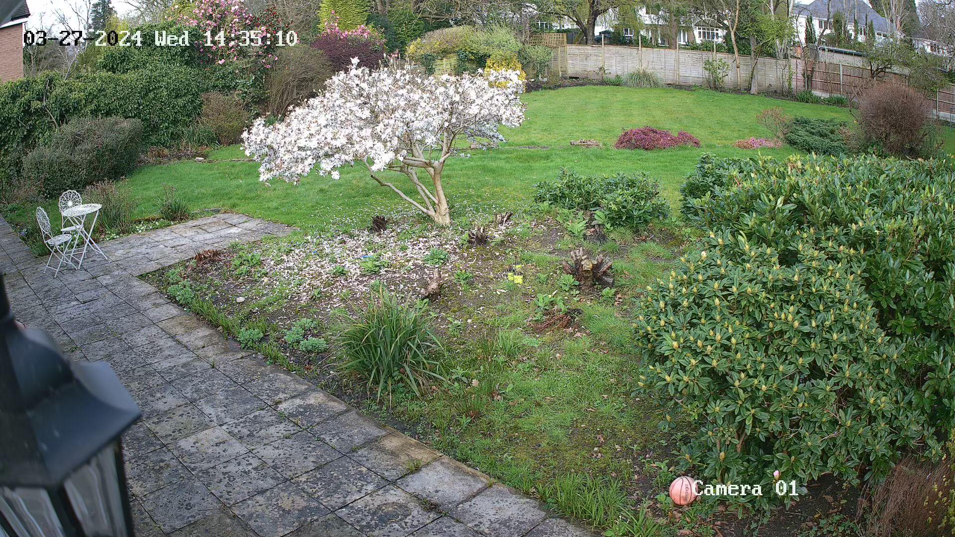

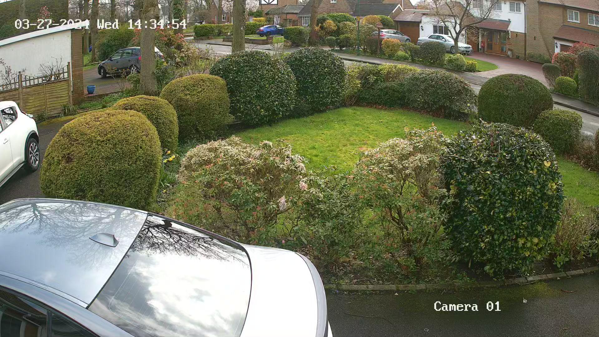

Zak S Posted March 27 Author Share Posted March 27 (edited) @Russell griffiths I bought the banglow gazumping a developers who later was willing to match or outbid my offer so demand is definitely there but i dont want to sell. I bought this as forever home if such thing exist. The street has gone through some very nice developments and the upper limit has been lifted significantly. Here are some pics. Plenty of space in the garden as plot size 0.4acre and walking distance to station with direct link to London 1:45 away. If new builds is upto 800k then price from the turn key builder with some negotiation does not seem that bad but I personally think its too high Edited March 27 by Zak S Link to comment Share on other sites More sharing options...

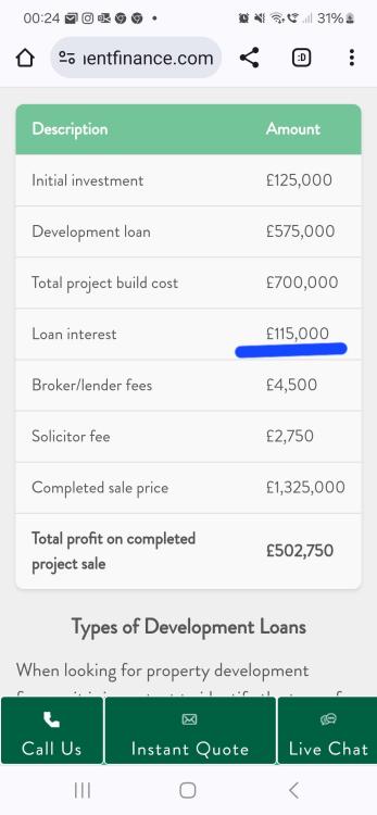

Russell griffiths Posted March 27 Share Posted March 27 You have your answer. you beat a developer in buying it, what do you think he wanted it for. it looks like the cheap house on the block. you always aim to buy the cheapest house in the best street, then turn it into the best house on the street. The big problem is getting the finance. Link to comment Share on other sites More sharing options...
