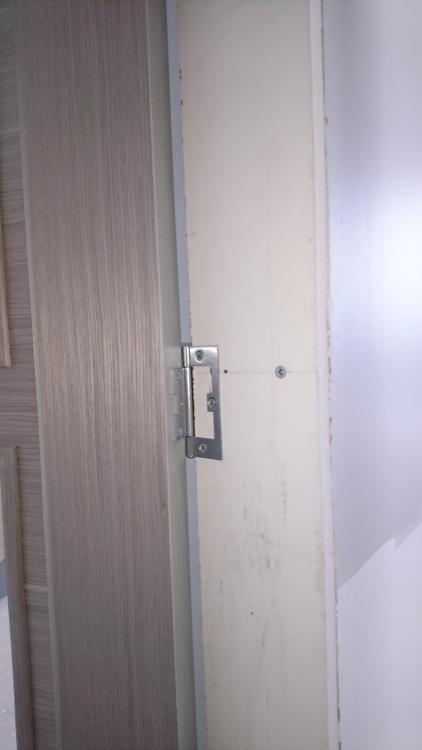

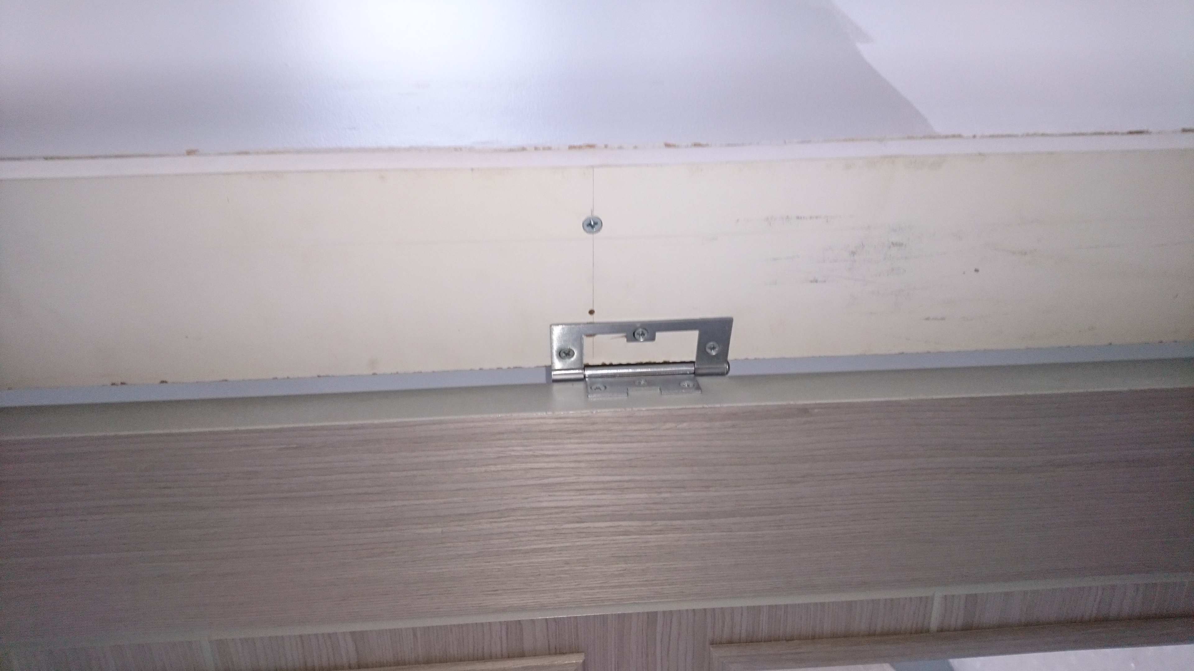

Use 25mm MDF and good screws with flush hinges and you're in DiY heaven.
Second that with flush hinges. Working great for me, save a lot of effort and looks as good.
Got any pics ...?? Really considering this now ..!

I used all flush hinges in my last house (except for the fire door) but thought you would call me a bodger if I suggested that.

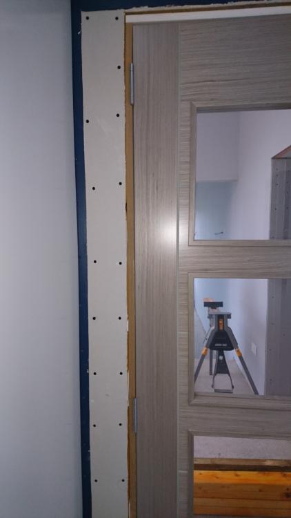

Far from being my specialist subject, but I am about to buy replacement doors plus one door set.
