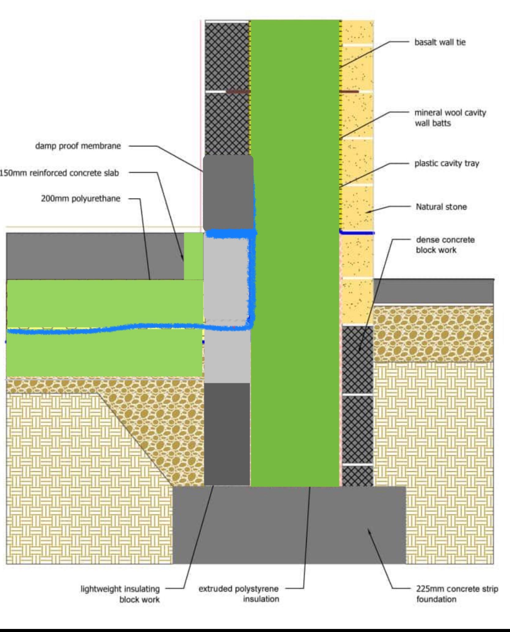

ElliotP Posted March 19 Author Share Posted March 19 2 hours ago, MR10 said: I'm assuming 'worked with before' was on a much smaller scale and detailing than required for this proposed build. Thread carefully. 2 hours ago, saveasteading said: Beware. Do you mind losing a friend? Some things will go wrong. As long as you pay extra every time it is requested ( and happily so) then it could be OK. Indeed, it was a 2 story extension, sizeable but not on the scale of this. However he's experienced, smart and enthusiastic. We dealt with plenty of curve balls together hidden sewers, build over agreement, deep footings etc. We got through it. We're not that close anyway 😁 2 hours ago, gavztheouch said: Good luck! Im builidng a 210m2 shell for hopefully a similar budget of 300k. It should be doable depeding on how much work you do yourself. Edit, I just reread your post and noticed you have a swimming pool triple garage and annex are these all inlcuded in your 300k budget. Minus the swimming pool I would budget around £600k to build the weather tight shell. That's interesting, and also slightly unnerving. When I say swimming pool - in the '£300k' (which admittedly i've pulled out of my ass), I'm nut budgeting the actual pool in that or even the hole in the ground - just the room to house it, which will be on the bottom of the 3 floors. So I'm hoping that given we're doing 3 stories will help. The garage and annexe will be combined, with the bedrooms above the garage, again looking at savings there. No idea on my m2 yet until I get some plans, but looking at yours, that's about £1400 / sqm just for the shell? Is this 2 stories? Ex VAT also assuming it's a new build? We'll need to get the plans and discuss with the builder before I have any idea where I am, there are certainly going to be tradeoffs. 41 minutes ago, joe90 said: Parse coat, cement render (even between floors) and plaster finish. Around windows and reveals was air proof foam and foaming glue (not a big fan of taped membranes). The reveal deal is also what I was concerned about, especially on a wide cavity. I had a quick research. Suggestion looks to be boarded with ply, and foamed for airtightness, and some more detailing I'm yet to understand. 2 hours ago, joe90 said: I built brick and block with 200mm cavity, wall ties were not that expensive, I also used concrete lintels internally and brick arches externally so no cold bridging. You will read many threads here where attention to detail makes a big difference especially with airtightness (don’t let trades bore random holes in your membrane whatever it is). What kind of ties did you use? Are basalt a requirement due to the bridging or is it not worth it? So overall judging by the responses here, there hasn't been a suggestion of going timber frame which I expected to be honest. So this has kind of validated my traditional wall build up a little more, even at a wider cavity. I just need to nail down the slab, roof and junctions. Link to comment Share on other sites More sharing options...

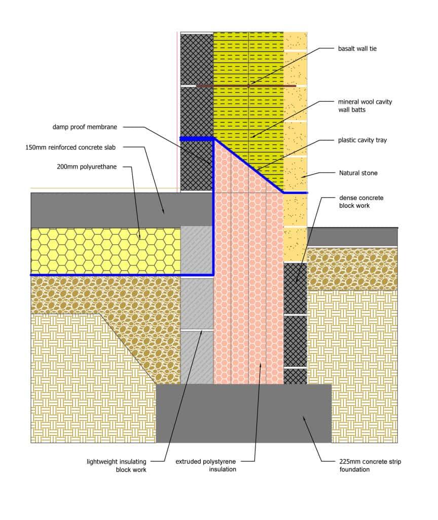

joe90 Posted March 19 Share Posted March 19 57 minutes ago, ElliotP said: What kind of ties did you use? Are basalt a requirement due to the bridging or is it not worth it? I decided the cold bridge from stainless ties was minimal (not everyone agrees) so I used them as basalt are so expensive for (what I decided) was little return. 59 minutes ago, ElliotP said: need to nail down the slab, I used strip foundations and copied this (nearly, we moved the DPC one block lower on the internal wall so as not to create a slip plane above the skirting board then added a second DPC in the outer wall above ground level, the whole house was surrounded in a French drain as the water table was high. Link to comment Share on other sites More sharing options...
Iceverge Posted March 20 Share Posted March 20 3 hours ago, joe90 said: decided the cold bridge from stainless ties was minimal (not everyone agrees) so I used them as basalt are so expensive for (what I decided) was little return. I calculated this. From memory all you need to do is widen the cavity by about 5mm to make up the difference. SS every time. Here's my alternate version of the above detail. 1. Full fill of EPS beads, right to the foundation. Allowance for mortar droppings so they won't build up to DPM level. 2. Less thermal blocks, they don't really make a difference to the heat loss below the insulation in the floor. 3. 2 x Layers of EPS 150mm insulation with the DPM in between for protection. 4. Separate DPC on outer leaf. 5. 50mm insulation at perimeter really helps the heat loss. 6. Much easier to level this concrete floor than the other design. 7. Allows for the use of cavity ties below the DPC increasing stability. 8. Simpler threshold detail for DPM. 1 Link to comment Share on other sites More sharing options...
ElliotP Posted March 20 Author Share Posted March 20 Thank you both @joe90 / @Iceverge, that's really helpful and exactly what I needed - some real world validation on the diagrams I've been staring at. Link to comment Share on other sites More sharing options...

ElliotP Posted May 2 Author Share Posted May 2 Hi all, Back with a small update on this and looking for some validation if you don't mind. I've just started off with my architect and have advised on which way i want to go with the wall (200mm, eps pumped in). He's fired back some questions/advice (he's a good man and making sure), i just wondered if you could pick your brains, I think i've got it covered but just want to be sure. Lintels - he's advised that he can't find off the shelf thermally decoupled lintels for a 200mm cavity. To me this is an easy one - we're using two separate standard lintels, EPS goes between as with the rest of the cavity - it doesn't get better than that does it? Secondly he's advised that a 150mm cavity with Celotex 140mm Cavity Wall 21 would be thermally better than EPS. I've advised that while that's true, the benefits of EPS outweighs the thermal characteristics, that being, more guarantee of a full-fill, not having to rely on builders trying to install it (probably poorly), such as leaving gaps and holes, going around wall ties etc. As well as (i'm assuming) it's a hell of a lot cheaper than PIR. To me it seems like a perfect solution of let the brickies brick, and let the insulators insulate. Everyone knows what their doing and can (hopefully) do it well. Thanks as always! 2 Link to comment Share on other sites More sharing options...
Trw144 Posted May 2 Share Posted May 2 On 20/03/2024 at 01:28, Iceverge said: I calculated this. From memory all you need to do is widen the cavity by about 5mm to make up the difference. SS every time. Here's my alternate version of the above detail. 1. Full fill of EPS beads, right to the foundation. Allowance for mortar droppings so they won't build up to DPM level. 2. Less thermal blocks, they don't really make a difference to the heat loss below the insulation in the floor. 3. 2 x Layers of EPS 150mm insulation with the DPM in between for protection. 4. Separate DPC on outer leaf. 5. 50mm insulation at perimeter really helps the heat loss. 6. Much easier to level this concrete floor than the other design. 7. Allows for the use of cavity ties below the DPC increasing stability. 8. Simpler threshold detail for DPM. What U value does this come out at? Ditto for yours @joe90 Link to comment Share on other sites More sharing options...
saveasteading Posted May 2 Share Posted May 2 1 hour ago, ElliotP said: the benefits of EPS outweighs the thermal characteristics I don't know why I am suspicious of blown eps, but I just haven't ever come across it. Maybe that's a good sign that it isn't known for problems. I think of it as a retrofit in old council flats, perhaps unfairly. What stops dampness from creeping across ball to ball? My cavity insulation of choice is cavity mineral wool batts. There is no chance of water crossing through, and it is idiot proof (No, it is idiot resistant). Also it fills the cavity and prevents brickies from dropping mortar into the cavity or parking drink cans and fag packets therein. The labour element of fitting it is tiny. Insulation level is much the same as eps I think, without checking. Link to comment Share on other sites More sharing options...
Iceverge Posted May 2 Share Posted May 2 5 minutes ago, Trw144 said: What U value does this come out at? Ditto for yours @joe90 Our 250mm cavity is 0.13ish. Don't get carried away with teplo ties or lightweight inner blocks. Much cheaper and easier to just increase the cavity width by a few mm. 6 minutes ago, saveasteading said: What stops dampness from creeping across ball to ball? Magic. Also I don't know. Some possibly theories. 1. The matrix is too dense to allow wind to blow the water through them. 2. The temperature gradient across the insulation encourages the water to go out rather than in. 3. The surface of the beads is too hydrophobic. 4. The outer side of the internal leaf is at room temperature and so is warm enough to evaporate the tiny amount of water that does make its way in there. 5. Assuming any water entering the cavity originates from the outer leaf the matrix of beads at worse can split half the water to go inwards or half to go outwards at any layer. If you keep halfing any drip from a layer of beads above and sending half inwards and half outwards only a tiny harmless amount makes to the inner leaf. 6. The matrix of beads is actually very open and most of the water flows straight down to the foundation or to a cavity tray. 18 minutes ago, saveasteading said: and it is idiot proof (No, it is idiot resistant). Nothing is idiot proof. You might outsmart them today and tomorrow and even the day after. However they'll be there, waiting in the long grass, ready to out-stupid you for the rest of time. They are remarkably persistent. 1 1 Link to comment Share on other sites More sharing options...
