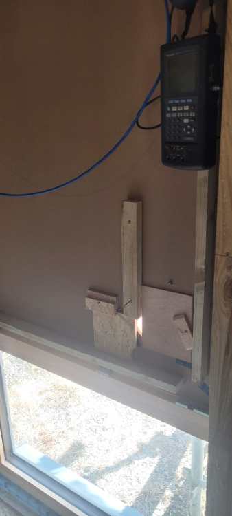

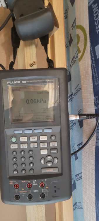

Gus Potter Posted May 28 Share Posted May 28 Ok I've posted a bit about this before.. here is something similar. In the past I used to be a Contractor who site built a lot of Tfs. Now from time to time I design them as an SE and produce the panel drawings for others to knock up on site. Yes a site built kit can be top quality and also it gives you more flexibility if you want to make design changes. I can see that for folk on BH it's very hard to compare like with like when getting prices for TF's.. If you go to folk like MBC or say Scotframe in Scotland then you need to ask: 1/ What is the price for the bare timber frame walls.. in other words the studs, sheeting, lintels and floor joists. 2/ What is the price for the roof.. could be trusses or a loose cut roof. 3/ What is the erection price. Now you have itemised and costed the structural frame. Next you have the rest.. insulation.. vapour barriers, fire stopping,plasterboard, door frames etc .. every quote you get will throw a spanner in the works so you can't compare.. it's apples with oranges... this is deliberate as the real profit( the cream) for the TF folk lies in not in the simple TF but elsewhere. They also play about with the U values and chuck in assumptions.. like say windows with a U value of X of a floor insulation of Y and things like to be "specified by the SE". You may think that your self build is a big money job.. but the thing that really keeps the TF and roof truss companies ticking over is the volume market. Your self build is just a bit of PR and a chance to make a whacking profit. Also, as they are dealing with novices (mostly self builders) they factor in the hassle factor.. which us folk that do this as a day job don't give them. As a designer I say to my Clients.. we can go to a local joiner who can do your frame on site .. but for comparison you can go to the likes of MBC. Now when we get the prices back let's weigh all this up. The outcome on a self build is usually the folk I recommend get the job doing it as a site built frame / making it in a local barn. Of course it takes a bit longer to build a kit on site but you cut out a whole load of hassle, the design can be alterered easily.. avoids delay etc. Some Clients just want that big name.. it is all just done fast.. but once I start checking that all the interfaces are compatible.. often folk wish.. hey we should have gone the whole hog and site built the frame. Also the beauty of stick building it is that you don't need to pay an unsecured amount of money up front to TF folk. You buy the timber and pay a joiner to cut and nail it together. This can be handy when borrowing money.. My gut feeling is go for a site built TF by a local joiner and then package up the insualtion all the way through to the door sets / finishes etc in different ways and get prices from the mechants big and small. Most of the TF guys that stick build for me have served part of their time with the big builders anyway so it just a case of you ordering the material and letting them get on with it.. you cut out the middle man and from time to time you may want to make a cash donation for their kids charity run. Link to comment Share on other sites More sharing options...
SBMS Posted May 29 Author Share Posted May 29 8 hours ago, Gus Potter said: Ok I've posted a bit about this before.. here is something similar. In the past I used to be a Contractor who site built a lot of Tfs. Now from time to time I design them as an SE and produce the panel drawings for others to knock up on site. Yes a site built kit can be top quality and also it gives you more flexibility if you want to make design changes. I can see that for folk on BH it's very hard to compare like with like when getting prices for TF's.. If you go to folk like MBC or say Scotframe in Scotland then you need to ask: 1/ What is the price for the bare timber frame walls.. in other words the studs, sheeting, lintels and floor joists. 2/ What is the price for the roof.. could be trusses or a loose cut roof. 3/ What is the erection price. Now you have itemised and costed the structural frame. Next you have the rest.. insulation.. vapour barriers, fire stopping,plasterboard, door frames etc .. every quote you get will throw a spanner in the works so you can't compare.. it's apples with oranges... this is deliberate as the real profit( the cream) for the TF folk lies in not in the simple TF but elsewhere. They also play about with the U values and chuck in assumptions.. like say windows with a U value of X of a floor insulation of Y and things like to be "specified by the SE". You may think that your self build is a big money job.. but the thing that really keeps the TF and roof truss companies ticking over is the volume market. Your self build is just a bit of PR and a chance to make a whacking profit. Also, as they are dealing with novices (mostly self builders) they factor in the hassle factor.. which us folk that do this as a day job don't give them. As a designer I say to my Clients.. we can go to a local joiner who can do your frame on site .. but for comparison you can go to the likes of MBC. Now when we get the prices back let's weigh all this up. The outcome on a self build is usually the folk I recommend get the job doing it as a site built frame / making it in a local barn. Of course it takes a bit longer to build a kit on site but you cut out a whole load of hassle, the design can be alterered easily.. avoids delay etc. Some Clients just want that big name.. it is all just done fast.. but once I start checking that all the interfaces are compatible.. often folk wish.. hey we should have gone the whole hog and site built the frame. Also the beauty of stick building it is that you don't need to pay an unsecured amount of money up front to TF folk. You buy the timber and pay a joiner to cut and nail it together. This can be handy when borrowing money.. My gut feeling is go for a site built TF by a local joiner and then package up the insualtion all the way through to the door sets / finishes etc in different ways and get prices from the mechants big and small. Most of the TF guys that stick build for me have served part of their time with the big builders anyway so it just a case of you ordering the material and letting them get on with it.. you cut out the middle man and from time to time you may want to make a cash donation for their kids charity run. Interesting what you say. One of the perceived benefits of off-site TF seems to be speed but all the manufacturers seem to quote 16-20 week lead times. There’s a lot of house to be built in 5 months; I suspect the total build timeframe between different methods works out the same. @Gus Potter would you choose TF (stick built on site I assume) over masonry if building your own? Link to comment Share on other sites More sharing options...
