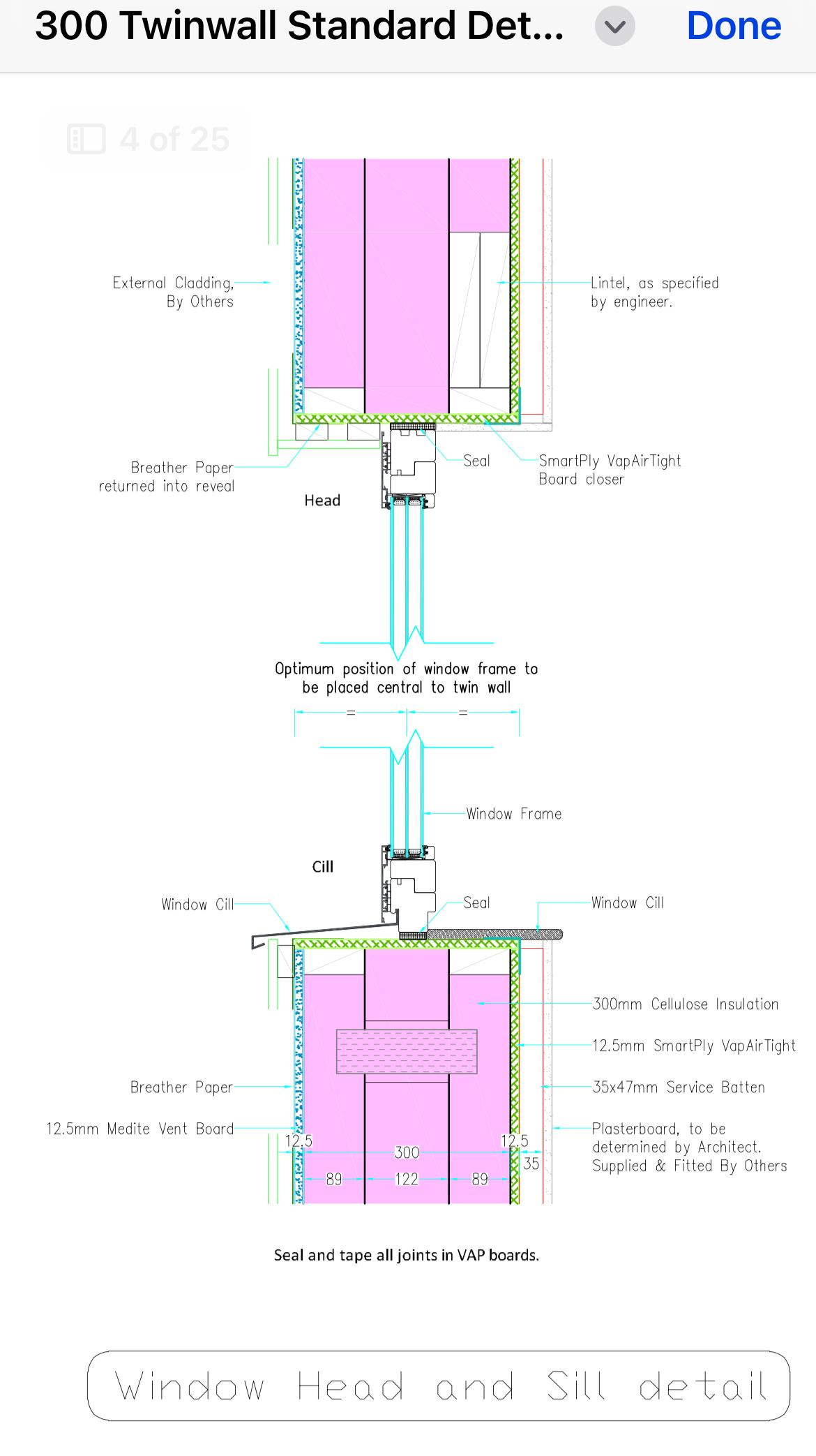

markharro Posted March 9, 2024 Posted March 9, 2024 As the heading enquires do I need to bother with this? The architect has raised it with me and there would be room to put in maybe 20mm or 30mm of insulation board but a few questions.... 1 I hate PIR and would much prefer to use something like this - https://www.ecomerchant.co.uk/interior/insulation/wood-fibre-rigid/steico-therm-wood-fibre-insulation-board.html I guess the downside is inferior thermal performance but its breathable (not sure if relevant) and as I say I hate PIR. 2 fitting I guess we would glue it to the reveal? What type of glue? 3 Then how would we put the final board finish over it? This for some windows will be 12mm ply, others 12mm fermacell; others 12mm plasterboard? the latter two would probably be flat enough to glue but the ply would need screwing I think to keep it flat. Is there any issue screwing into the airtight ply around the window? thanks
Redbeard Posted March 9, 2024 Posted March 9, 2024 Without a dwg of the structure it is difficult to be certain whether or not it is required, but if the option is there I would take it. If you are using WF why not screw it to the ply and lime-plaster it? How are the adjacent walls finished? I assume the surrounding walls do not have the finish boards on yet. With plasterboard it's easy: Use a plastic bead and simply skim the pl'bd up to the bead's 'nose' (or 'notional nose' - users of WF may know what I mean) with gypsum then 'all change' for the reveals and plaster in lime with a thin-coat reinforced basecoat and smooth lime finish. The lime plaster (at around 8-10mm) could be your airtightness layer here.

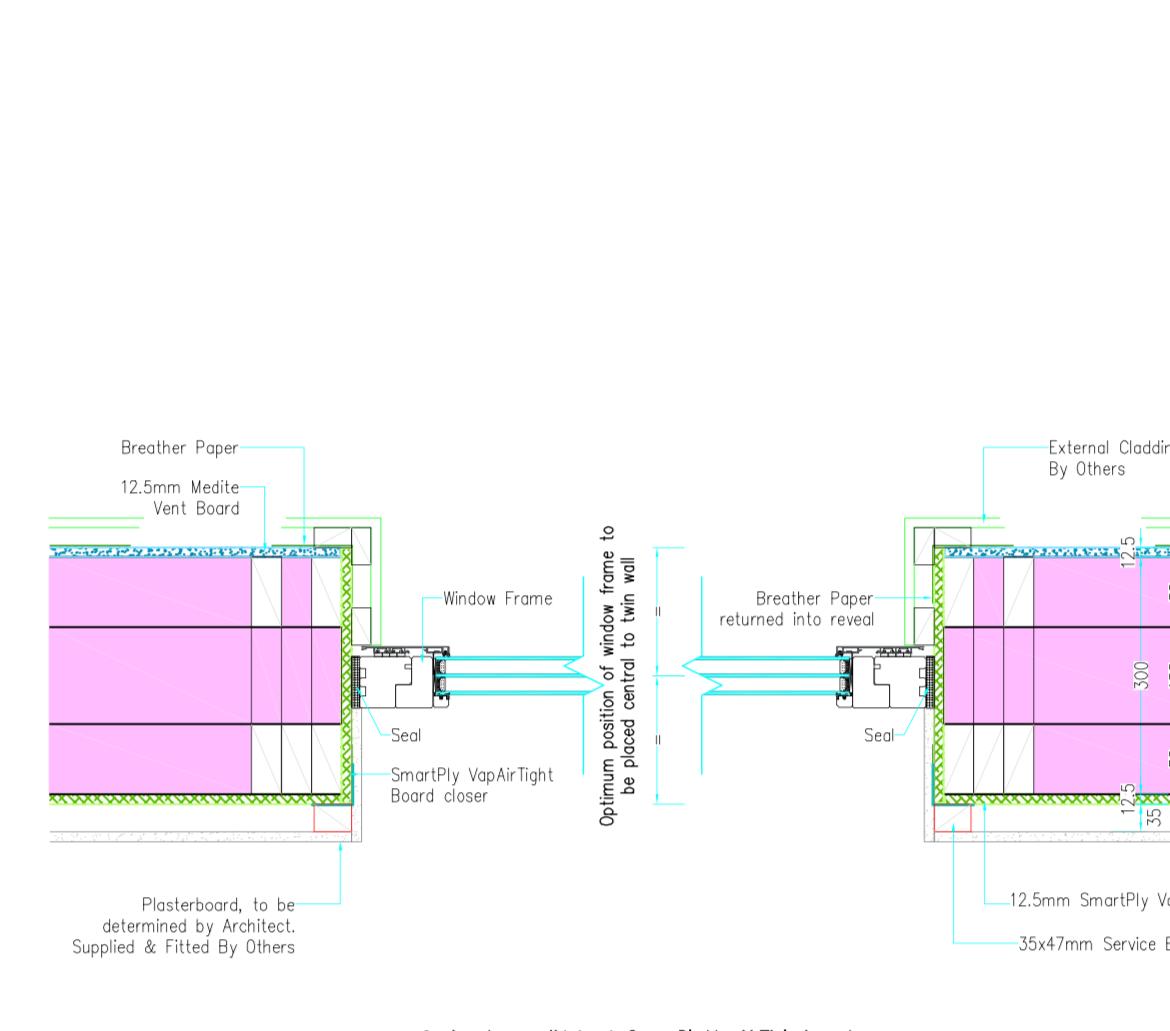

PNAmble Posted March 9, 2024 Posted March 9, 2024 (edited) My understanding is that MBC standard details don’t include insulation in the reveals (MBC details attached) We didn’t go MBC in the end due to their lack of flexibility for a difficult site. we are insulating our reveals 20mm insulation; we are doing this post our first air test (result was 0.42) just to avoid cold bridges and to create a consistent finish around the windows. This allowed the plaster board 9mm around the top and edges and a 12mm cill. Can provide our details if unclear Edited March 9, 2024 by PNAmble
Russell griffiths Posted March 9, 2024 Posted March 9, 2024 You could use, jackoboard on the reveal as you can skim straight over it. however I’m unsure if it’s needed on an mbc frame as they are very well detailed, without a drawing of your window placement it’s all a bit guesswork.
PNAmble Posted March 9, 2024 Posted March 9, 2024 Just to follow. Here is an example of our window detail. PN-D010.pdf

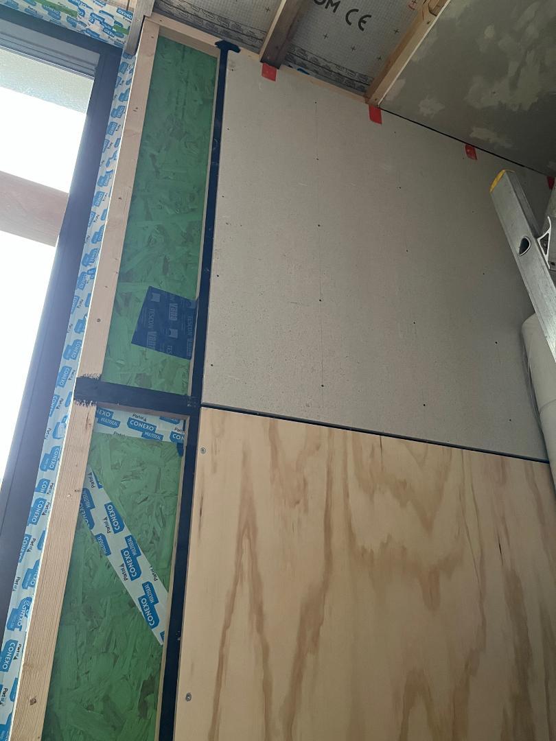

markharro Posted March 10, 2024 Author Posted March 10, 2024 Thanks @Nickfromwales yes you will see from the photo what I am doing. Ply below and fermacell above and I want to bring both into the reveal. You mention tile backerboard. I wouldnt have thought that this would have much insulative value!? Thats why I wondered about something like wood fibre?
markharro Posted March 10, 2024 Author Posted March 10, 2024 Ah I see where you are coming from now - Jackoboard has a polystyrene core! The only problem with this is that I hate polystyrene almost as much as I hate PIR and I can see potential for lots of horrible waste getting everywhere when routing the back to go over the window brackets.

Nickfromwales Posted March 10, 2024 Posted March 10, 2024 7 hours ago, markharro said: Ah I see where you are coming from now - Jackoboard has a polystyrene core! The only problem with this is that I hate polystyrene almost as much as I hate PIR and I can see potential for lots of horrible waste getting everywhere when routing the back to go over the window brackets. Get over it mate
Nickfromwales Posted March 10, 2024 Posted March 10, 2024 And have you started filling / sanding the FST for the Fermacell yet? If you gave that job to inmates, the crime rate in the UK would drop by 50% overnight. Seriously consider a plaster skim over those boards, it’s punishing work with very questionable results.

Nickfromwales Posted March 15, 2024 Posted March 15, 2024 On 10/03/2024 at 18:24, Nickfromwales said: Get over it mate Also, don’t use a router! Stanley and a chisel is fine to break out small chunks, then pop a 10mm hole in. Once fitted over the window brackets you inject foam through the 10mm hole to fill the void you left from rebating. Don’t forget to mask the window frame whilst the foam expands.
Dan F Posted March 15, 2024 Posted March 15, 2024 (edited) We have a MBC twin-wall build in the process of being certified. We uses Gaulhofer windows from @craig. At one point in the process someone insisted that we should calculate psi values for windows junctions: - Window cills without any additional insulation (but with MDF cill internally) were 0.023 W/(m·K). - Window jambs without any additional insulation were 0.040 W/(m·K) Can these numbers be improved? Yes of couse they can, but these psi values are already fairly good and you're not going to improve them by a massive amount with the additional reveal insulation. Lets say you did half the jamb psi value to 0.020W/(m·K) In our model that only saves 0.25kWh/m2.yr. (about £1.50/yr given 300m2 and ASHP heating off-peak @ COP 4). So, if it's easy/cheap do it, yes. But otherwise don't worry about it. Also, why internal only, can you not add insulation externally in reveals too? I'd use whatever material you are using for rest of internal/external walls, and then add insulation behind, rather than use a different material for reveals. Edited March 15, 2024 by Dan F 1
markharro Posted March 15, 2024 Author Posted March 15, 2024 All of £1.50 a year @Dan F! Ok if thats the case then it would seem that there would be no point at all. It seems to me then that the easiest way to deal with the reveals would simply be to pack between the metal window fasteners with some scrap 12mm Ply of OSB to take out the bumps and then glue or screw the final finish board to this. That would completely remove the need to buy more material to rout or cut out or spray foam or any of that hassle?
Dan F Posted March 15, 2024 Posted March 15, 2024 2 minutes ago, markharro said: All of £1.50 a year @Dan F! Ok if thats the case then it would seem that there would be no point at all. It seems to me then that the easiest way to deal with the reveals would simply be to pack between the metal window fasteners with some scrap 12mm Ply of OSB to take out the bumps and then glue or screw the final finish board to this. That would completely remove the need to buy more material to rout or cut out or spray foam or any of that hassle? Ensuring window are propertly installed and foam/compriband has no gaps at all and that the airtighess is all good, are all more important. If you do have void behind reveal board internally or externally then yes or course it makes sense to stuff it with insulationn or spray foam, but I wouldn't go out of your way to do much more than this.
Kelvin Posted March 15, 2024 Posted March 15, 2024 (edited) I overthought all this too. I concluded that the most important thing was making sure the windows were sealed correctly with no gaps and good airtightness. My reveals are packed with insulation but I formed the reveal wall with ply largely because I had loads of it handy. We then fixed the plasterboard to that. My windows are fitted flush with the kit. I used jackoboard at the bottom of all the full height windows onto the insulated foundation block. This was as much about giving me a good surface to tile onto as anything else as my screed didn’t flow across the reveal to the back of the window. I considered doing all of the reveals in jackoboard but didn’t as I figured the cost benefit would be pounds vs using materials I already had available to me. Edited March 15, 2024 by Kelvin
