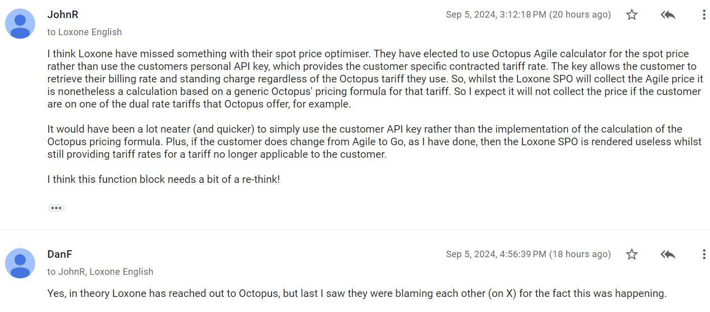

jack Posted September 6 Share Posted September 6 12 hours ago, TerryE said: I've been coding for over 50 years so the Javascript bit is easy for me, but I understand that those who aren't so IT literate will have a lot fewer options. I believe the like of Octopus and OVO are exploring some Smart Control options, but these aren't yet prime time. For anyone using Loxone, there's a module that integrates with ToU tariffs, particularly Octopus Agile: https://www.loxone.com/enen/kb/spot-price-optimizer-uk/ For example, if you predict that you need four hours of heating a day when it's cold, you can tell it to turn the heating on during the four cheapest hours. Given the flexibility of Loxone programming, I'm sure you can probably do a hell of lot more with it as well (e.g., automically turn things on when the energy price is negative). It sounds like it's a bit complicated to set up initially, and not quite perfect in terms of knowing actual prices, but hopefully they'll be able to get full integration working @Dan F: Link to comment Share on other sites More sharing options...

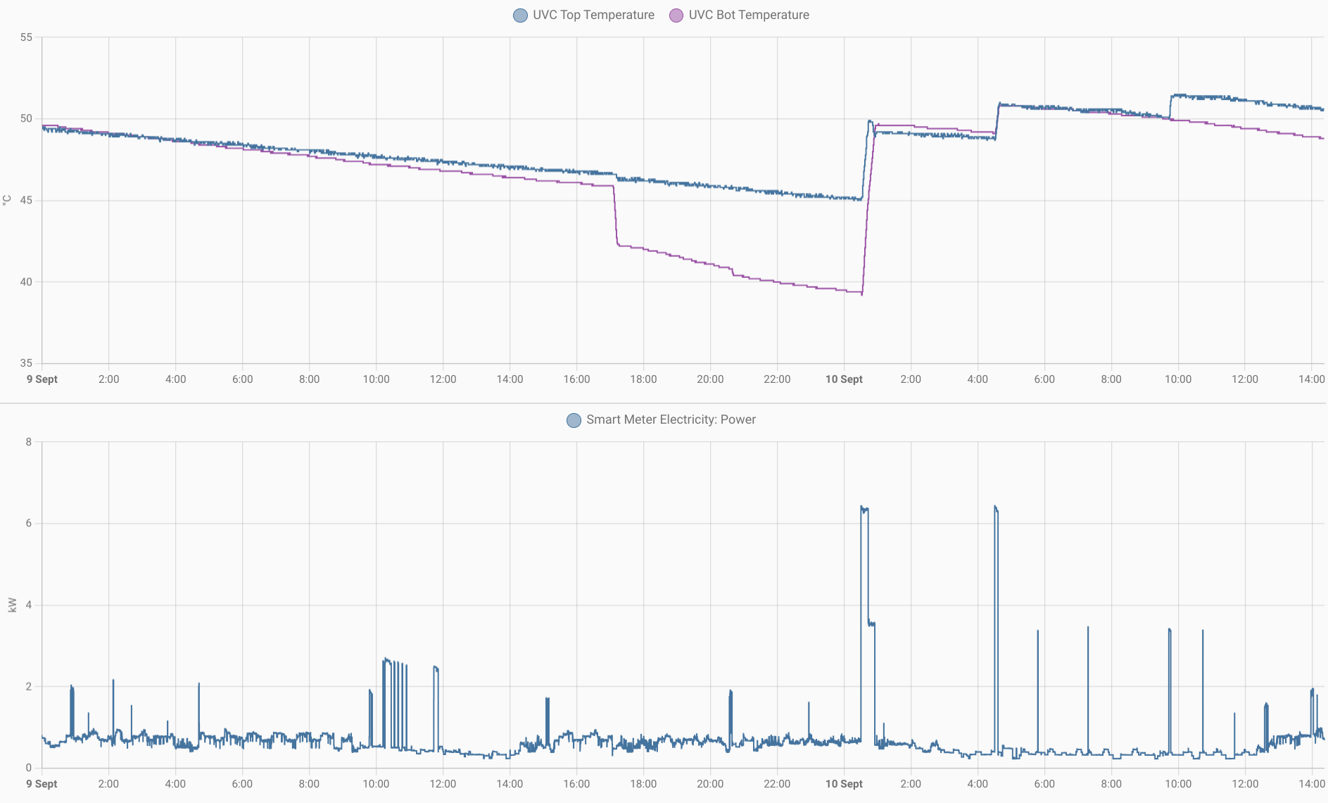

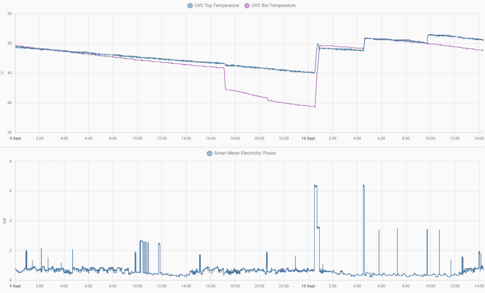

WisteriaMews Posted September 6 Share Posted September 6 @TerryE thank you for the detailed reply. I'm not as IT savvy so the above is probably a bit advanced for me! 🙂 Might be a silly question, but how.did you install the top and bottom thermometers? I'm assuming they are on the outside of the tank? Did you try to get round the insulation to install them on the metal skin of the tank? It sounds like you only use a top temperature sensor to drive the boost if needed? Being able to have a boost is my main concern, so I might be able to do something simpler than your setup. (I'm planning to be on Go / Flux rather than Agile so will have a set block of off peak that I can just use a timer for.) Link to comment Share on other sites More sharing options...
TerryE Posted September 10 Author Share Posted September 10 @WisteriaMews, sorry I am in Greece ATM, and so not checking the forum daily. The OSO UVC has an double skin: inner steel pressure vessel and our plastic or powder coated aluminium with vacuum panel insulation between. The two immersions are installed in small access panels with the wiring terminals, thermostatic switches etc. There is an internal duct channel for the 3kW flex cabling running from the bottom to up the two access panels. I used a couple of waterproof ds18b20 digital thermostats to measure temperatures. Look them up on eBay etc. The "waterproof" bit isn't important, but they are encapsulated in a ~8mm dia aluminum can that can be thermal-taped directly to the steel cylinder with a bit of foil+mineral wool insulation on top; you can get a get a range of lead lengths but 1½ or 2m is enough to take it down to the bottom channel of the cylinder, and thin enough to be run alongside the flex in the internal cabling duct. These thermometers are wired into a small IoT board, a Wemos D1 Mini which in a small ABS box about 25×40×50mm IIRC and powered using a USB lead; This ESP8266-based module uses ESPhome firmware to talk back to my home automation system over local Wifi. I use the Node-RED javascript code to track temperatures, do the heating calcs, and send the MQTT commands to power on and off the power to the two immersions. Here is a screen grab from my Home Automation system for the last 24 hours. You can see that my son had a bath or long shower at 5PM, and it scheduled top up at 00:30, 04:30 and 09:30 to bring the UNC to target 50°C because of the cheap spply pricing in those slots. (The price actually went negative in two of these slots so I actually got paid to heat the water.) The ~ 4°C cooling / day is the parasitic heat loss from the UVC which is very small compared to conventional cylinders or thermal stores. 1 Link to comment Share on other sites More sharing options...
