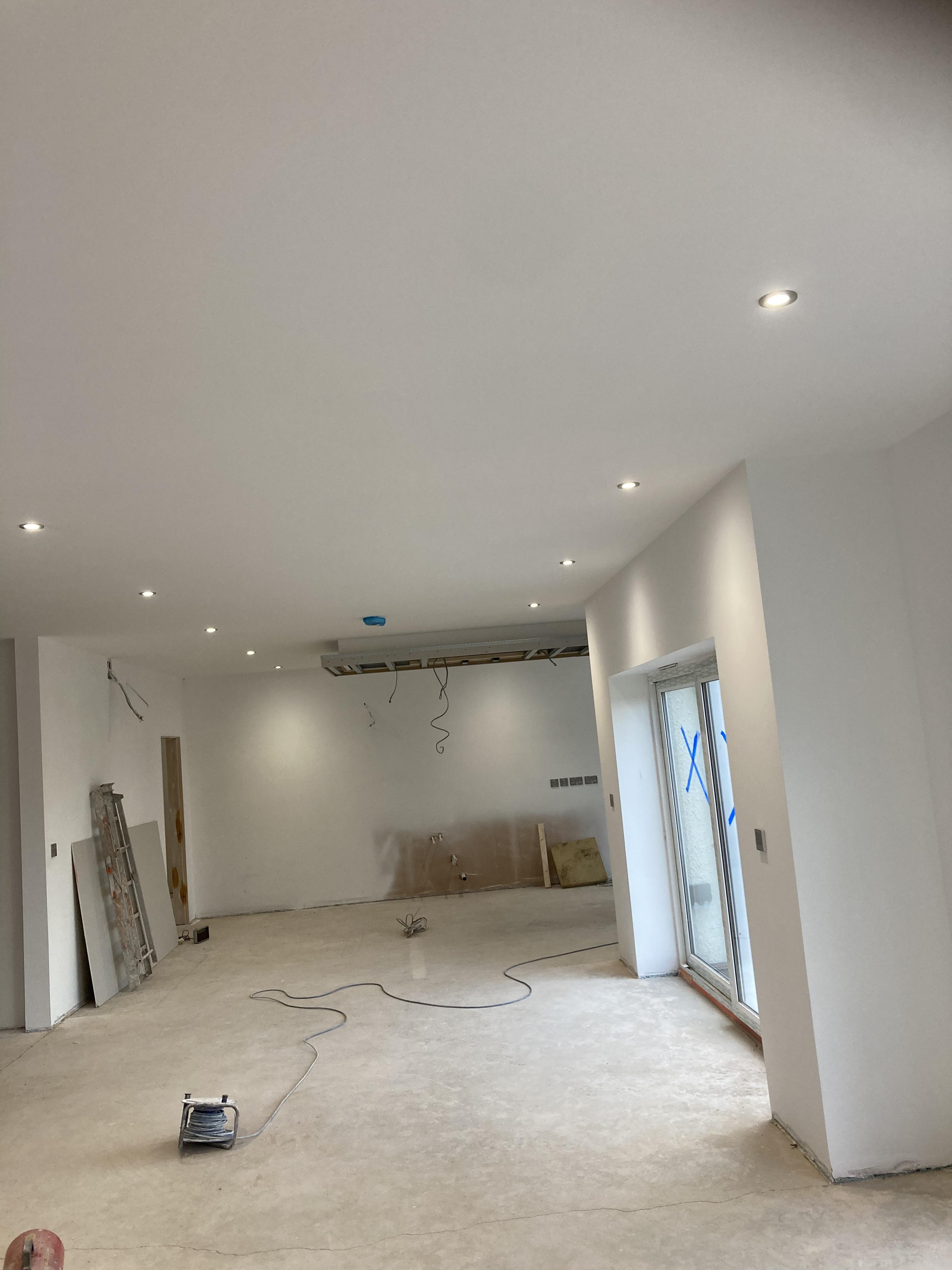

I haven't kept up with prices since I retired, and I know cost have been increasing, but I was shocked to get a quote for over £30,000 for 1st and 2nd fix in a 200m2 house.
It's a new build in the West Midlands.  Timber frame with truss joists and service voids in the walls and ceilings.  Should be easy.
The quote is only itemised on a per room basis, so I can't see in detail how the cost is made up, but to take an easy example, the downstairs WC has 3 downlights and a shaver socket.  That is priced at £475.
The quote excludes all pendant and wall-mounted lights, and is based on the most basic switches, sockets and light fittings.
To make it worse, this is from a subcontractor so the main guy will add his 15% on top.
Am I just out of touch with what things cost, or is this guy playing me?

£150/m2 for electrics sounds way over the top especially on a new build.
taking your WC as an example, if it was a stand alone job then yes it sounds about right, but as part of a full project then absolutely not, an additional 2-3 hours and a bit for materials so 1/2 or less than the £475

The price you've been quoted for that downstairs WC is slightly more than double what I paid in London. Either the person quoting has misunderstood the brief, or they are ripping you off.
I think @ProDave suggested an hour per point.
every light switch socket is a point.
so your downstairs wc would  have 5 points, 3 lights a shaver socket and I would have thought a light switch.
so 5 hours at £30-35 hour.
labour only.

It’s possible you could be paying that much if your spec was very complicated and/or included extensive garden lighting/PV/battery storage/EV charging/outbuildings etc etc.
However it appear that on the basis of your WC price you’re being had.
Day rates round here in the SE at least are around £350+vat for an experienced electrician/1 man band type. Will be a little more in London and I’d guess a bit less in the Midlands.

Say £2,000 materials and £280 /day for sums convenience, and 2 sparks working. That would be 50 days, or 10 weeks.
Half that seems about right, but add a bit if an expensive area or for a bigger company with overheads.
