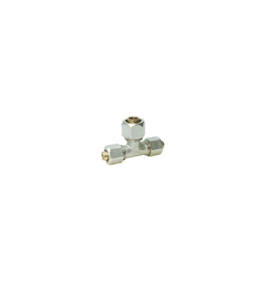

Tom Posted February 23, 2024 Author Posted February 23, 2024 Heard back from the plumber and he would prefer to use a press-fit coupler rather than the standard compression. I said I was happy to go with whatever he recommended but any reason not to use a press-fit here? He said more reliable...

Iceverge Posted February 23, 2024 Posted February 23, 2024 44 minutes ago, Tom said: Heard back from the plumber and he would prefer to use a press-fit coupler rather than the standard compression. I said I was happy to go with whatever he recommended but any reason not to use a press-fit here? He said more reliable... Yup press fit are very good. This type of compression fitting with the built in inserts are very robust too. I wouldn't use these ones which rely on olives. Would it be worth digging up the other pipes anyway and seating them lower in the screed anyway. I'd be worried with so little coverage they would fray and wear over time. 1

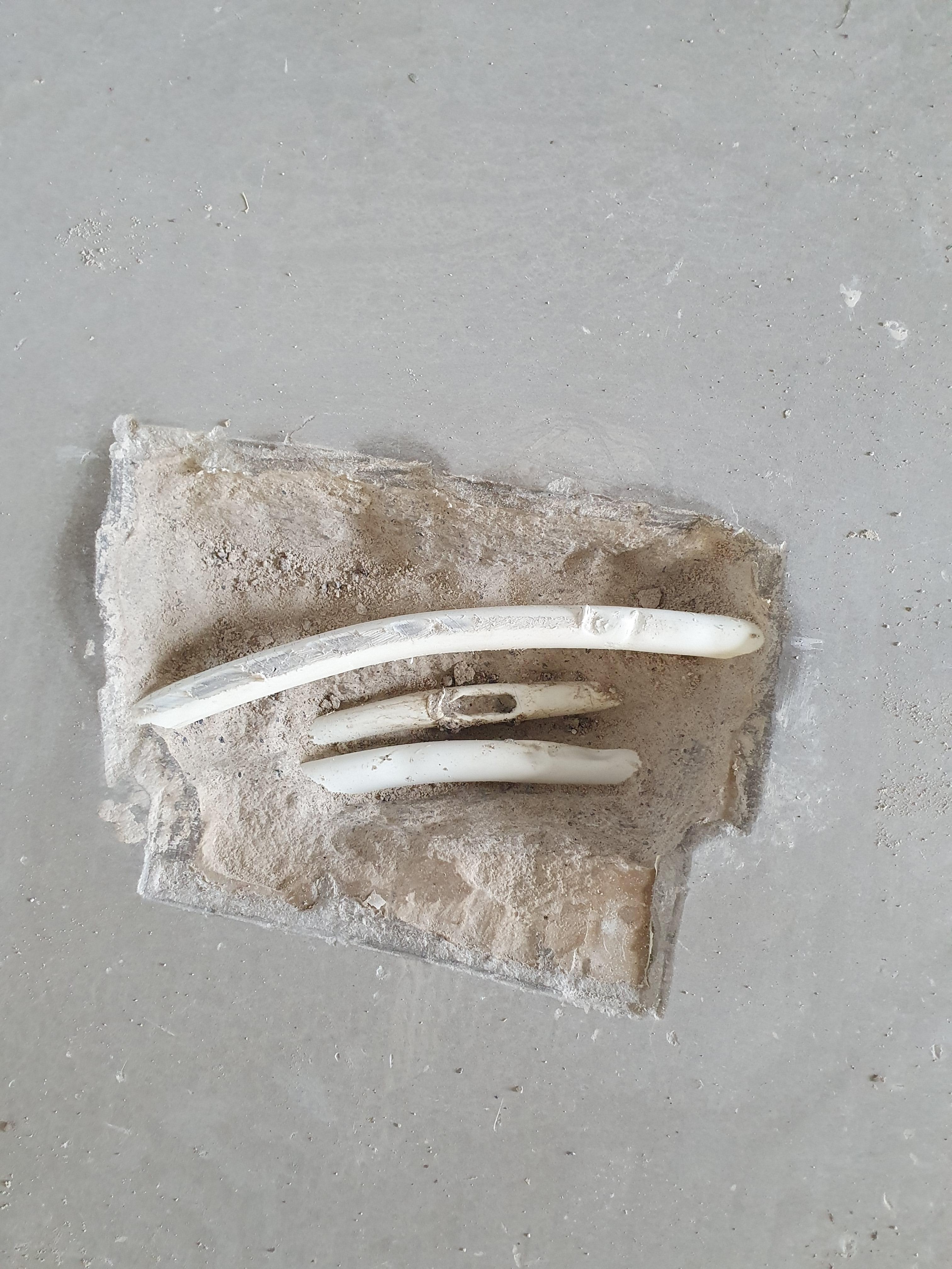

Tom Posted March 5, 2024 Author Posted March 5, 2024 So a skilled tradesman turned up in site yesterday to expose the damaged ufh pipe ready for the plumber - and promptly put a hole through another pipe. You honestly couldn't make it up 4

Nickfromwales Posted March 5, 2024 Posted March 5, 2024 6 minutes ago, Tom said: Because I had 24 pipes coming through a doorway and going up a corridor Do you have a picture of that area of pipework? Tbf, without one nobody would have expected that pipe to be there / for them to be congregated so densely. I take pics of everything before laying, saved my arse a few times. 2
Nickfromwales Posted March 5, 2024 Posted March 5, 2024 You’ll also need to dig out about 1m of trough to facilitate this repair, as the pipe needs to be apart by around 15-18mm to allow the union to be formed, then it needs to be pulled together by that 15-18mm to allow the inserts to seat into each side of the coupler. The compression ones are fine, and I don’t see how press-fit would be feasible as the tool head is very cumbersome and you’ve zero room to wiggle this all in (more so now, with the addition of casualty #2).

Tom Posted March 5, 2024 Author Posted March 5, 2024 48 minutes ago, Nickfromwales said: Do you have a picture of that area of pipework? Tbf, without one nobody would have expected that pipe to be there / for them to be congregated so densely. I take pics of everything before laying, saved my arse a few times. The plumbers were meant to be repairing this, and they were the ones who actually connected the loops to the mannifold and commissioned it all before screeding, so they should have been well aware of all the pipes. Just seems like this information didn't filter down to the genius with the lump hammer 2

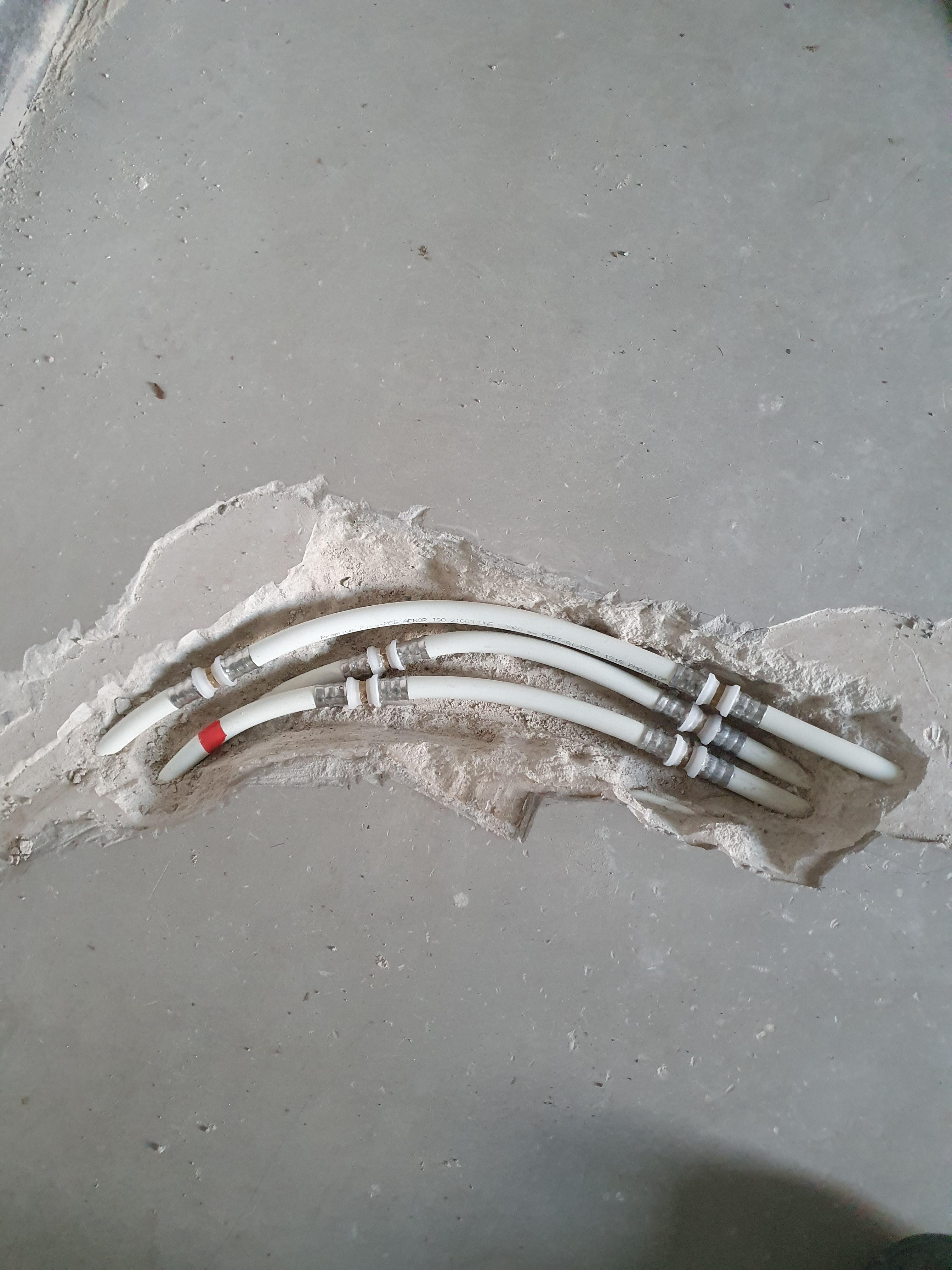

Tom Posted March 10, 2024 Author Posted March 10, 2024 Fixed end of last week, seems to be holding pressure fine

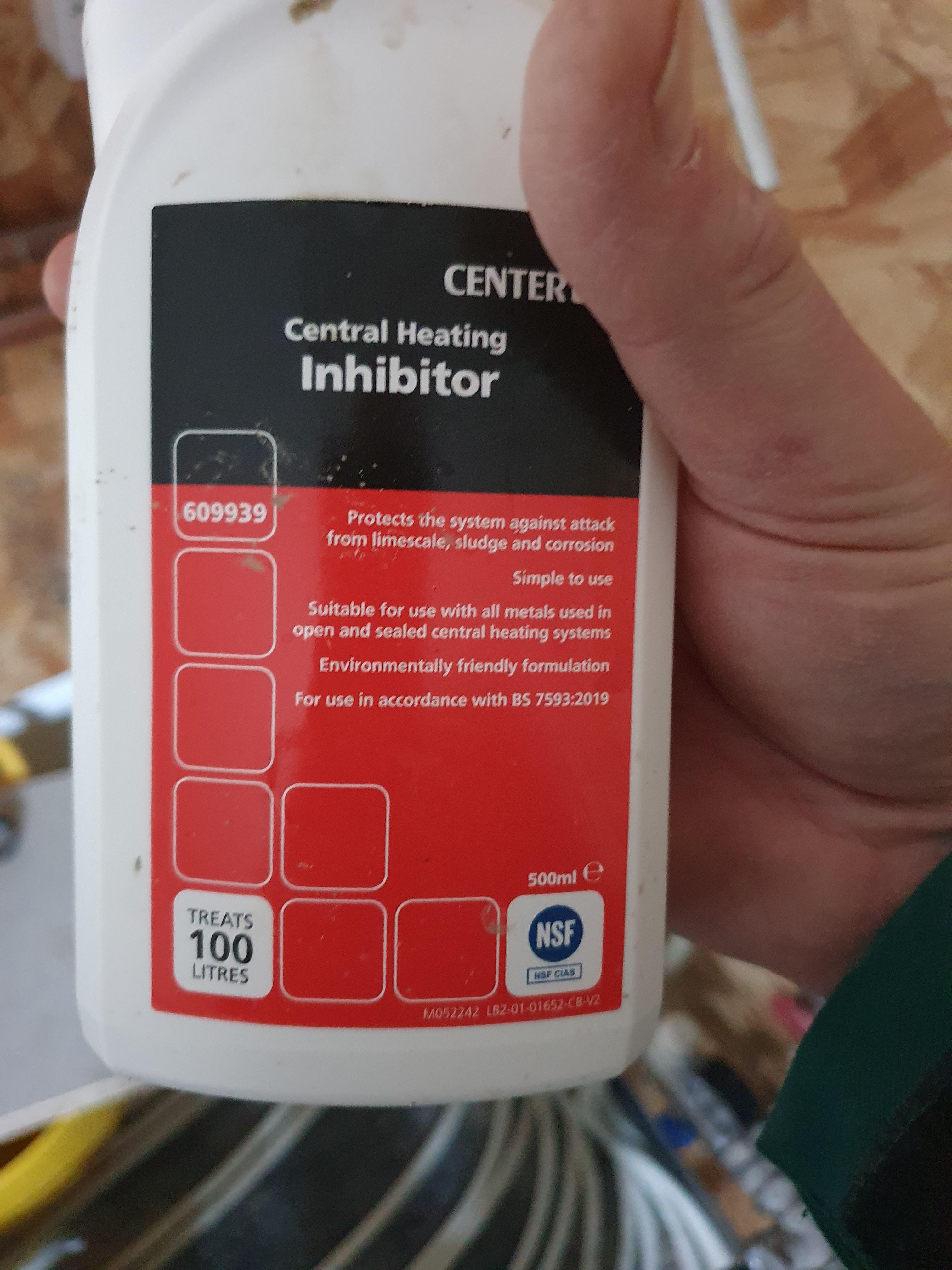

Tom Posted March 10, 2024 Author Posted March 10, 2024 (edited) In other news, I asked the plumber to put some inhibitor in when he filled the system again, as it seems he didn't bother first time around. Currently just hooked up to an electric boiler but soon will be an ASHP - is this the right stuff to use in this situation? Edited March 10, 2024 by Tom
Andehh Posted March 10, 2024 Posted March 10, 2024 Can't comment on inhibitor but pleased to hear pipes have been solved. Average house has dozens and dozens and dozens of pipe joints without issue, put this behind you now and crack on! 1
