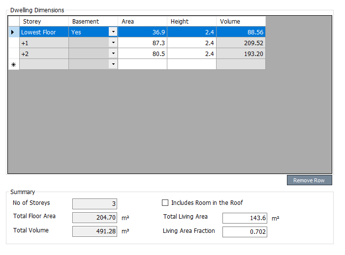

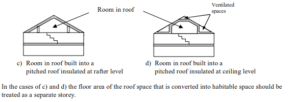

Moonshine Posted March 10, 2020 Share Posted March 10, 2020 (edited) i am resurrecting this thread as i am going through this process, very simple question to start (i couldn't find a user manual for the software). In the dimensions, i am presuming that the areas are the building footprint including external walls, and the 'total living area' is the internal habitable areas (no garages) not including external walls (though for ease including internal walls?) Also my house has a flat roof, does this mean i need to tick the room in roof box? Edit these are internal areas in regards to a flat roof, the room in roof box should be unticked Some really good guidance as below; https://www.bre.co.uk/filelibrary/SAP/2012/SAP-2012_9-92.pdf Edited March 10, 2020 by Moonshine Link to comment Share on other sites More sharing options...
Moonshine Posted March 10, 2020 Share Posted March 10, 2020 Well when i thought i was getting somewhere, i have hit a brick wall. After putting all information in i end up with a EPC of 76 and 73 (Efficiency / Impact), which is quite surprising. Also the DER is 27, where as the TER is 17, so its miles over. So the question is, what is the problem with the house design, or how i have entered the information. U-values as follows; Walls - 0.17 Floor - 0.12 Roof - 0.12 Windows - 1.4 Do these need to be reduced, or are they in the right ball park for a decent EPC? One thing i have noticed in one of the reports is that the space and water heating requirements is nearly 18,000 kWh's per year, based on a 89% efficient gas boiler for CH and water. That seems very excessive, and could it be an indication of an error of input information? Link to comment Share on other sites More sharing options...
ADLIan Posted March 10, 2020 Share Posted March 10, 2020 Difficult to tell. TER looks to be in the right ballpark for gas fired heating. Read the SAP document carefully as most answers are in there. Possible errors are air infiltration rate, treatment of linear thermal bridges, thermal mass, boiler efficiency, heating controls...I’ve not used the Stroma software for a long time but would imagine it would give an error message for anything totally out of step with SAP. Link to comment Share on other sites More sharing options...
