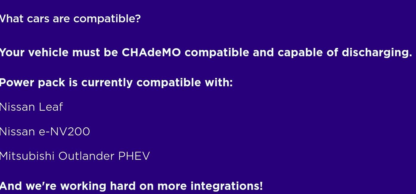

JamesPa Posted February 19 Share Posted February 19 Octopus have just launched a use your car as a battery tarrif https://octopus.energy/power-pack/ At present its more or less only the Leaf which is compatible, and you need a specific wall charger, so its pretty limited, albeit (in my view) the inevitable future. I have a feeling (but someone please correct me if Im wrong) that only CHAdeMO currently supports V2G (hence pretty much leaf only), I think the CCS and Tesla charging protocols are both promising it in 2025, although Elon musk is apparently on record as saying that V2G isn't useful (presumably because he prefers to sell powerwalls). Link to comment Share on other sites More sharing options...

JohnMo Posted February 19 Share Posted February 19 (edited) Not sure I would sign up unless the car was leased. Suspect they will be borrowing your battery power to suit the network, not your car battery life. Note the title V2G not V2H - grid not home. Edited February 19 by JohnMo 1 Link to comment Share on other sites More sharing options...
Dillsue Posted February 19 Share Posted February 19 5 hours ago, JamesPa said: At present its more or less only the Leaf which is compatible, and you need a specific wall charger, so its pretty limited, albeit (in my view) the inevitable future. I'm guessing that Octopus have a cunning plan for this but seems there's no approved Wallboxes on the ENA inverter database. I guess if you were on one of the V2G trials you could use the tariff but seems that everyone else will have to wait for Octopus to show their hand? Anyone know differently? Link to comment Share on other sites More sharing options...
Roger440 Posted February 19 Share Posted February 19 3 hours ago, JohnMo said: Not sure I would sign up unless the car was leased. Suspect they will be borrowing your battery power to suit the network, not your car battery life. Note the title V2G not V2H - grid not home. Am i missing something obvious. Why would i want to supply the grid from my car. My house , yes, can see that benefit, but the grid? Link to comment Share on other sites More sharing options...
JohnMo Posted February 19 Share Posted February 19 11 minutes ago, Roger440 said: Am i missing something obvious. Why would i want to supply the grid from my car. My house , yes, can see that benefit, but the grid? They are giving free charging - you don't stuff like that without payback. Words from the website We’ll set up your V2G charger to automatically manage your charging and discharging in the greenest way possible, so you can fill up for free. and then export back to power your neighbourhood when the grid needs help Link to comment Share on other sites More sharing options...

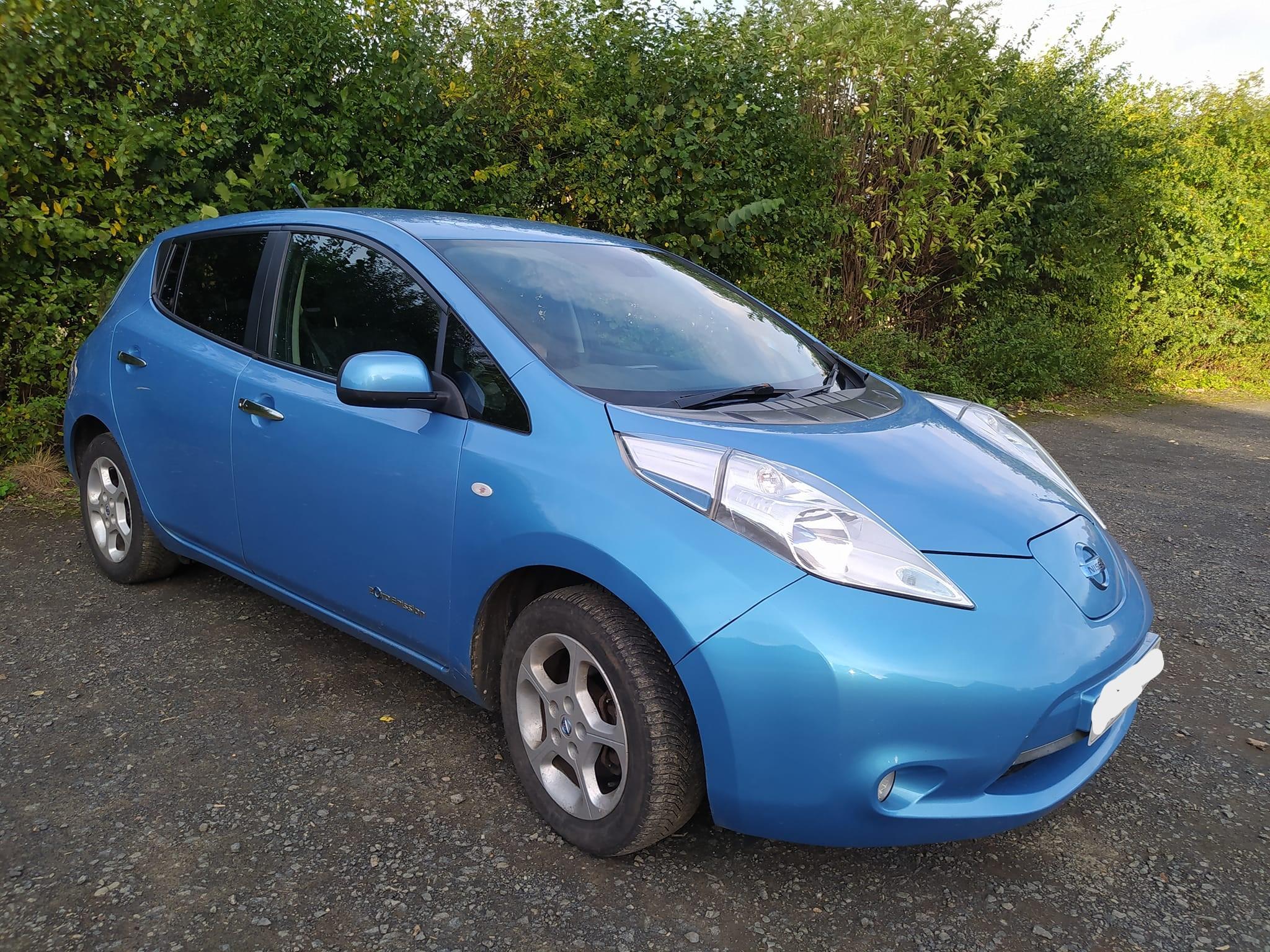

Square Feet Posted February 20 Share Posted February 20 40 minutes ago, Originaltwist said: @Andehh - any suggestions for a suitable second hand EV with the right battery please. I have a Nissan leaf for sale for £4k. It has 10 out of 12 bars of battery health remaining. It's a 2013 so a Sunderland-made one (much better than the earlier Japanese ones), has a 24 kwh battery and has high miles (168k) but has been well maintained and looked after. EV's don't have a lot of components that wear out so it's really just the brakes, suspension, tyres etc that need done every now and then and I've had all that overhauled on mine recently. It has the usual minor parking scuffs from other people's poor parking but they are genuinely minor. I can take more photos or a video if anyone wants one. Also happy to supply the reg in a message. It's a cracking wee motor, but I just really need a van. It will break my heart to sell it though, I do really love this car. It goes like a rocket and is such a pleasure to drive. I get 70-80miles range when fully charged, dependent on outside temperature. It's in Hawick in the Scottish borders, but I could meet in Carlisle or Edinburgh and take the bus back home if that worked for someone. Link to comment Share on other sites More sharing options...

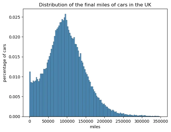

AliG Posted February 20 Share Posted February 20 13 hours ago, Dillsue said: I'm guessing that Octopus have a cunning plan for this but seems there's no approved Wallboxes on the ENA inverter database. I'm not sure the Wallbox Qasar charger they mention is still made. Wallbox have announced a V2 version but it is not available yet. The V1 charger Wallbox Qasar V2G charger was a preposterous £3950 meaning that all the benefit would be accruing to Wallbox. Looking at the cost of inverters there is no justifying this price. I was originally worried about the impact on the car battery but having looked at it further am less concerned. Car batteries are generally considered to be good for around 1000 cycles. This would be 2-300,000 miles. Of course the odd battery will suffer premature failure but in reality other parts of the car will probably give up the ghost before the battery. I found the data on the average mileage cars in the UK do before being scrapped. Very few make it past 200,000 miles. I think they will only be allowing around 10kWh per day between the battery and the grid. This is consistent with the 333kWh a month limit and the 13kWh capacity of a Tesla Powerwall for example. Assuming an average battery size of 80kWh, then you would use 45 battery cycles per year. Over 10 years of constant use this would reduce the lifespan of the battery from around 300,000 miles to 150,000 which is probably around the useful life of most cars. Further the batteries don't just stop working, it would simply increase degradation. Arguably it would be more of anise for a car with a smaller battery of around 50kWh where you could be using 70+ cycles a year. I would feel more comfortable using it with a 100kWh battery or having a import/export limit based on the size of the battery. Link to comment Share on other sites More sharing options...
markharro Posted February 20 Share Posted February 20 I'm in Edinburgh! We are looking to have an EV charger put in. I was going to get the Zappi installed but what I would really like would be to install a two-way charger to future proof things just in case we do get a car in the future that is capable of essentially being used as a home battery. Interestingly, myenergi are hinting that they may release such a charger at some point in the future - https://support.myenergi.com/hc/en-gb/articles/15196766224273-What-is-Vehicle-To-Grid-V2G-Can-we-do-it Your car has a battery with about twice the capacity of for example a Tesla powerwall but for about half the price. Is it worth buying just to station permanently in the drive as a battery for the house? What I don't understand however is whether it would be compatible with our three-phase connection and whether we would need any further kit other than the specialist charger which seems to be currently unavailable and quite expensive? 1 Link to comment Share on other sites More sharing options...
Square Feet Posted February 20 Share Posted February 20 1 minute ago, markharro said: I'm in Edinburgh! We are looking to have an EV charger put in. I was going to get the Zappi installed but what I would really like would be to install a two-way charger to future proof things just in case we do get a car in the future that is capable of essentially being used as a home battery. Interestingly, myenergi are hinting that they may release such a charger at some point in the future - https://support.myenergi.com/hc/en-gb/articles/15196766224273-What-is-Vehicle-To-Grid-V2G-Can-we-do-it Your car has a battery with about twice the capacity of for example a Tesla powerwall but for about half the price. Is it worth buying just to station permanently in the drive as a battery for the house? What I don't understand however is whether it would be compatible with our three-phase connection and whether we would need any further kit other than the specialist charger which seems to be currently unavailable and quite expensive? I honestly don't have answers for you other than to say that my car can be charged from a 3 pin plug socket and would come supplied with the cable for that. It's free road tax for EVs so keeping it as a battery that could also be driven if needed would only cost you the insurance and annual MOT. I pay roughly £1 a day for insurance. I forgot to say that mine has MOT till October. Link to comment Share on other sites More sharing options...
MortarThePoint Posted February 20 Share Posted February 20 (edited) 14 minutes ago, AliG said: Very few make it past 200,000 miles That must make me an elite motorist then 🙂 Might you void the warranty of the battery by doing this though? Edited February 20 by MortarThePoint Link to comment Share on other sites More sharing options...

AliG Posted February 20 Share Posted February 20 The original Nissan Leaf had no battery thermal management ad is well known to have many issues. It is not comparable at all to a newer EV. It was introduced in 2010, the same year as the iPhone 4. We literally just bought a Kia EV9 to replace my Model X, but I am seriously considering keeping the X as it is in excellent shape. The X is a 2017 75D with 39,000 miles on it and last time I looked showed 4% battery degradation. Other parts will give out long before the battery. Link to comment Share on other sites More sharing options...

Square Feet Posted February 20 Share Posted February 20 5 minutes ago, AliG said: The original Nissan Leaf had no battery thermal management ad is well known to have many issues. It is not comparable at all to a newer EV. It was introduced in 2010, the same year as the iPhone 4. The one I am selling is not the original model, it's the next along one that was made in Sunderland - it has the bigger boot capacity for example. Mine has mostly just been charged via one of the slower connections (ie Type 2, 7kw) as this preserves battery health. It had 11 bars of health on it when I bought it three years ago but dropped down to 10 after I took it down south in a heatwave, charging via rapid stations every hour or so along the way. If you stick to Type 2 or even the slower 3 pin plug charging then it doesn't overheat and battery degradation can be massively reduced. It really isn't the sort of car that would be your first choice for a long journey anyway. It's fantastic for shorter journeys and city or town driving though. Link to comment Share on other sites More sharing options...
