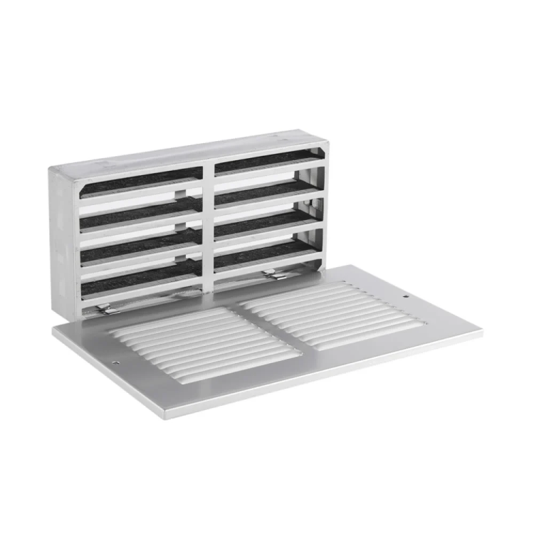

Yes, humidity sensitive vents.
https://store.beamcentralsystems.ie/products/dcv-intake-air-valves?srsltid=AfmBOopO9UvLROCeVYnm2p6C6nY5d6-wDWRsDgu2zj1VFhr6o6XYlf0p
They're not cheap though and would go a lot of the way towards a full MVHR system. You may find it acceptable with just well set passive vents. You could start there and upgrade them if you found them too drafty.

Its far from clear how these work. Google not much help either. What causes the air to move when they are open, as it says you need 20ps air pressure difference?
Posted
I think Aereco had the original design.
As I understood it it's just a strip of nylon that expands and contracts with humidity.
20Pa really isn't that much. 100000Pa is 1 Bar or about 14psi.
