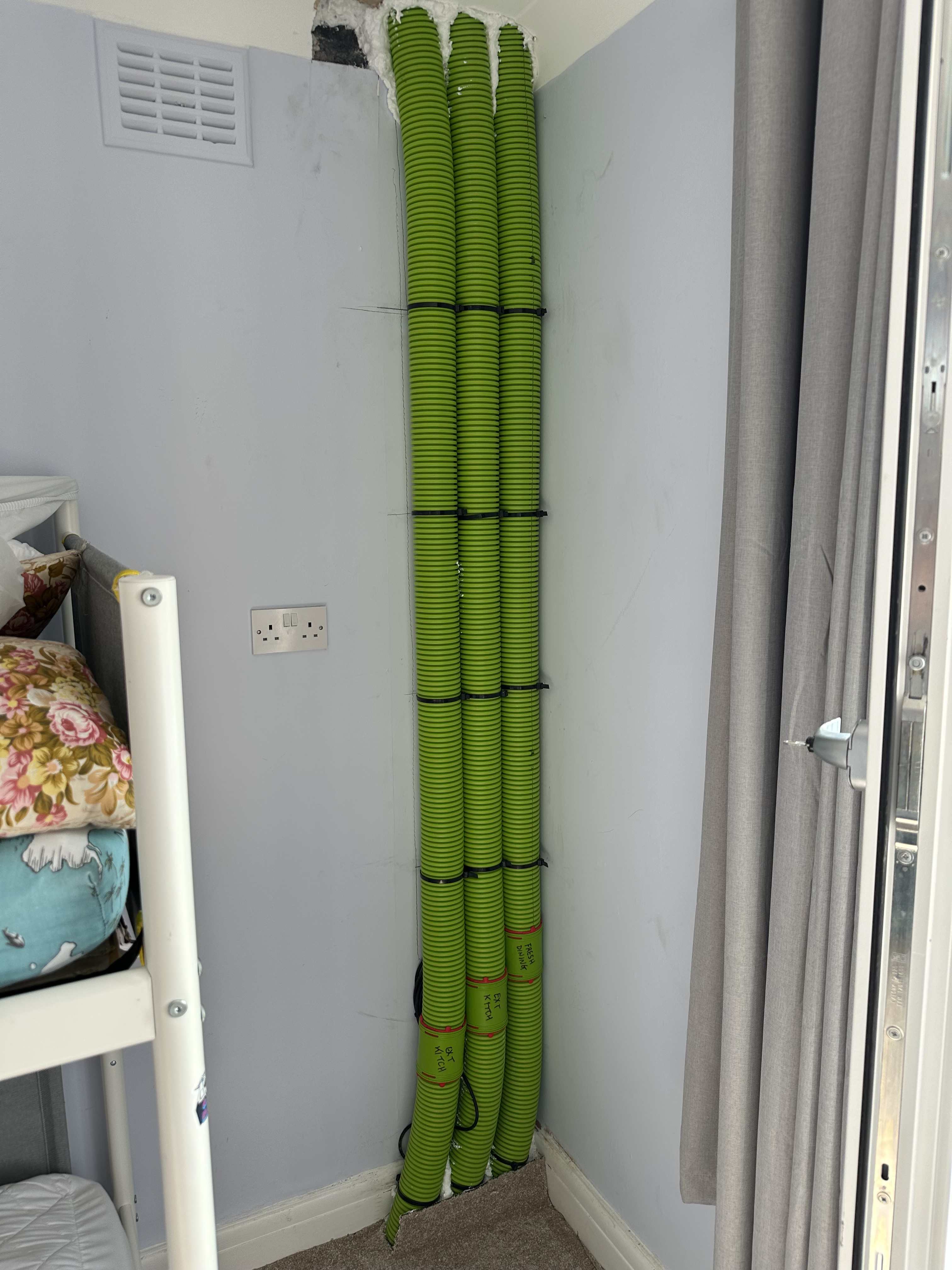

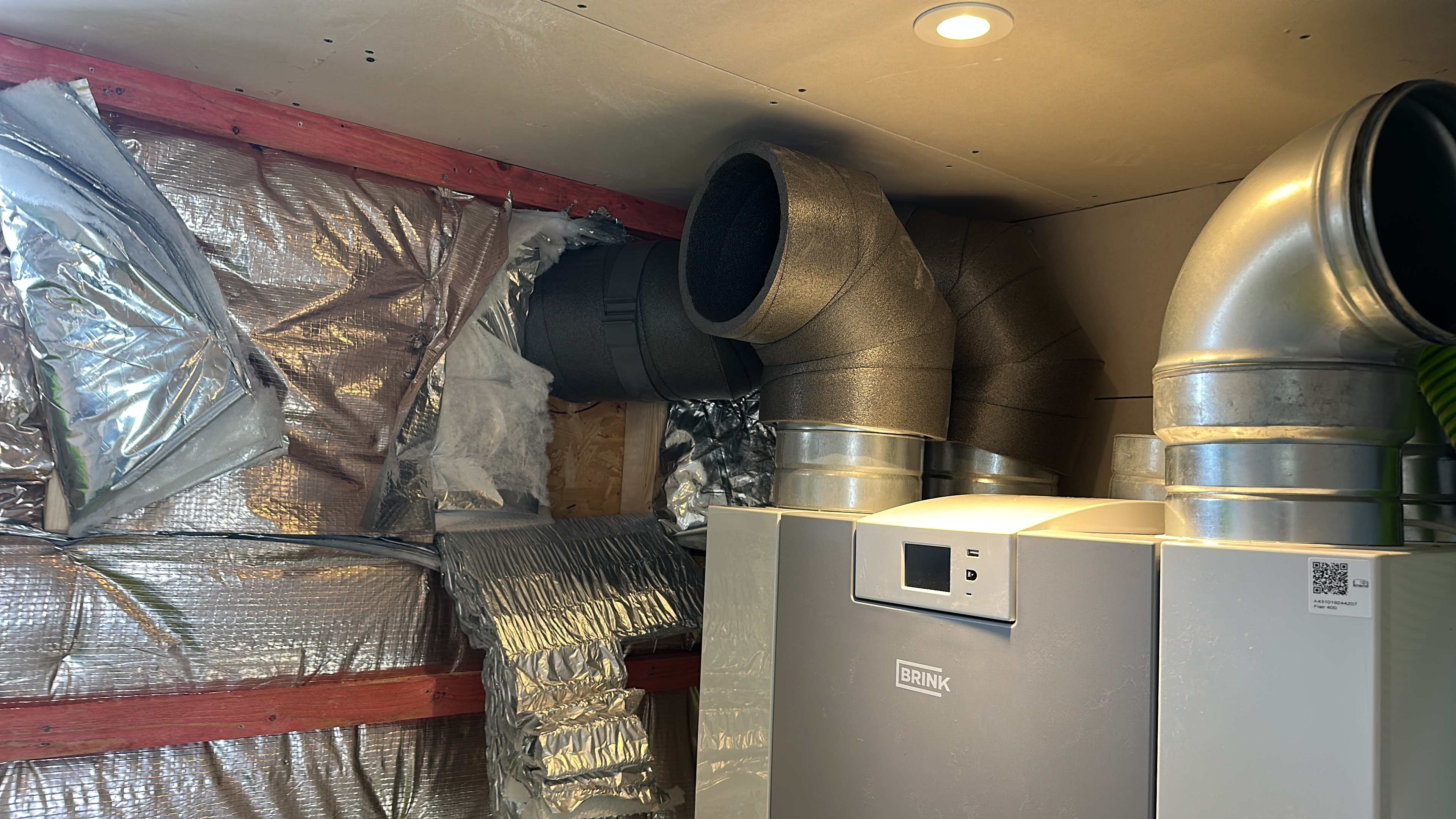

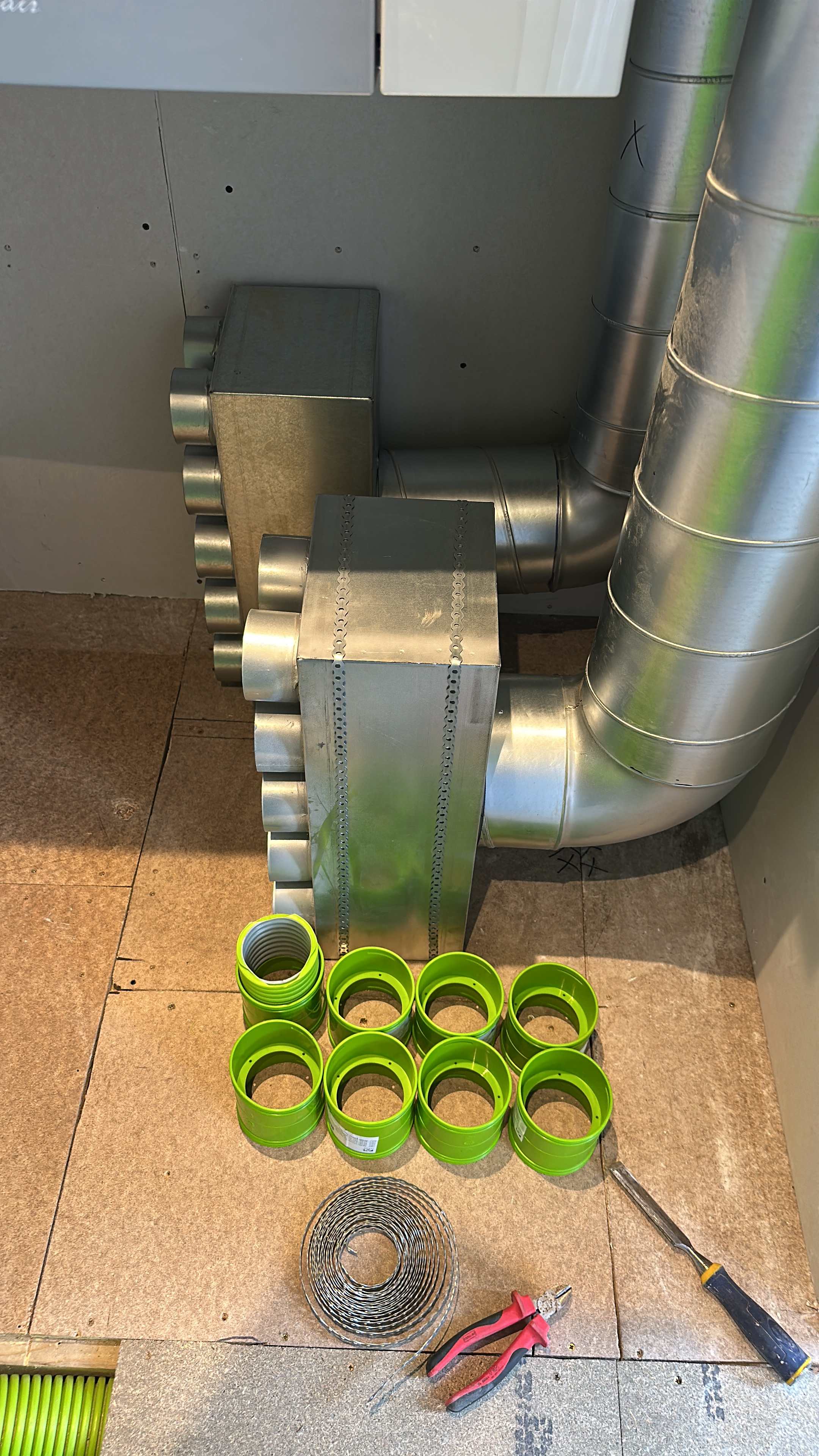

I’ve just done an MVHR retrofit in quite a large, 3-storey residential home, and you’d be surprised how you can blend a radial system in to an existing house.
You can use multiples of smaller bore ducting to replace one larger one, for eg, with duct sizes down to 50mm, 75mm (and 92mm being the largest you need for radial). No need for rigid 100/125/150 etc, as all the big bore stuff is at the unit only.
Two left ducts were fresh and exhaust to atmosphere. Right hand pair dropped under the unit via 2x acoustic attenuators to the manifolds.
And that was all in a very compact cupboard space.
This is 3x 92mm ducts, soon to be boxed, plastered and painted to allow them to blend in.

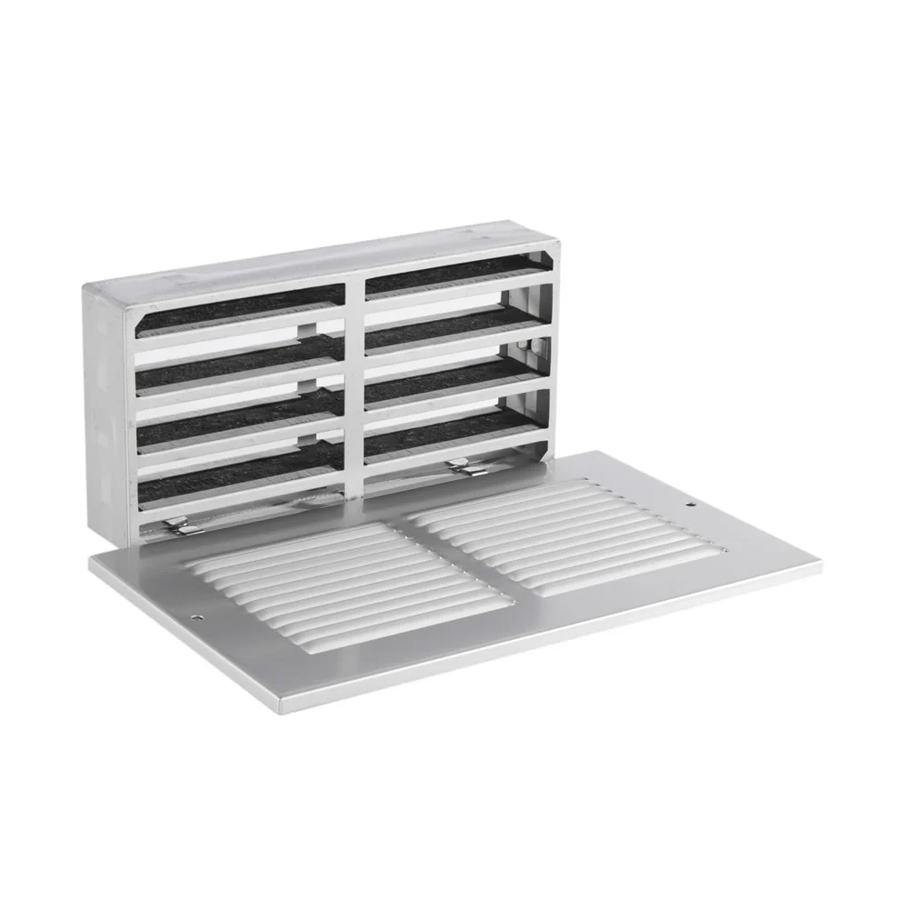

Does a transfer grille mean this sort of thing https://www.safelincs.co.uk/fire-rated-intumescent-air-transfer-grilles/?sku=PPATGFPS2251&ppcGeneral&gad_source=1&gad_campaignid=21280659513&gclid=Cj0KCQiAo4TKBhDRARIsAGW29bdZzDnAdMJjg83hpn7cdlyOtgRQ9K3vlmmxJCyJPmaZLv_X3QbmujYaAun1EALw_wcB where I can only get a duct to one room? Duct to that room, then transfer grille into the next room to allow airflow? Sounds like the principle of a cascade system, which I think could suit me well.
