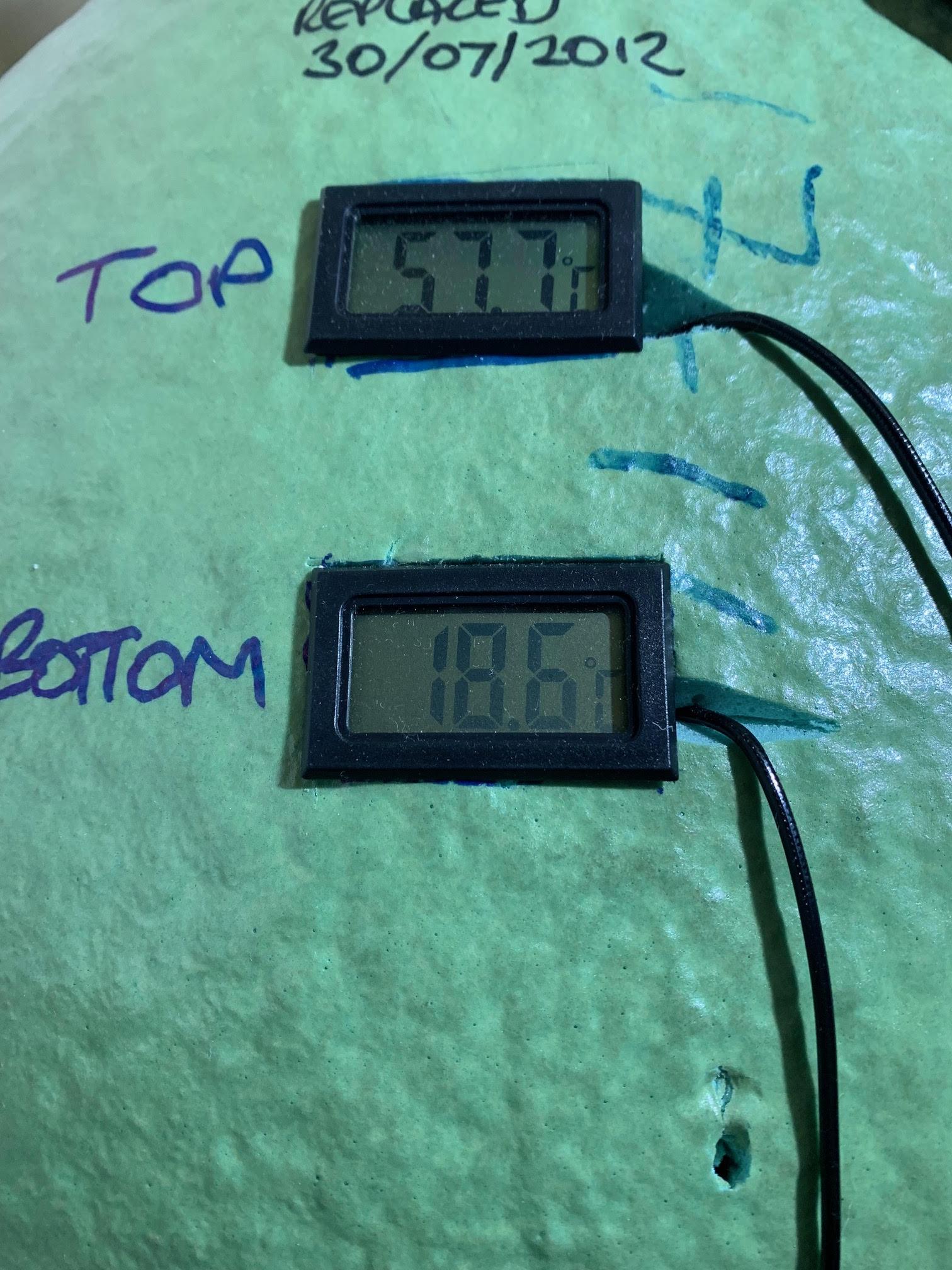

Adsibob Posted January 27 Author Share Posted January 27 2 hours ago, marshian said: Forgot to add a Picture So just to understand this a bit better: what is the typical stratification of a cylinder? Is it linear such that the 39 degree delta between the top and the bottom here means that if the cylinder is 156cm tall (39 x4) every 4cm there is a change in temperature of 1 degree? Link to comment Share on other sites More sharing options...

SteamyTea Posted January 27 Share Posted January 27 1 hour ago, Adsibob said: So just to understand this a bit better: what is the typical stratification of a cylinder? Is it linear such that the 39 degree delta between the top and the bottom here means that if the cylinder is 156cm tall (39 x4) every 4cm there is a change in temperature of 1 degree? Not really, it is much more complicated than that as it is not really stratification at all. There is a mean temperature gradient, but that changes with the mean temperature. Why I suggested that you look for another solution. Link to comment Share on other sites More sharing options...
ProDave Posted January 27 Share Posted January 27 1 hour ago, Adsibob said: So just to understand this a bit better: what is the typical stratification of a cylinder? Is it linear such that the 39 degree delta between the top and the bottom here means that if the cylinder is 156cm tall (39 x4) every 4cm there is a change in temperature of 1 degree? Normally an UVC will start off full of hot water heated to the set temperature. As it is used, a hot / cold transition moves up the tank. If no more heat was added, you would get almost the same temperature of water coming out of the taps right up to the point where the hot / cold transition reaches the top of the tank and the water would suddenly go very cold. If the cylinder thermostat was say half way up, then at the point the transition reaches the thermostat the boiler would fire up. At that point the heat input to the tank would stir up convection within the tank and continue to do so while it is heating. With the heat source being a big boiler, it can probably re heat the tank as fast as you can empty it. Link to comment Share on other sites More sharing options...

Alan Ambrose Posted January 27 Share Posted January 27 (edited) >>> Normally an UVC will start off full of hot water heated to the set temperature. As it is used, a hot / cold transition moves up the tank. If no more heat was added, you would get almost the same temperature of water coming out of the taps right up to the point where the hot / cold transition reaches the top of the tank and the water would suddenly go very cold. If the cylinder thermostat was say half way up, then at the point the transition reaches the thermostat the boiler would fire up. At that point the heat input to the tank would stir up convection within the tank and continue to do so while it is heating. With the heat source being a big boiler, it can probably re heat the tank as fast as you can empty it. <<< Yeah, the behaviour of DW cylinders is quite a complicated business if you think about it - stratification / mixing / heat loss / statistical usage patterns etc. The simpler way would be no storage tank and use a heat source powerful enough to heat the water to the required temperature instantaneously at the required flow rate. @SteamyTea will be along shortly to tell us what instantaneous heat power is required for a typical shower . That system would be much more efficient because you would only heat the water you need / there would be no 'waste' heat when the cylinder cools while it's waiting for your next shower / there would be no need to heat up more water than you need not knowing how long your shower was going to be. However, the instantaneous power requirement is more than most heat sources can provide - hence the tank. The storage tank lets a lower power heat source heat over a longer period and then the heated water is delivered in a much shorter period. Sort of heat-based impedance matching if you get my drift. Given that the tank thing is all a bit of a fudge anyway, why not just heat a bit longer until you don't run out of hot water ever. Yeah, there's going to be some waste, but using a cylinder in the usual way implies some waste anyway. The other system nobody uses would be to have one or more vented tanks which didn't refill with cold water until the start of a new heating cycle had been determined, say 3 am? The control / safety system might be more complicated though. A bit like a more modern - 'heat the kettle on the stove and fill the bath in the parlour system' Edited January 27 by Alan Ambrose Link to comment Share on other sites More sharing options...

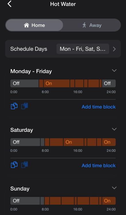

Adsibob Posted January 27 Author Share Posted January 27 (edited) 57 minutes ago, SimonD said: This is where I'd like to know the set up of the system, the controls being used and how it's wired up because on some systems, like the Evohome system I have installed, I have full control of this so I can set a differential, pump over-run time, minimum run time etc., and why using something like the Viessmann cylinder stat wired directly to the boiler on a 4 pipe system is designed to make this approach as efficient as it should be. Hence why I'm confused about how the PDHW has been approached in this installation, but also why the system isn't being used as it is suggested it's been installed. @Adsibob? I’m not really sure the answer to this. I didn’t realise boiler setups were that complicated. My boiler and heating system and tank was installed by an electrician and a gas engineer. I d did some research and came to a few conclusions like: 1) Veissman together with a Veissman low loss header would prevent the need for a buffer tank and would not short cycle. 2) 300L cylinder should just about meet our needs 3) PIR activated secondary loop would be beneficial. 4) I like tado. 5) different pipe diameters for different applications, eg 22mm for bath, 15mm for shower, 10mm for basins. So to the extent there was any design, that was it. I conveyed that info to the gas engineer/plumber, asked him if he was Veissman registered, he said he could get approved and registered. A couple of months later he showed me the Veissman certificate for his registration, and after that I let him get on and do the work. My electrician asked me how I wanted to control my heating and HW and I said tado and he did the rest, choosing which wiring systems etc.. It all works, and my bills have been pretty low considering it’s a 5 bed house with fairly high HW use and probably would only score a C, maybe a B, on a EPC. I have a tado controller wired to the boiler, and that tells the boiler to heat the cylinder, save that it is overridden by the cylinder’s stat when the cylinder stat decides it’s reached temp. With retrospect, I should have got the system properly designed, as then proper insulation for the secondary return/loop pipe would have been specified, and we might have a more sophisticated HW heating system but given everything is working well, I’m not sure how much I would have saved in the long wrong by paying for a professional design. Edited January 27 by Adsibob Link to comment Share on other sites More sharing options...

marshian Posted January 27 Share Posted January 27 4 hours ago, Adsibob said: So just to understand this a bit better: what is the typical stratification of a cylinder? Is it linear such that the 39 degree delta between the top and the bottom here means that if the cylinder is 156cm tall (39 x4) every 4cm there is a change in temperature of 1 degree? No - that was bath night for SWMBO That was after the bath had been poured The tank I have stratifies quite well - there was about 40 L left in the tank at 57.7 Deg - there will be a slight zone where the temp gratuates but then everything below that was at 18.6 Deg (cold water tank temp) I've just had to manually do my DHWP as our water usage today was higher than normal (SWMBO left the bath tap on a very slow trickle after the morning cleaning session - ooops) it took the tank down to 22 deg top and bottom 36 mins with the boiler shoving between 10 to 12kW in thro the 3 kW coil and the top is at 51 and the bottom 50. Best delta I get heating water is 16 Deg due to the coil being a std 3kW one Link to comment Share on other sites More sharing options...
SimonD Posted January 27 Share Posted January 27 4 hours ago, Adsibob said: I have a tado controller wired to the boiler, With your tado, where did you get it? And when you bought it did you ensure that it was definitely a version with digital control possible of the boiler? Link to comment Share on other sites More sharing options...
Adsibob Posted January 28 Author Share Posted January 28 2 hours ago, SimonD said: With your tado, where did you get it? And when you bought it did you ensure that it was definitely a version with digital control possible of the boiler? I got it from the Tado store. There isn’t much data on its exact specs online, but with all the cable ports it comes with (see second picture, here) I would be surprised if it’s missing much functionality. Link to comment Share on other sites More sharing options...
SimonD Posted January 28 Share Posted January 28 9 hours ago, Adsibob said: I got it from the Tado store. There isn’t much data on its exact specs online, but with all the cable ports it comes with (see second picture, here) I would be surprised if it’s missing much functionality. Are you aware that this product does not do load compensation with the boiler, i.e. manage flow temperatures to get full benefit of your modulating boiler? It only does relay switching for both hot water and central heating? I'm a bit of a critic of Tado given that in the UK and also from their professional installer's shop that ships from Germany, you can't get a controller that does digital control and modulation for system/heat only boilers (S & Y plan), only for the combi. And if you want modulation via Opentherm E-bus or Km-bus for a combi you pay a hefty premium, £200 versus about £89. I now always spec other controllers because of this. For single zones, as a contoller, the Honeywell T6R-HW is far better because Opentherm is supplied as standard, as is the process of setup compared to the Tado (IMHO). If you want full efficiencies from your boiler and heating setup, I'd recommend you change your controllers. Your heating engineer really should have told you this given the importance you put on modulation. Link to comment Share on other sites More sharing options...
